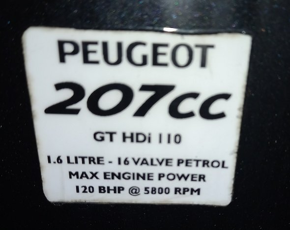

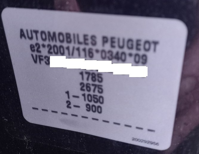

Where can I find the RPO number on my 207cc?
ServiceBox says it should be on a sticker on the left door but there's no sticker.
There is a sticker in the left door jamb. (see attached)
VIN is VF3**************[VIN obfuscated, can be read by forum staff]

Which is where? Those images I've posted are the only two door stickers and there's nothing other than 'DIESEL' under the fuel cap.

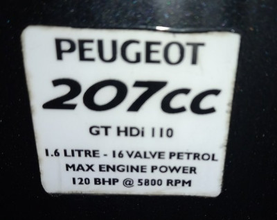

Thanks Richard. Did you extract that from the VIN?
I'm guessing I may be missing a sticker.
The drivers door sticker is totally weird. Claiming it's simultaneously a 110 HDi (which it is) and a 120 petrol...

Re: 207cc RPO number
The sticker with the VIN on it shows the car weights.
1785 is the car gross weight (max laden)
2675 is the car max train weight if pulling a trailer so it can tow a trailer up to 2675 - 1785 = 890 kg. In the handbook it may say there can be some load transfer which means a heavier trailer could be towed if the car max weight is lower than 1785 kg but the total train weight must not be more than 2675 kg.
1050 is the max front axle weight
900 is the max rear axle weight.
The other sticker might be an aftermarket one put on by a previous owner.

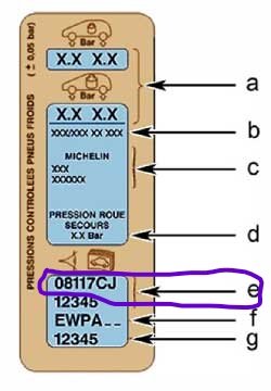

Its on the tyre pressure label (at e in the pic below) The letters at the end are the factory code where it was built.
