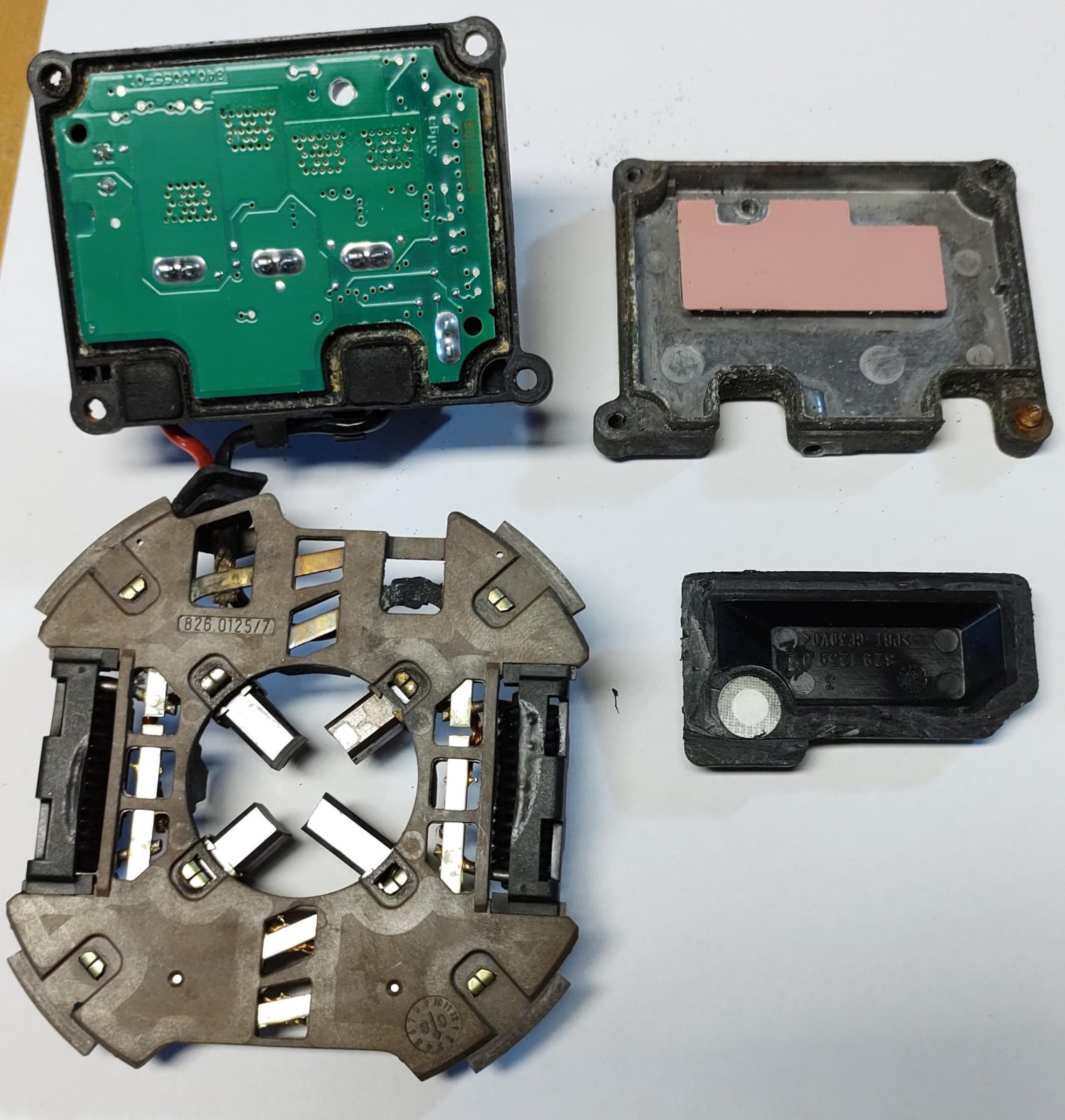

I have a problem with the hydraulic pump. It starts with an error about the suspension.

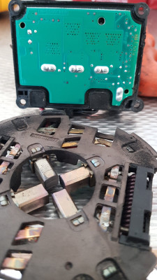

Now i find out, that the problem is in the little black box in front of the pump. I need to open this one, because there is a connection not reliable inside.
I removed the four screws but something is holding the cap.
I put a picture in here, what seems the detail where it's holding it behind.
So how to open this?

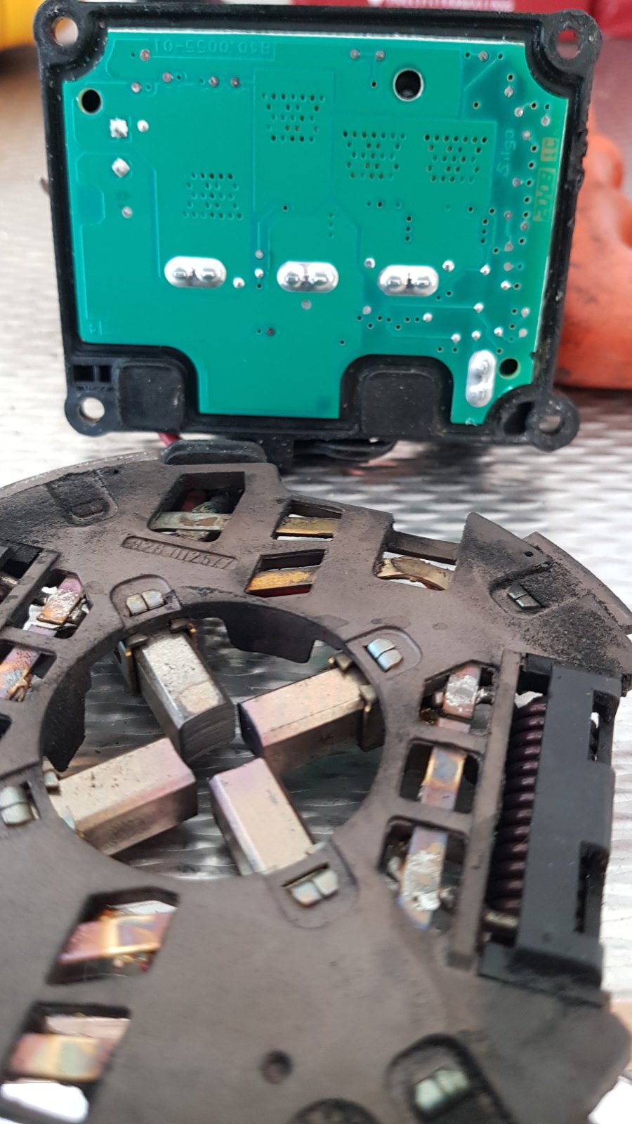

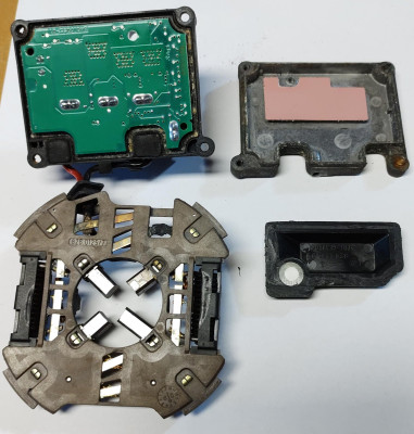

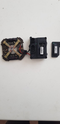

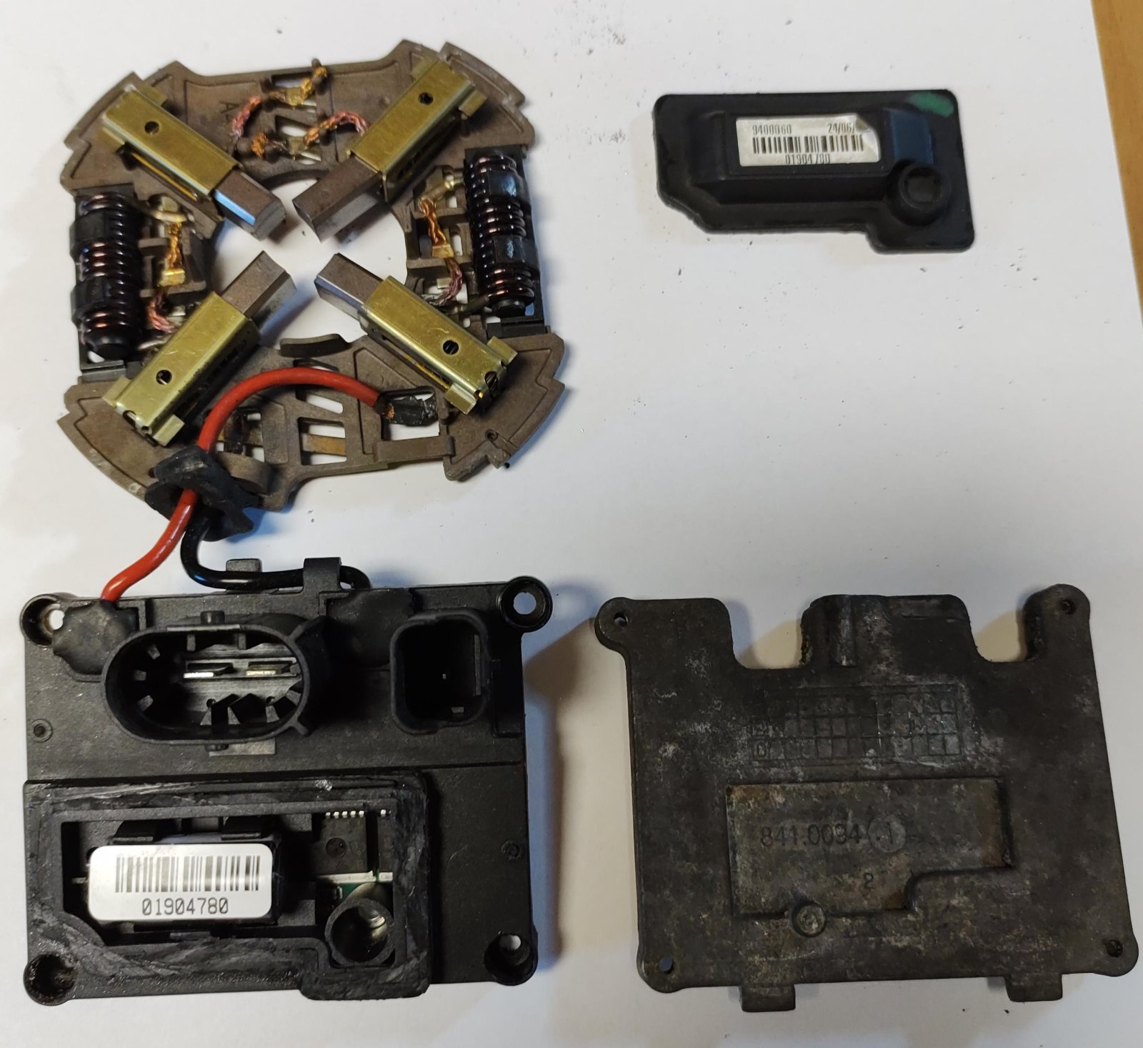

I managed to open it!
You have to remove the tiny black cap, it's glued.
Then you see a tiny torx screw and if you remove the 4 torx on the corner then you can open it.

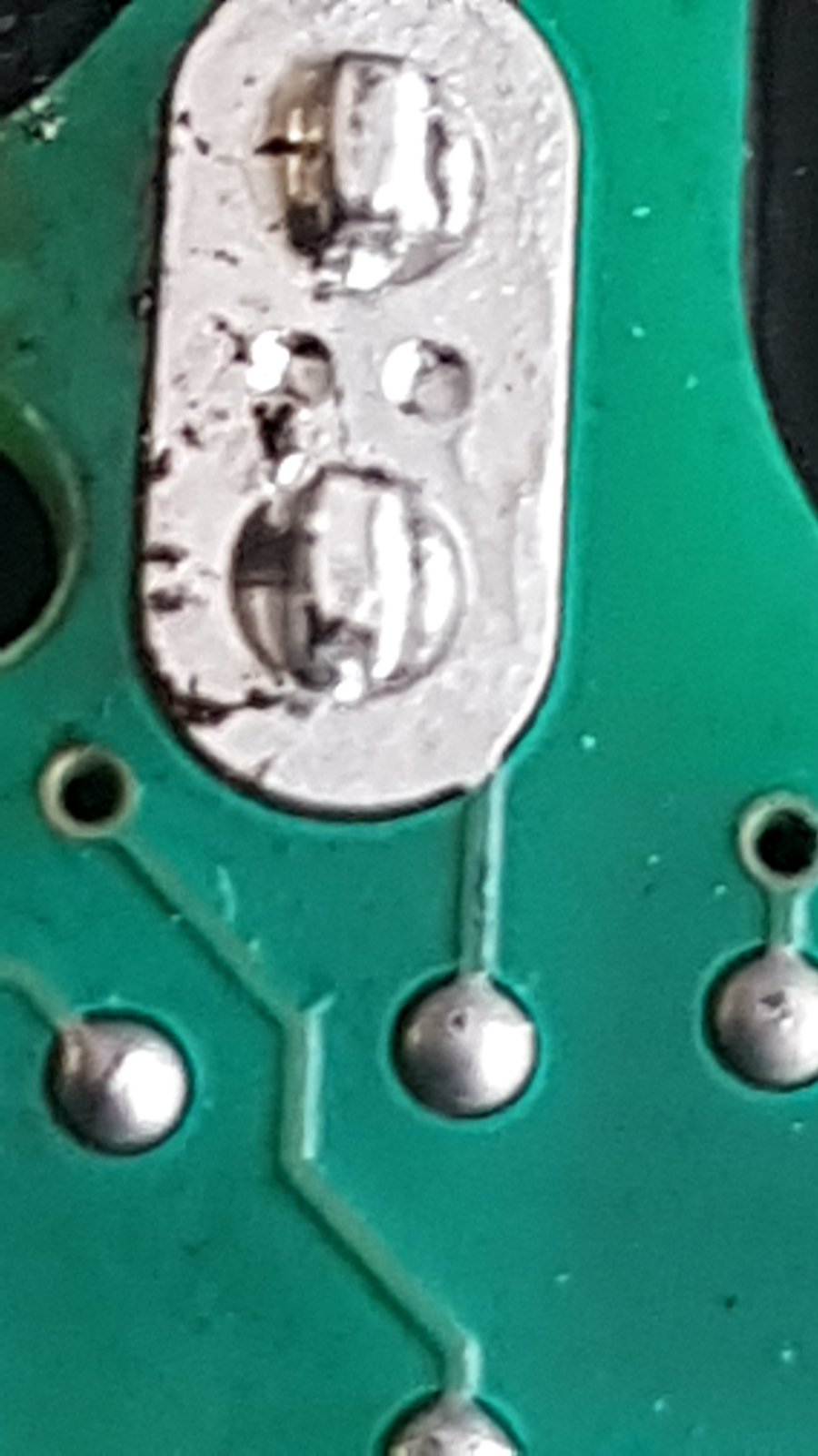

To get on the other side of the pcb you have to desolder the big lead contact.
I resolder al the components in the area of the outside connectors.
The pomp is now working fine, tomorrow i have to let out the air in the system and hope everything is fine.
Greetings,
Kees.

I only work on the electronic, not the pomp itself, and checked the condition of the carbon brushes.

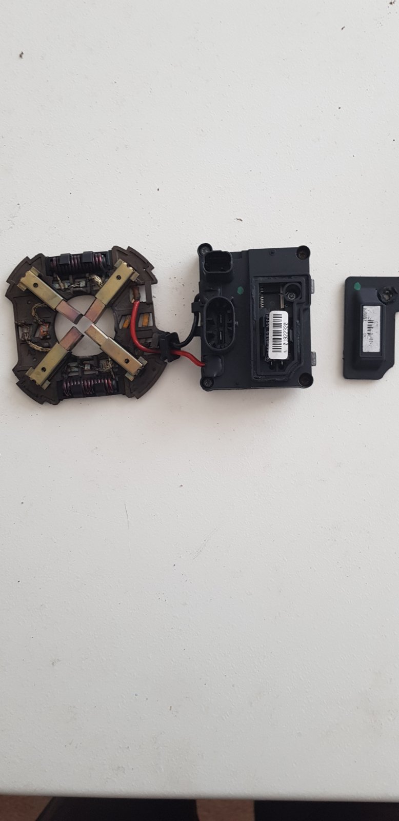

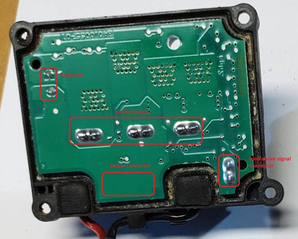

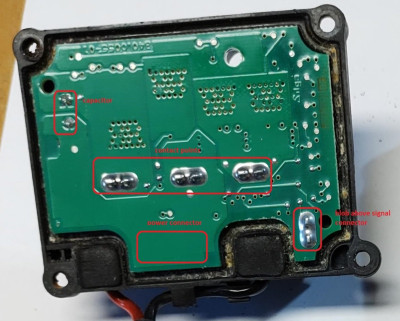

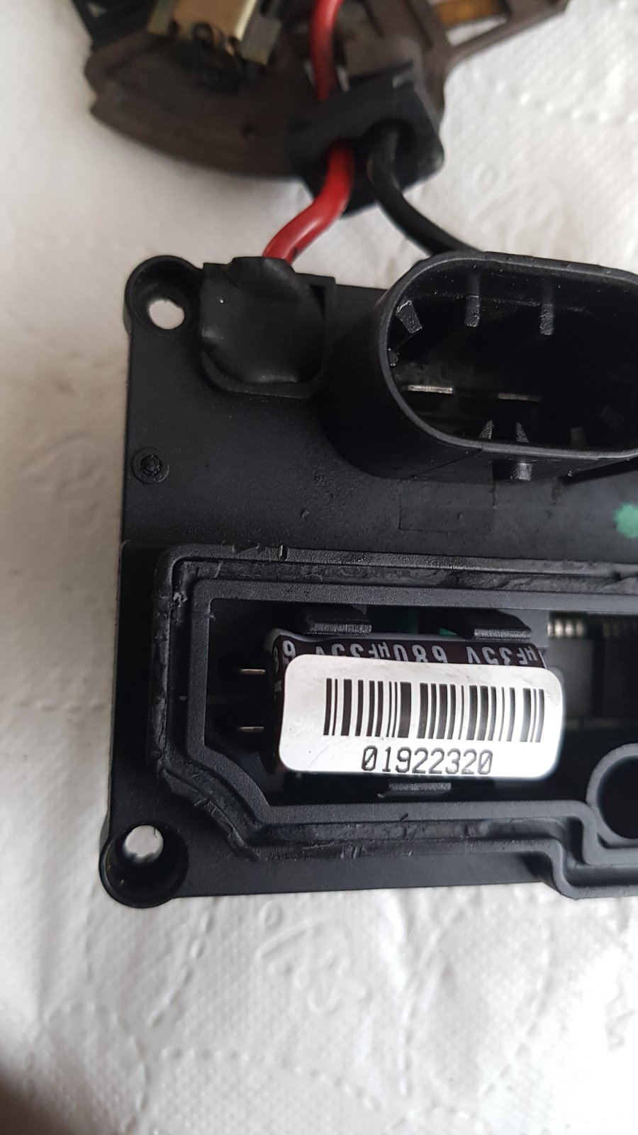

After fight with corroded-in-place bottom two bolts I'm finally inside the brains Cap itself is glued tongue and groove affair, don't know how Kees managed to open it so cleanly. I've used a fret saw with aid of scalpel and utility knife. Alternative access to hidden bolt could be with drilling through circular cap but that's a vent so pick your poison.
Circuit board itself is pretty stuck in place. Main power connector does not pass through, there is only blob above signal connector. For its removal you have to unsolder the capacitor, 3 or 6 contact points down the middle and blob above the signal connector? Is that correct or can something remain undisturbed?
viewtopic.php?t=84152

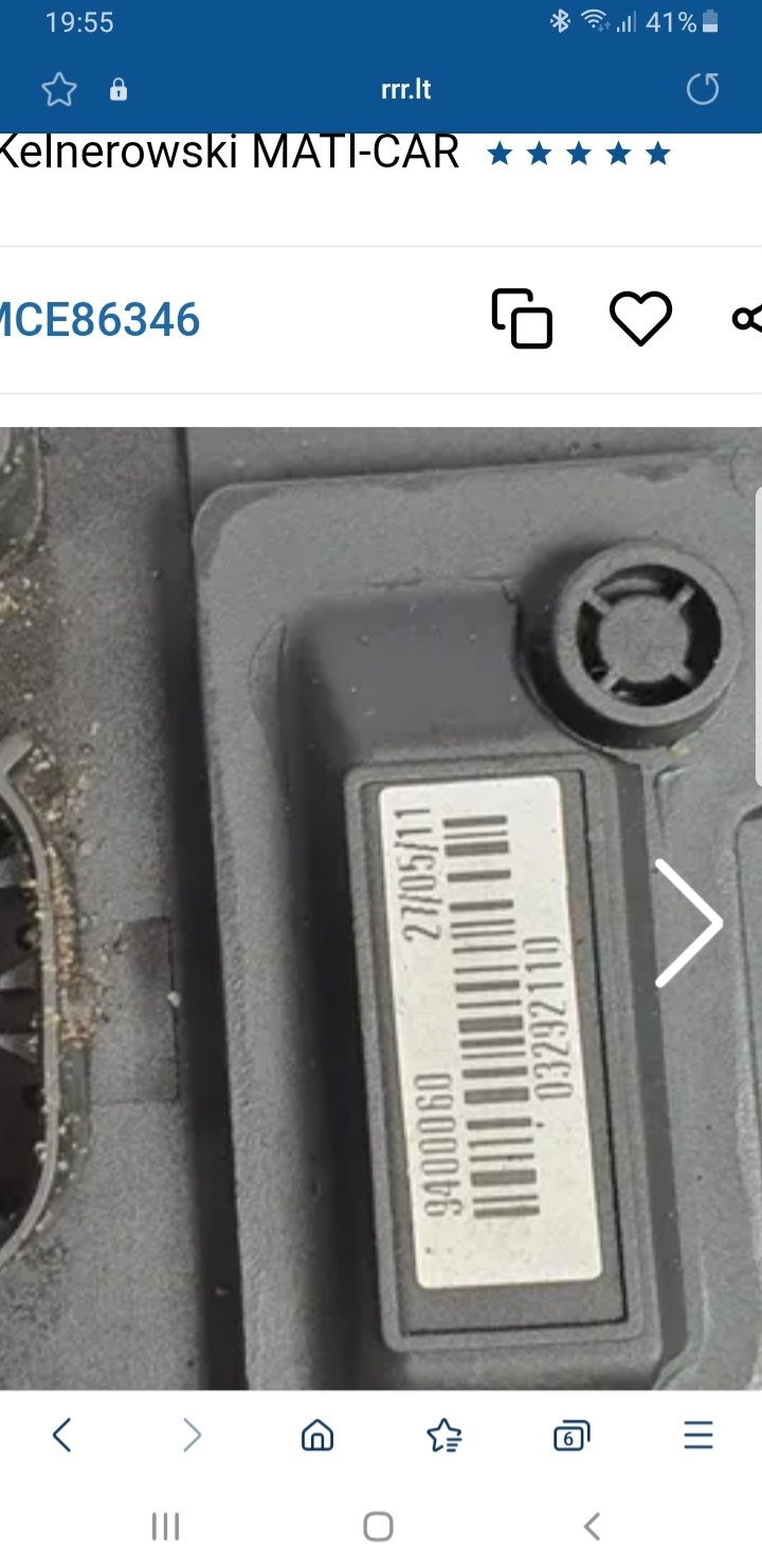

Another observation: both circuit boards are marked 840.055-01 so it seems that both inline-4 and V6 cars have same electric motors on their BHIs, difference is only in hydraulic part
