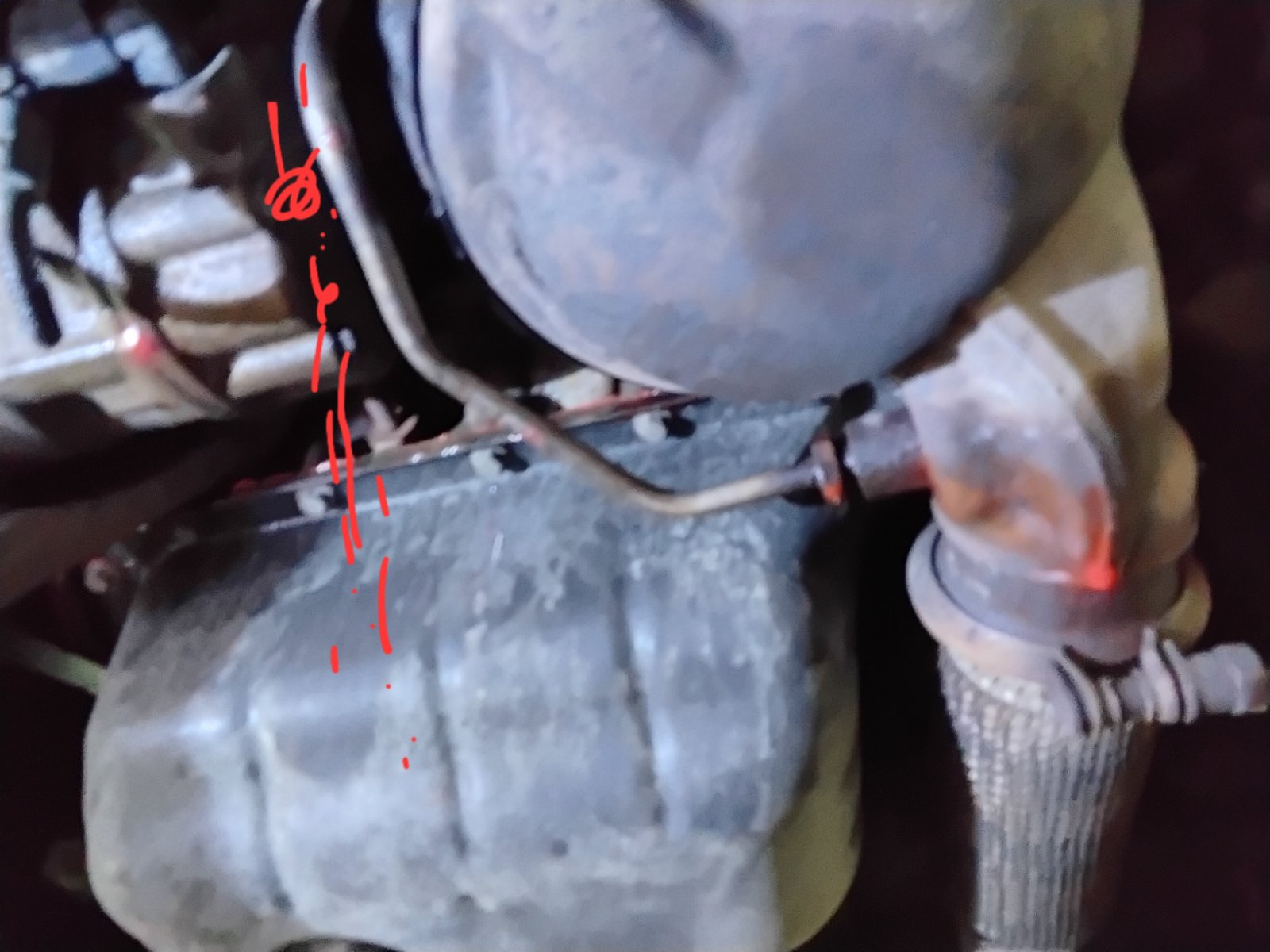

Just a quick rough edit of red pen which is an example of where the coolant is leaking

Cheers mick , cars been running great ,went out yeasterday evening for a meal with the wife , got back home pulled up on the drive got out the car the fan was on which is a first then this morning sitting in a puddle of coolant , cars !

Up on a ramp on the drive little room for anything but im seeing a wet dpf in places a wet oil cooler ,my guess is oil cooler might be where its leaking, dont want to run the engine to long but its dripping , really need some sort of diagram showing water routes , is there a pipe near this area ?

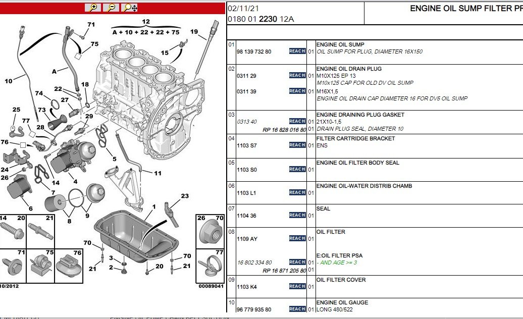

The oil cooler is bolted to the front of the block - it's under the oil filter and sort of behind the DPF. There is a set of gaskets that seal it to the block, and stop the water and oil mixing. Usually the oil ones let go, but water not impossible!
Just under £20 each at the dealer, no doubt cheaper elsewhere!
