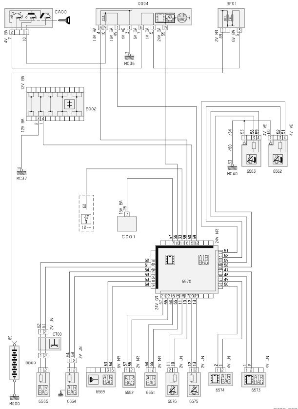

I would like if possible wiring diagram for airbag system and instrumemt cluster

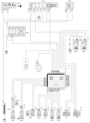

That is why I sugested if you could supply wiring diagram for air bag system + instrument I could check the communication between
air bag module and instrument, As I think there must be a measage sent to the instrument to turn off air bag light with no faults present

wheeler

Thanks Wheeler for wiring diagram will get it checked tomorrow and report back

Thanks again WHEELER for wiriing diagram checked wire from airbag ecu to instrument all ok
Changed air bag ecu, fixed the fault
