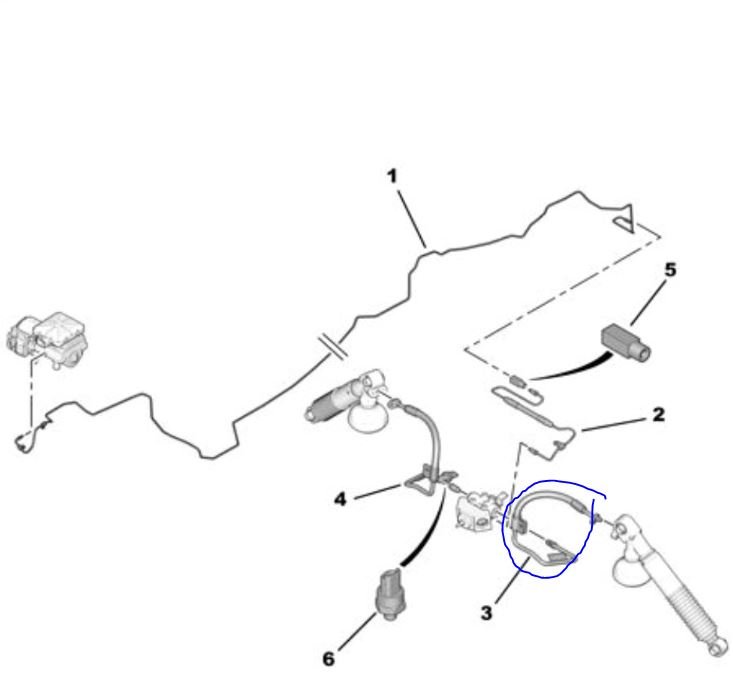

Dear French Car Forum Community,
Today I was transporting around 400kg of cargo in the back of my C5 X7 with lowered back seats which now feels like a huge mistake because the LH rear hydraulic pipe hose burst after I drove in a pothole.
Could someone please help me to find the proper PN for the hose as I see that there are several configurations.
I have 2011 C5 X7 2.2 HDI 150kw VIN VF7**************[VIN obfuscated, can be read by forum staff].
PNs could be?
- 5270VG C5 X7 LH
- 5270VF C5 X7 RH
Thank you and hope that someone can help.

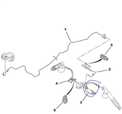

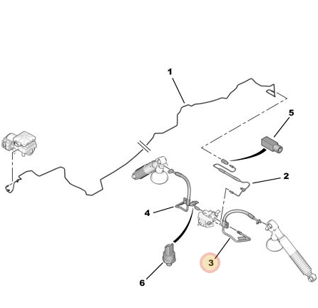

Re: C5 X7 LH rear hydraulic pipe-hose burst
Here you go:
(3) Hydraulic Pipe (Left) 5270 VG, £317.47
