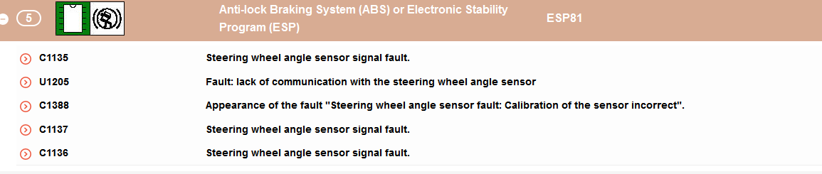

Trying to recalibrate the steering angle sensor on a Peugeot 5008 2012. I'm getting the following codes. I have made sure the wheels are dead ahead. But it keeps failing and illuminating the ESP light. Does it sound like the Angle sensor/ Clock spring I purchased is faulty or could it just need reinstalling? Thanks for any help.
The position sensor was working when I checked on diagbox but then the values stopped changing all of a sudden.
Typical as it's due an MOT this month!
C1135
Steering wheel angle sensor signal fault.
U1205
Fault: lack of communication with the steering wheel angle sensor

I have added a photo showing the faults from Diagbox, I have again taken the steering wheel off and cleaned the plugs and sockets with 99.9% Isopropyl Alcohol but still the same.
