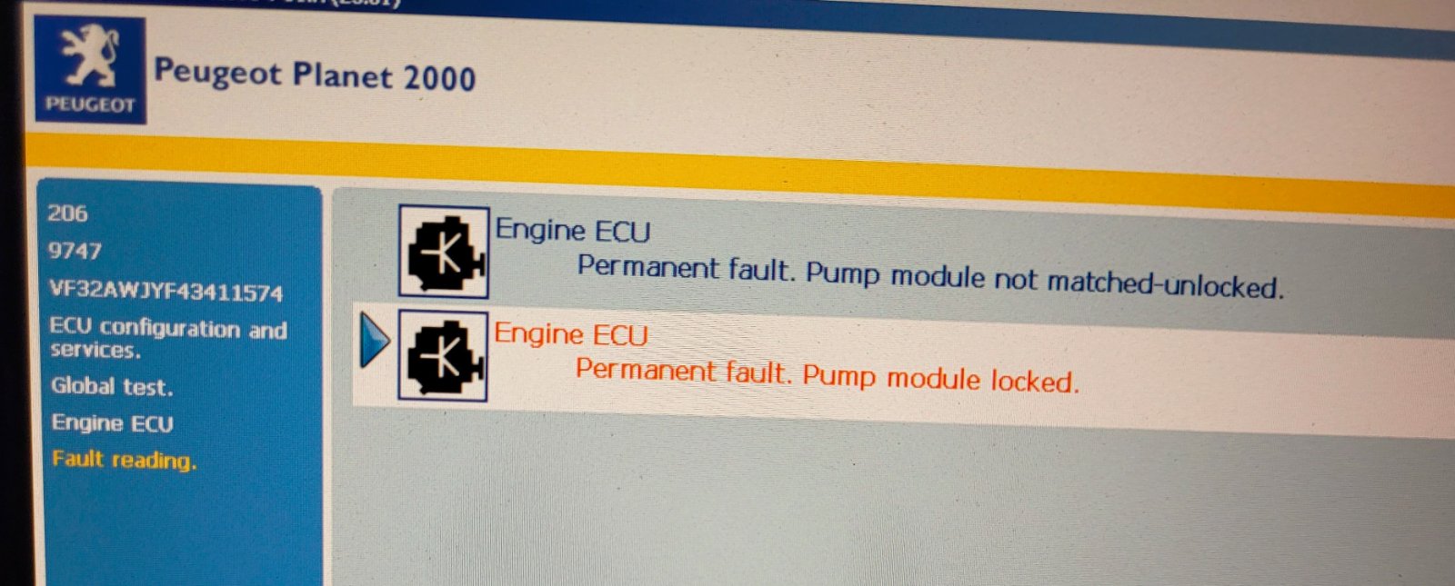

After replacing the original but faulty advance solenoid (coded) with a non coded LUCAS solenoid, I can't start the car.
The new solenoid receives +12V correctly after I start the car with the key.
A diagnostic with PP2000, shows this Default :
ECU Engine / Permanent Fault. Pump Module locked.
Tried to remove F2 fuse : issue is still there.
Is there any way to fix this issue ?
Thanks.

I take it you mean the stop solenoid and not the advance solenoid, the advance solenoid is different & its not coded to the car.
I would imagine that it will always log a fault if the original unit has been removed, have you tried plugging the original faulty one back into the harness & secure it in the engine bay to see if it gets rid of the warning?

Yes, you are right. I meant the stop solenoid, the one which is protected with a hard piece of metal cover.
The issue is that the pump module is now locked.
I can not put the original solenoid back as it has been torn during the removal process, so it is not usable anymore...

Is the immobiliser light flashing & making the annoying beep?
Not really sure that you could trick it without plugging in a stop solenoid to the original harness, its more than just a stop solenoid, it is actually a mini ECU & also communicates.

Re: [Peugeot 206 1.9D / DW8] Pump module locked
No light flashing, no annoying beeps.
If its not causing any issues or warnings just best to leave it alone.
