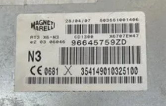

Please post your VIN in full without spaces - it will be automatically masked from public view after submitting your post & will only be visible to staff and I'll check. Ideally a picture of the label of the replacement unit will also help to determine what the new unit is v what was originally on the vehicle.

I will add pictures of both labels - the one from the defective (old) unit and the one from the replacement (they are almost identical). And I know, it says RT3, but it's definitely the RT4 (built-in HDD and it was also confirmed by Citroen).

Ok, I think the mystery is solved. It is very likely that one of the units has a different firmware version installed, so there is a conflict when the unit is hooked up.
You need to get the software CD and insert it so that it can update the unit to the firmware expected. Be aware though, that the replacement unit will be from a vehicle that may have different options to your vehicle and therefore may be differently configured.
