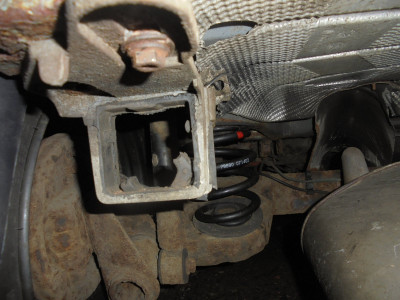

The Anti-Roll Bar Bush residing on the Falcon Sideboard featured here...
viewtopic.php?p=791679#p791679
...is normally resident in the square hole here and supports the BB Clio exhaust back box as a temporary fix.
I have a new intact mounting, but the old one is a bit difficult to get off with a couple of rusted in nuts and bolts in difficult to get at to cut off positions so the temporary fix may just have to remain for now.

Thats better, old back box bracket still on, but a much better rubber insert.
You will have come across the roadside debris of chunky hunks of rubber, some kind of bump stop I presume from HGV's, but maybe some other vehicle. Bit of DIY hacksawed the end off to make a tight fit in the square hole of the bracket and drilled a hole through it. Far better rear hanger than the Renault spec.

A nice bit of improvisation engineering there Neil, well done. Hopefully it will outlast the exhaust now!!
