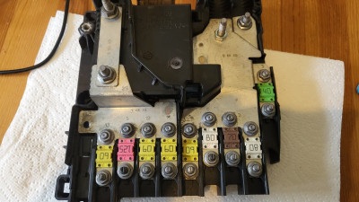

I have been trying to track down a fault on my C4 Grand Picasso (2016) for a while now, whenever I turn the ignition on I get a "Battery Charge Fault" come up on the dash along with the service light. The fault used to come and go but now it's here there all the time. I used to be able to clear the fault by carrying out a BSI Reset, but now it comes back every time.
I have tested the alternator and the battery is charging at 14.4v, I have also tested the diode in the Alternator, so I can assume that the charger circuit is fine
After a lot of internet sleuthing, I seem to have tracked it down to faulty BPGA unit relay ( 9675350280 ) but I am struggling to find any extra information on this unit to aid fault finding
My assumption is that there are two sides of the BPGA, one Permanent Live (right hand side) and one switched live (left hand side) via the relay
Even with the BPGA out of the car, the relay is closed which would mean both are permanently connected to battery live. 0.2ohm connection between both sides when removed from the car
Does anyone have any wiring diagrams/schematics for the BPGA ( 9675350280 ) please?

My problem is there is no definitive answer as to how the relay operates in this BPGA. The relay in the one currently fitted seems to be permanently closed, even when removed from the vehicle. I even purchased a 2nd hand unit and even before it went on the two sides of the relay were connected together and appears to have the same issue as the one fitted to the car.
I also have a power drain, anything from 400mA to 2.5A even when the car is locked and left
I was hoping someone would have extra information that would aid fault finding here.

I wish it was that simple Jim, the relay within the BPGA is sealed.
my assumption is both the unit on the car and the one I got on eBay are both unserviceable with the same issue (Welded contacts closed, what are the odds of that!)
All the schematics/wiring diagrams I have been able to find online suggest the relay should be Open when un-powered/removed from vehicle. If this can be confirmed then at least I know I have a problem

As you have two, I'd be looking at getting inside one of them and seeing if there's a possibility of substituting an external relay. You'd need to know what voltage and current the operating coil takes and what the maximum current the contacts would have to carry might be...
Potentially destroying one to glean its secrets and assist in fixing another is something I've done a few times with a variety of other 'sealed for life' items in the past...

I did see a picture of one opened up on the internet somewhere obviously crash damaged case but you could see the guts of it.

You may also find that solid state switching is used instead of traditional electromagnetic relays.

IIRC the solid state relays are potted as well.

I pulled one apart recently and it’s not solid state. I thought that it’s was well known to be not so. Good luck with fixing the relay as it would be a lot cheaper than replacing the whole unit.
