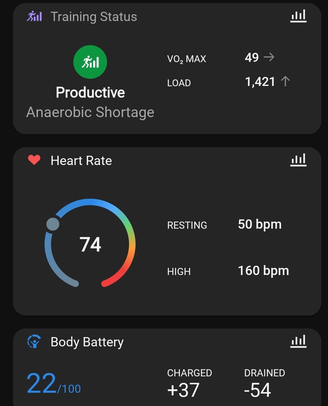

That was good, but even better was my overall training/health status
I'm delighted to see my VO2Max is up a point and my resting heart rate is now nicely stable at 50bpm
This, for someone who'll soon be 65 years old is not bad at all...
I'm now charging up my body battery

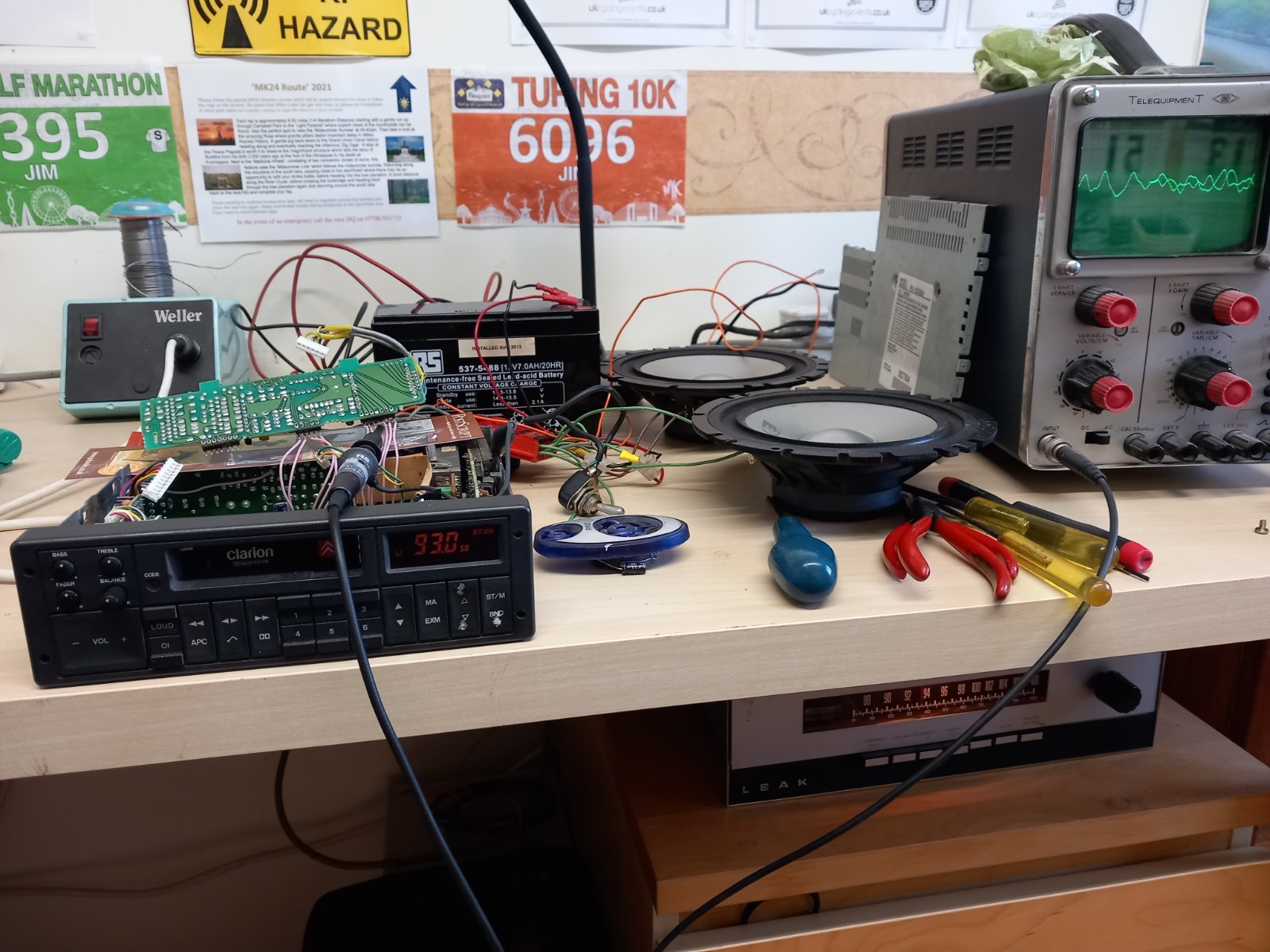

I then spent some time on the XM radio project...
First job was to extend the audio preamp board on extensions so I could properly diagnose it...
Tests have proved beyond doubt the tape head amp/Dolby thick-film module is faulty.
Despite finding a potentially suspect electrolytic on it, these modules are effectively irreparable. Game over perhaps but no, not likely, given the reason I'm doing this work..
My plan is to build a substitute module using NE5532 op-amps. It won't have Dolby functionality but I think that's a small price to pay. I looked at building from scratch but for less then the cost of individual components, ready-made preamp modules are available from eBay. Two are on order.
If that all works, I'll then look at adding Bluetooth to it, either in place of the cassette tape functionality or in addition to it... Fundamentally, it has a very high quality tape deck - as is the rest of the radio.
Watch this space
