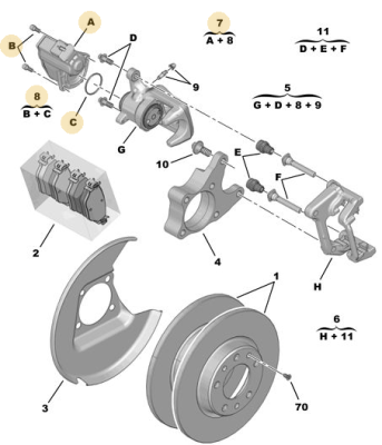

Here is the diagram showing the caliper motor:
(7) Back up Caliper Motor, part: 1608999280, £168.13 inc. VAT from Citroen
So this part (7) includes all the highlighted parts (A, B & C)
