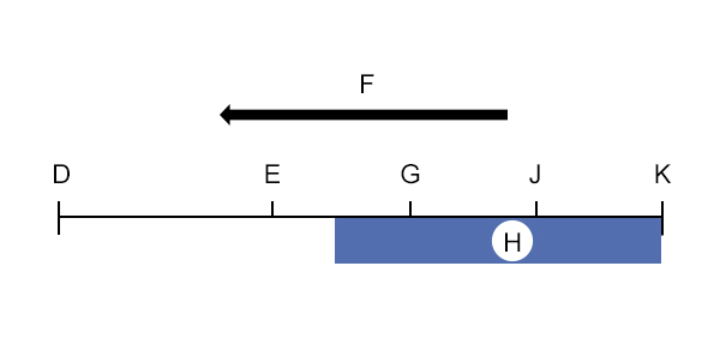

Interesting, as there are anti-stall measures incorporated into the system. For general information on later Stop Start systems (and here I'm specifically referring to manual or auto models of the system only with reinforced starter and not reversible alternator or network maintaining devices:
Manual gearbox (*)
For a manual gearbox, automatic stopping and restart of the internal combustion engine depend on how the clutch pedal is depressed.
"D" Clutch pedal pressed down fully.
"E" Automatic restart point of the internal combustion engine.
"F" Depression direction of the clutch pedal.
"G" Intermediate point.
"H" Torque transmission area.
"J" Automatic stopping point of the internal combustion engine.
"K" Clutch pedal fully released.
The Stop and Start system with starter authorises the automatic stopping of the internal combustion engine when:
For an automatic gearbox, the Stop and Start with starter function authorises the automatic stopping of the internal combustion engine when.

Manual gearbox (*)
- The gearbox is in the neutral position
- The clutch pedal is released as far as the automatic stopping point of the internal combustion engine "J"
- The speed of the vehicle is less than or equal to 3 km/h
- The Stop and Start with starter function requests an automatic restart of the internal combustion engine if the clutch pedal is depressed beyond position "E".
