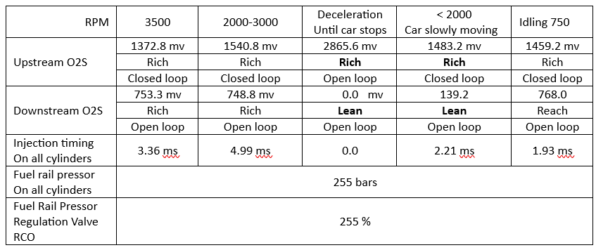

New O2 sensors readings under different driving conditions (attached as a png file):
Upstream still reading rich even when the foot was off the gas pedal and the fuel was cut off?
Downstream is always in an open loop and reads lean (in columns 4 and 5), while upstream is still reading rich?
