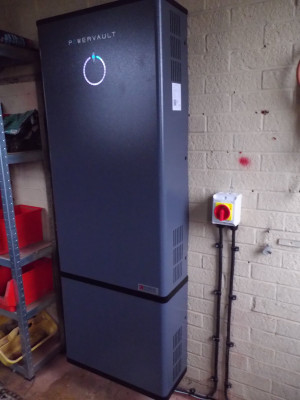

I would be interested in the chapter and verse on the battery you have plumped for.Gibbo2286 wrote: 14 Feb 2024, 15:45 Here's what was on the pallet all installed now in about five hours by very competent electrician.............................pocket money's all gone.

NeilGibbo2286 wrote: 15 Feb 2024, 09:59 My solar panels back in 2019 came from a Cheltenham company Forever green energy, at the time the only offers for batteries were Tesla at over £7k so that didn't happen, recently the government dropped VAT from the batteries and this Power Vault company offered a deal with an additional 10% off so the total price including installation came out at under £4k.
Power Vault though only does the batteries they don't do solar panels. Options to choose the size of battery and the chassis ready to upgrade later if you wish.
The on-screen programme is very good although I have to learn a bit more yet but it tells you in real time what the panels are producing whether it's going to the battery or being consumed, what's being taken from the grid etc.
