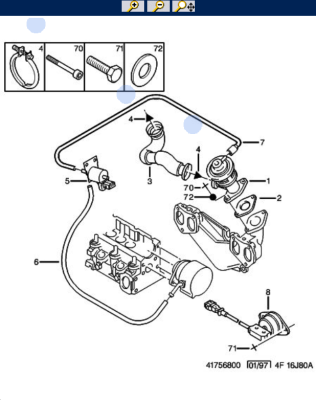

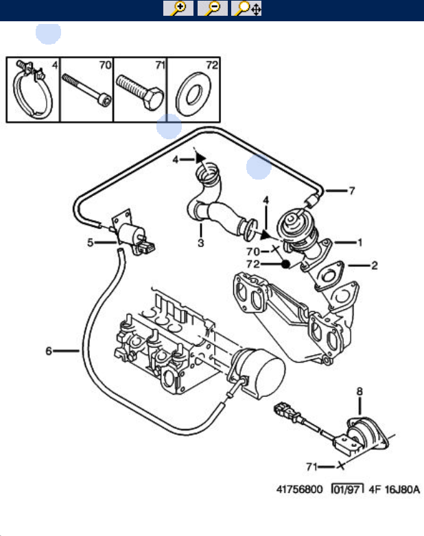

I wonder, has anyone on the forum actually FOUND the EGR on a 1998 1.9TD Peugeot Boxer with the XUD9TE engine, and if so, could they tell me where it is?!
The Russek Manual says it should have one but I have scrutinised it from above and below and looked all around the exhaust manifold, the turbo, and the exhaust at the turbo end and see nothing which looks like this: https://www.ebay.co.uk/itm/315024418978.

No, they're a sh*tty piece of technology. As I can't see one, I don't think it's got one, which is very surprising. Anyway, now I've bought some EGR cleaner anyway as £7.99 and 15 minutes spraying is much easier than what comes next and may clean out any yuck.

Re: 1998 Boxer 1.9TD Grey smoke and rough idle - checked fuel lines for air, air intake for leaks... still no solution
LH end of the exhaust manifold, vac operated
Don't know what the item at 8 is, seems to be an atmospheric pressure sensor, but don't know what it does.
Thanks very much for that, Richard. It definitely hasn't got an EGR valve (designed without one, not just removed and the various holes blanked off) as there is only one pipe from the vacuum pump, for the brake servo. So the mystery deepens. I'll give it a go with EGR cleaner when that arrives anyway, more because it's cheap and easy than anything else, and see if that has any effect.
