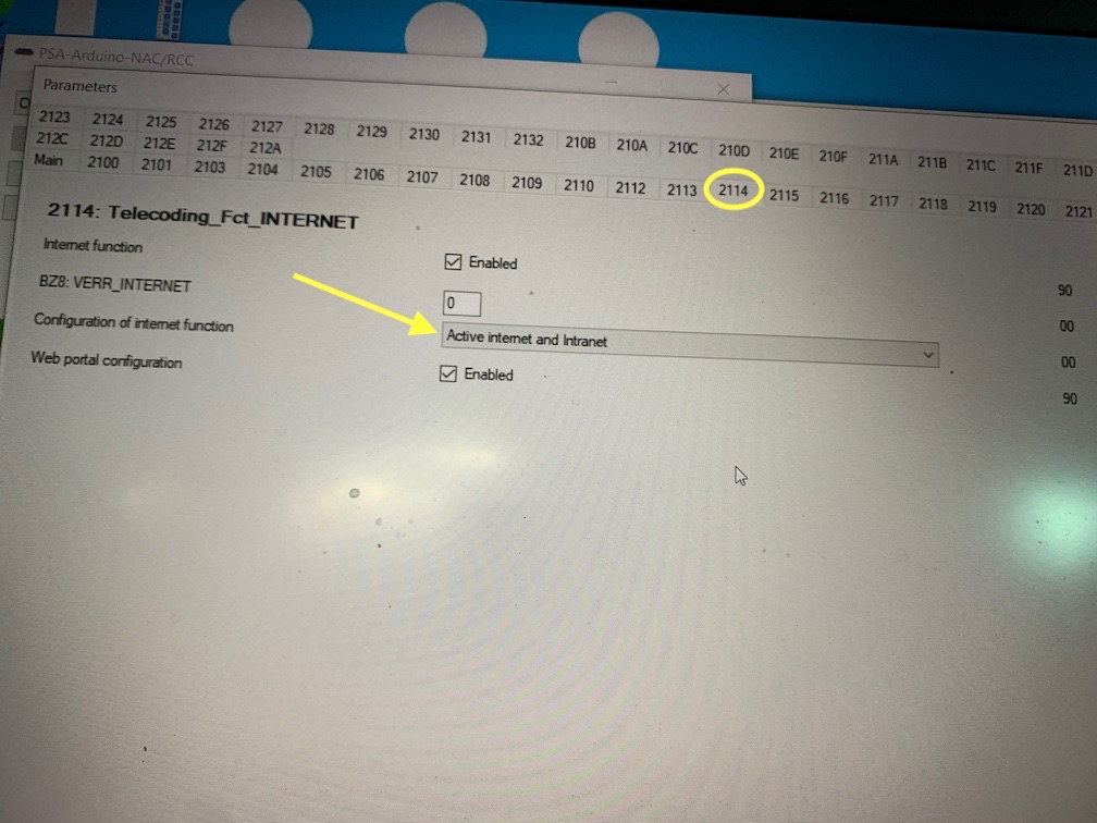

PS: I did some Arduino hacks the other day (in Telecoding_Fact_Internet section I set "Active internet and Intranet" - previously it was set to "Active internet and inactive Intranet"), but don't know if that's the reason? Wanted to enable On-board hot spot, but that didn't work, so I didn't bother anymore. And today I switched the screen to Nav mode and immediatelly saw the TomTom Traffic logo with speed cam warnings, as well as weather, gas prices and road works, it was all there??
