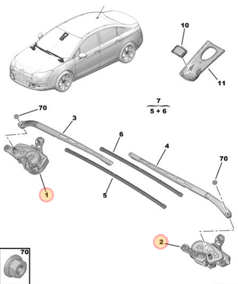

Be aware these are different units for Right and Left Hand Drive vehicles!
For the price difference, (if that is a used one you have quoted), I would get a new one to be honest.
Right Hand Drive:
(1) Wiper Motor, Right, part: 6405LA, £453.55
(2) Wiper Motor, Left, part: 6405LE, ££453.55
Right Hand Drive:

Thanks Marc,
It's a right hand drive UK car that I've exported to France. I'm after "part number 2" on the diagramme.
Those motors are absolutely extortionately priced! At the end of the day, it's a "wiper motor" when all is said and done. Citroen says over £900 for a pair and all the aftermarket outlets say "out of stock.
I am now old enough to remember my Ford Escort wiper replacement. A motor (one!) with 3 wires, which cost £11 from a Ford dealership and took 5 minutes to fit with a 1/2" AF spanner. Halcyon days...

I've now put the numbers on my previous post (I left off which was which) and this is a RHD as per your VIN, which is why we use the VIN. I only thought it worth mentioning about the LHD / RHD issue because you are in France and of course the local LHD variants are NOT compatible in case you try to source one locally! The wiper arcs and movements are programmed differently.
A motor yes, but more than that they have ECUs in each one, so some fancy electronics to make them work with each other and up to about 19 different speeds, so a bit different to a basic mechanical 2 speed on off motor from the dark ages
But still very expensive.....
