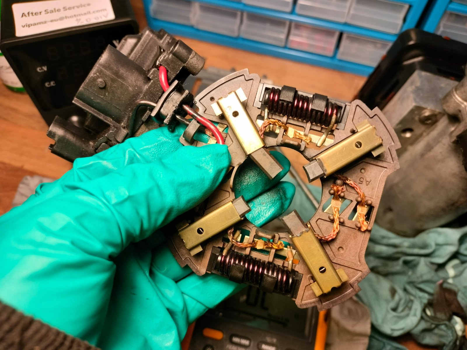

I just picked up a 2011 C5 (2.0 HDI) this week to add to my collection. But of course with my luck, the suspension failed and sank down while I was driving home from the dealer...
It turns out the previous owner had the original hydraulic pump fail in 2021, replaced it with a used ebay unit which also failed on him 2 years later, replaced it with another used ebay unit which has now also failed on me 6 months after the previous swap. The current pump details:
This thread has been extremely useful so far in troubleshooting, the contributions from Marc and many other folks are very insightful!

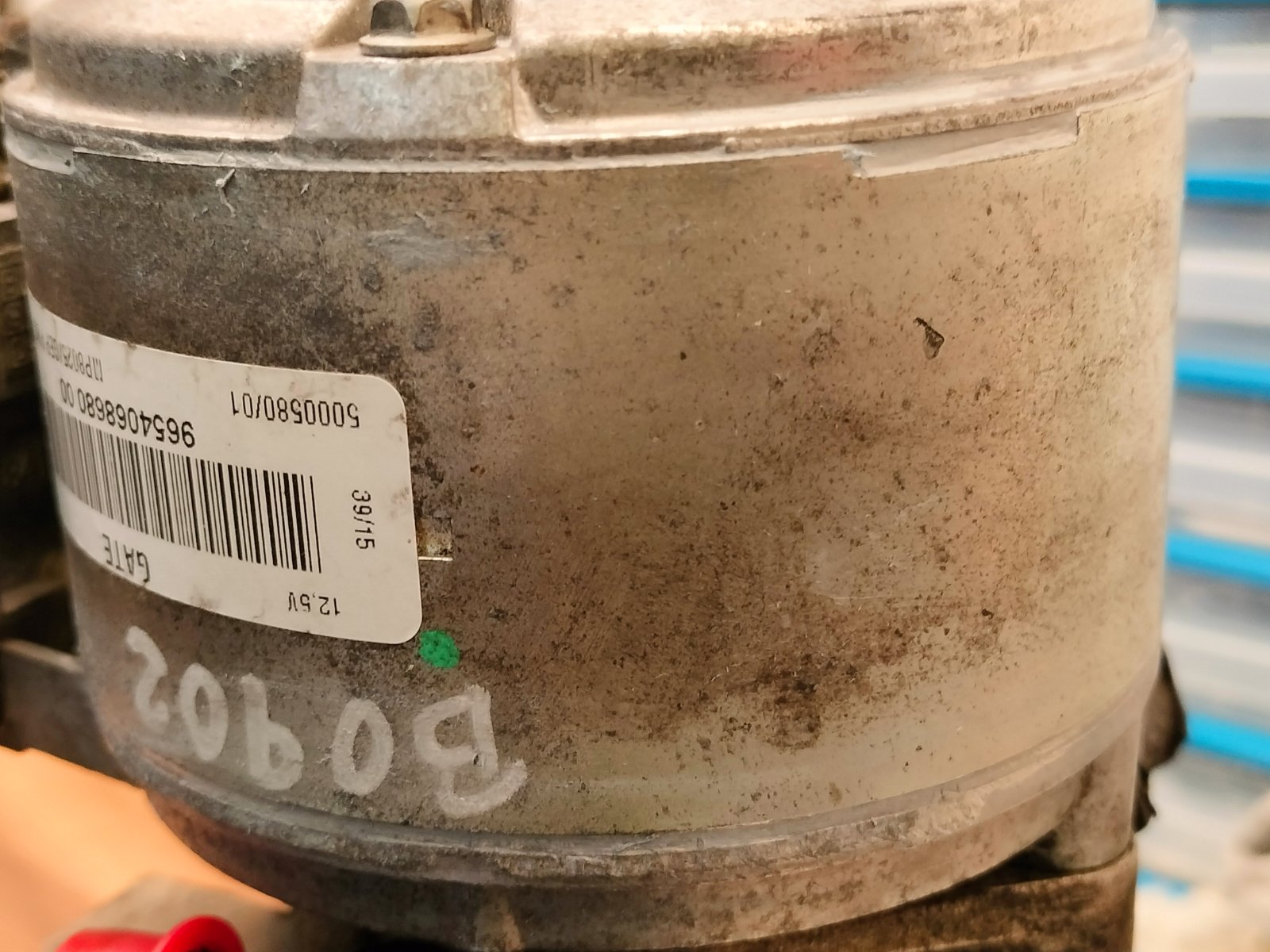

So the status now, I was able to remove the hydraulic pump and indeed it had the seemingly common issue with the oil/carbon dust mixing into a paste and fouling up the commutator (top level symptom was the midi fuse that protects the motor blowing). As an engineer it upsets me that Citroen did not design a seal here to prevent the oil ingress. I have cleaned this up with IPA and shop air and the motor now runs fairly freely when it is separated from the pump itself.

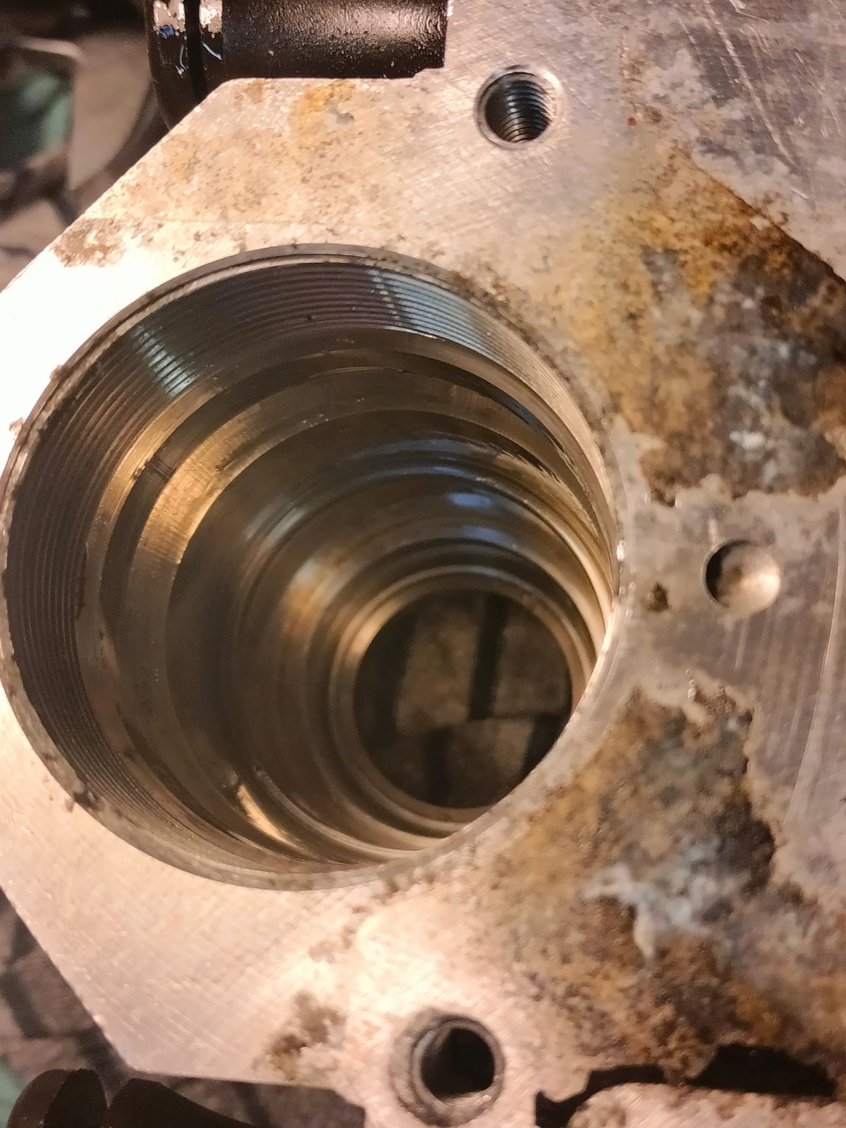

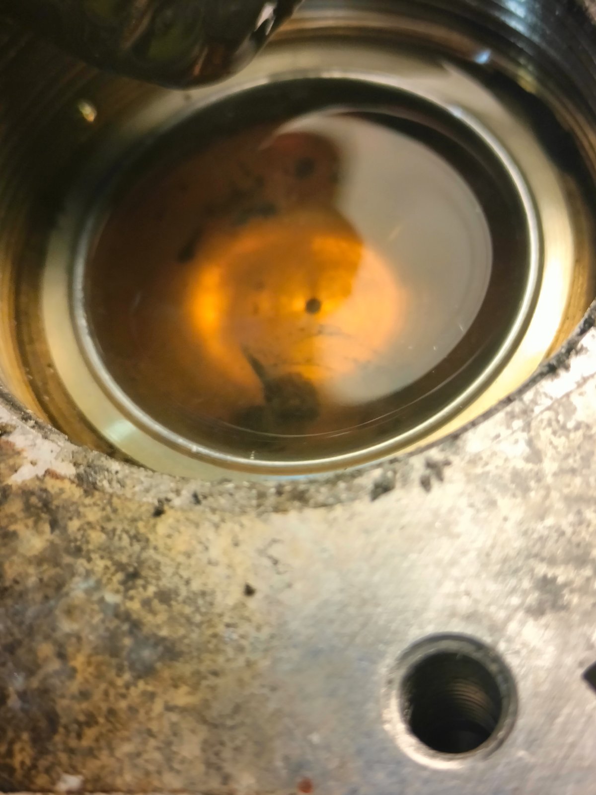

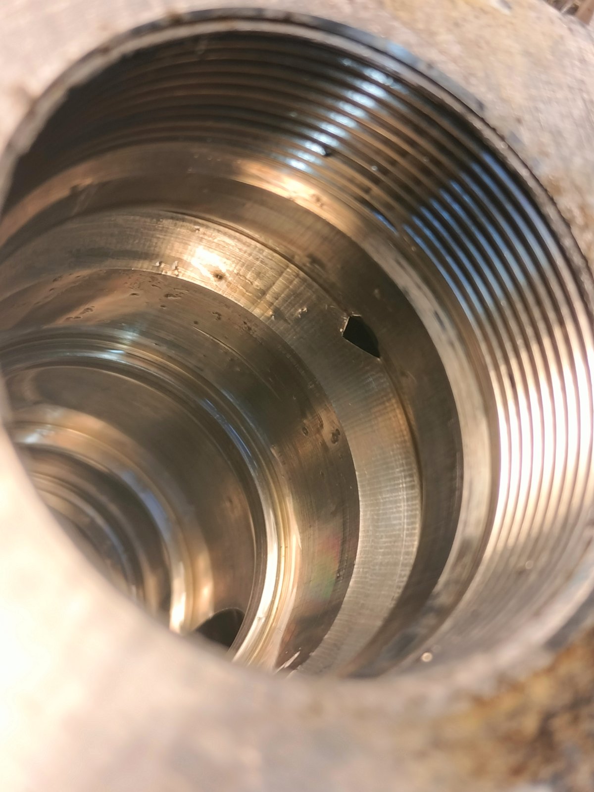

But there was a lot of resistance on the pump when I tried to rotate it. So I have stripped apart the central bore of this now also.

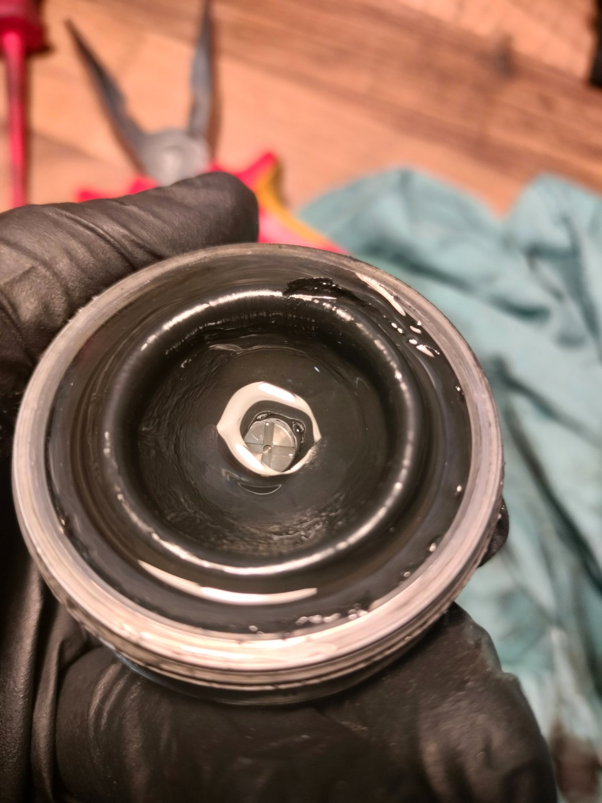

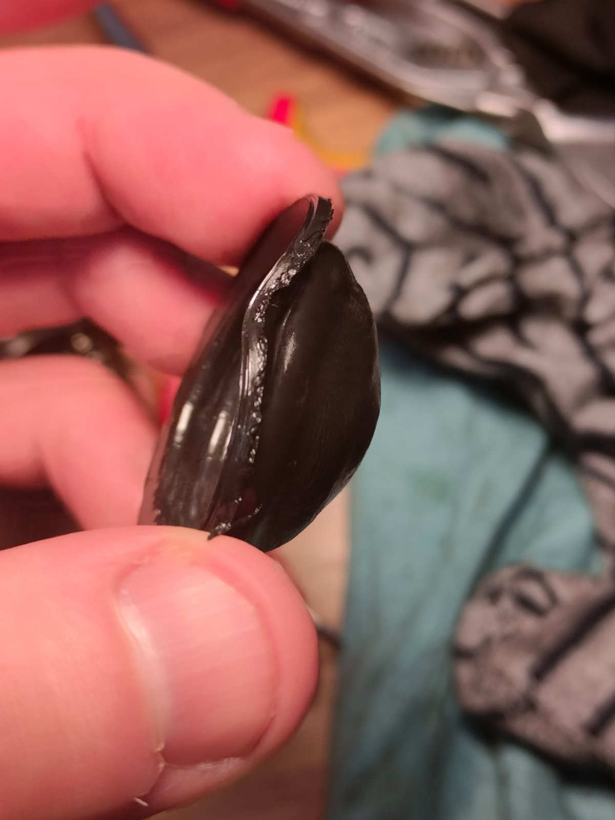

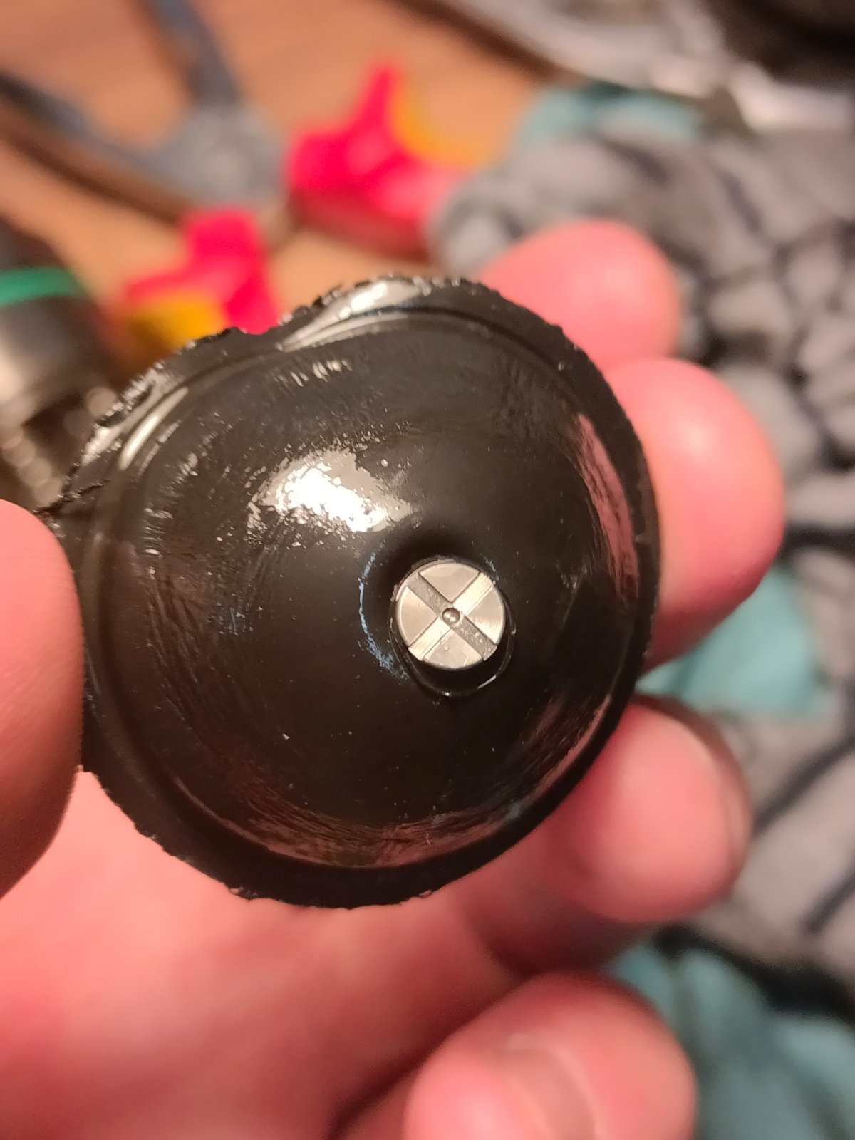

The only obvious issue that jumped out at me was the diaphragm at the oppisite end of the pump to the motor, is this an accumulator of some description? I would assume it is smooth the pump outlet pressure. Anyway, the diaphragm was quite deformed unsymetrically and had frayed, releasing some bits of NBR? into the oil. Hopefully these haven't blocked any of the lines elsewhere in the system.
So my questions after this entertaining week of troubleshooting my new steed.
0. The LDS oil that drained from the small outlets was quite cloudy, is this normal? The LDS that drained from the resovoir was nice and clear. They only replaced it 6 mths ago. The car had been standing from 1-2 months before I bought it.
1. Can we buy individuals spares for these pumps anywhere? Ideally I would just replace this diaphragm to start with as it could be a very cheap and handy fix then, any ideas for a part number or a supplier? (In my searching I only found complete pump units with quite high prices 400-700€ even when 2nd hand with 200'000+ km on them and in "mystery" condition. Or brand new ones for 1500-2000€, which is almost half the price of the car...).

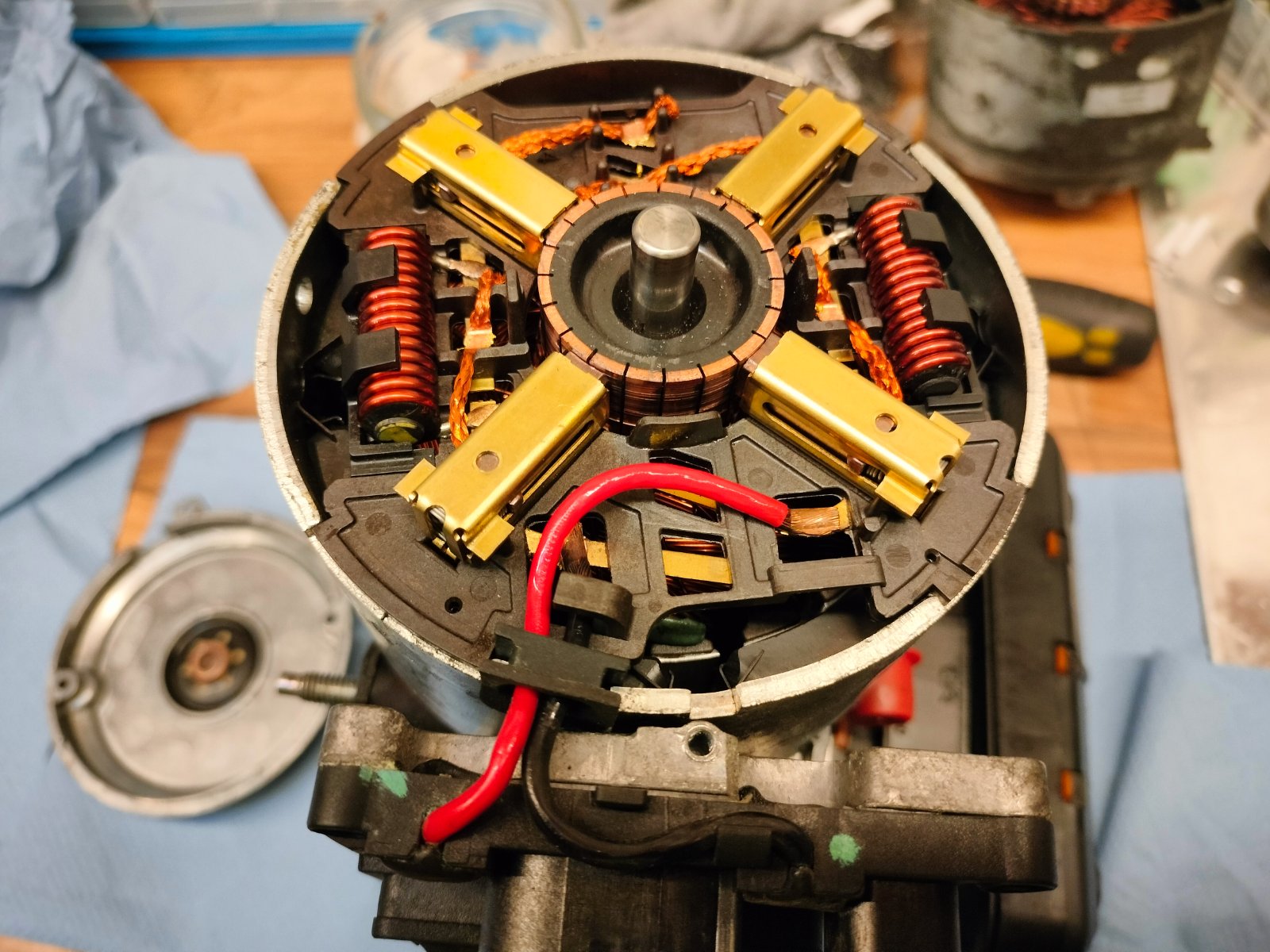

2. My motor did not have a smoothing capacitor between the +/- terminals that I have seen in some peoples pictures. Is this normal?
3. Two of the brushes are significantly more worn than the others. This seems odd and I am not sure the reason?
4. Should I strip apart the solenoid valves also to clean out any debris from the failed diaphragm?
5. Are there any other reasons I am possibly overlooking that would cause the pump to have resistance while trying to rotate? I can only think perhaps if the solenoids were all stuck closed the pump would be just trying to dead-head and load up the motor until the fuse blows?
Cheers!

I am new to this forum, but not to French cars. They have given me much joy and much suffering. Life is a rollercoaster.
Cheers!
Alan
