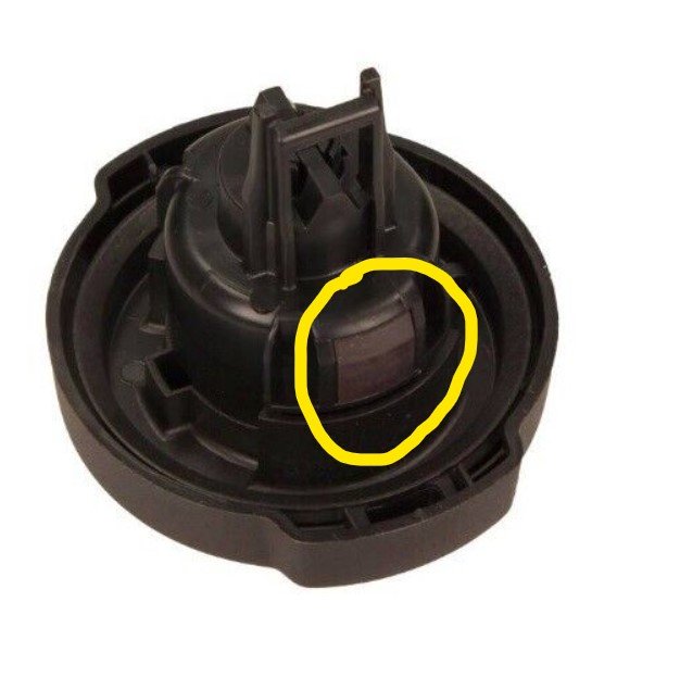

Early DPF equipped PSA cars have a sensor that detects when the fuel cap is removed so it knows when you are adding fuel so it can calculate how much Eolys to inject. If its not working it may not inject additive or inject the right amount. Next tome you remove your fuel cap look on the side & you will see a couple of magnets on the cap, these line up wiith a magnetic reed switch in the filler neck.

I definitely don't have magnets on my filler cover or the filler cap, was this put on pre 06 C8s?

Have another look, not immediately obvious at first. Early ones had it, some more modern models still have the caps with magnets even though the sensors were phased outRp0thejester wrote: 29 Jan 2024, 21:10 I definitely don't have magnets on my filler cover or the filler cap, was this put on pre 06 C8s?

I can guarantee mine doesn't have that. Could it be because I have the display screen or a swapped fuel cap?

Should I be concerned with the filler cap fault? or does it have a backup function based on distance travelled (eg. If it travels more than an average tank and hasn't detected the filler cap does it fire a shot anyway)
Are there common resolutions (sticky reed switch?) or is it more likely some wire chasing?
