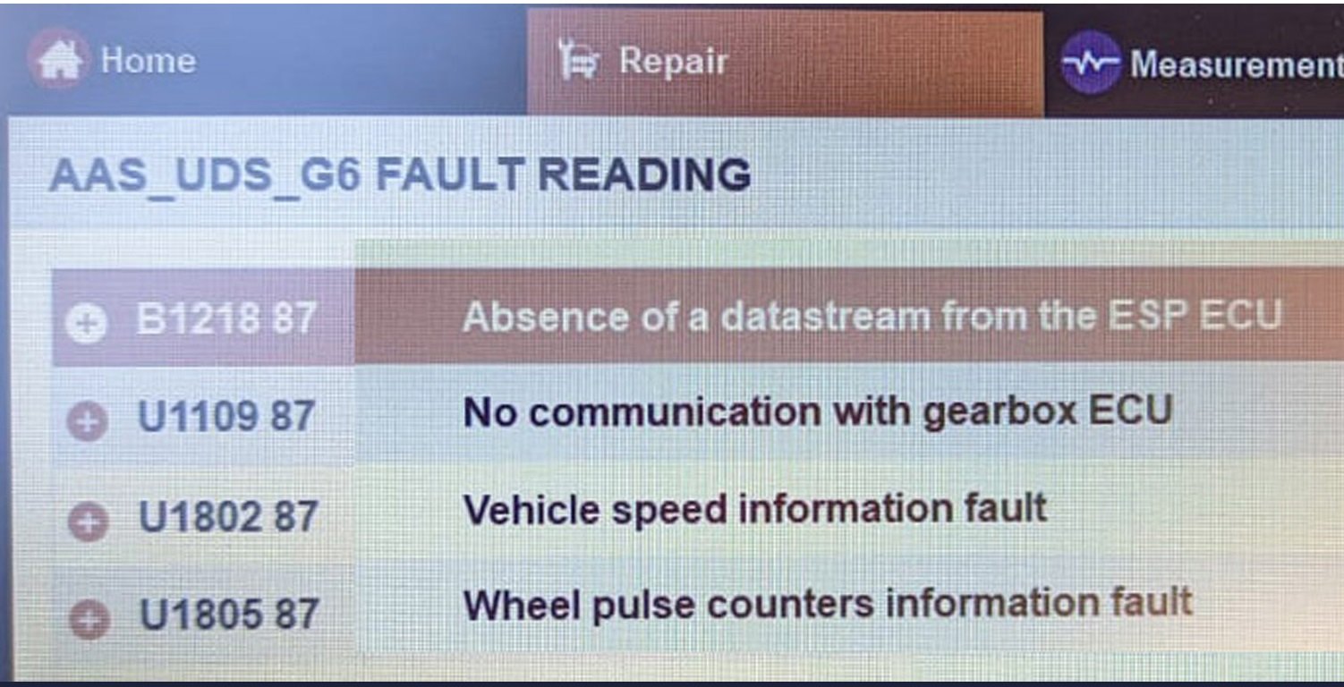

Hello sir , i'm kinda dealing with something very similar to this issue. AAS_UDS_G6 throwing up some DTC's very alike to the DTC's in this Topic. Car is 508 R8 EAT8 diesel.
Everything is working but collision warning starts showing up after a certain amount of time.
U1109
B1209
B1218
and some other that i can't remember (I'll add a screenshot later)
Can you help me solve this? I have Diagbox 9.186 (not online authorized) And Alicar ACT v2 (this thing can offline telecode pretty much everyting with arduino)

Wacd wrote: 18 Jun 2025, 14:33 Image
I used alicar act v2 program in-built macro "one click semi-automatic parking activation" last night and it failed.
Restored the original settings after that.And all of the DTC's are miraculously went away today.
Only DTC that i have left is B1576 54 in Touchscreen module now. I'm hoping that i can find a solution to that one too.
