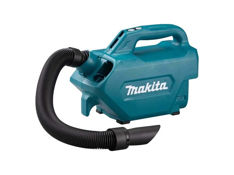

one of these would be a better way of doing it.......1x battery, 20 mins.....and it opens the door to more power tool usage in a non-supplied garage
https://www.makitauk.com/product/dcl184.html
