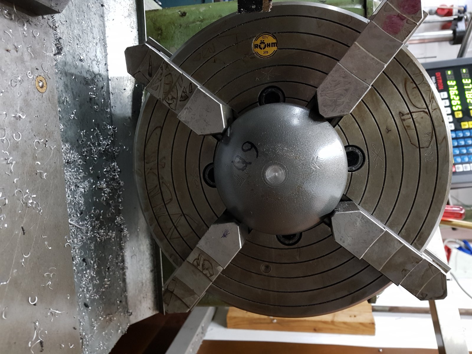

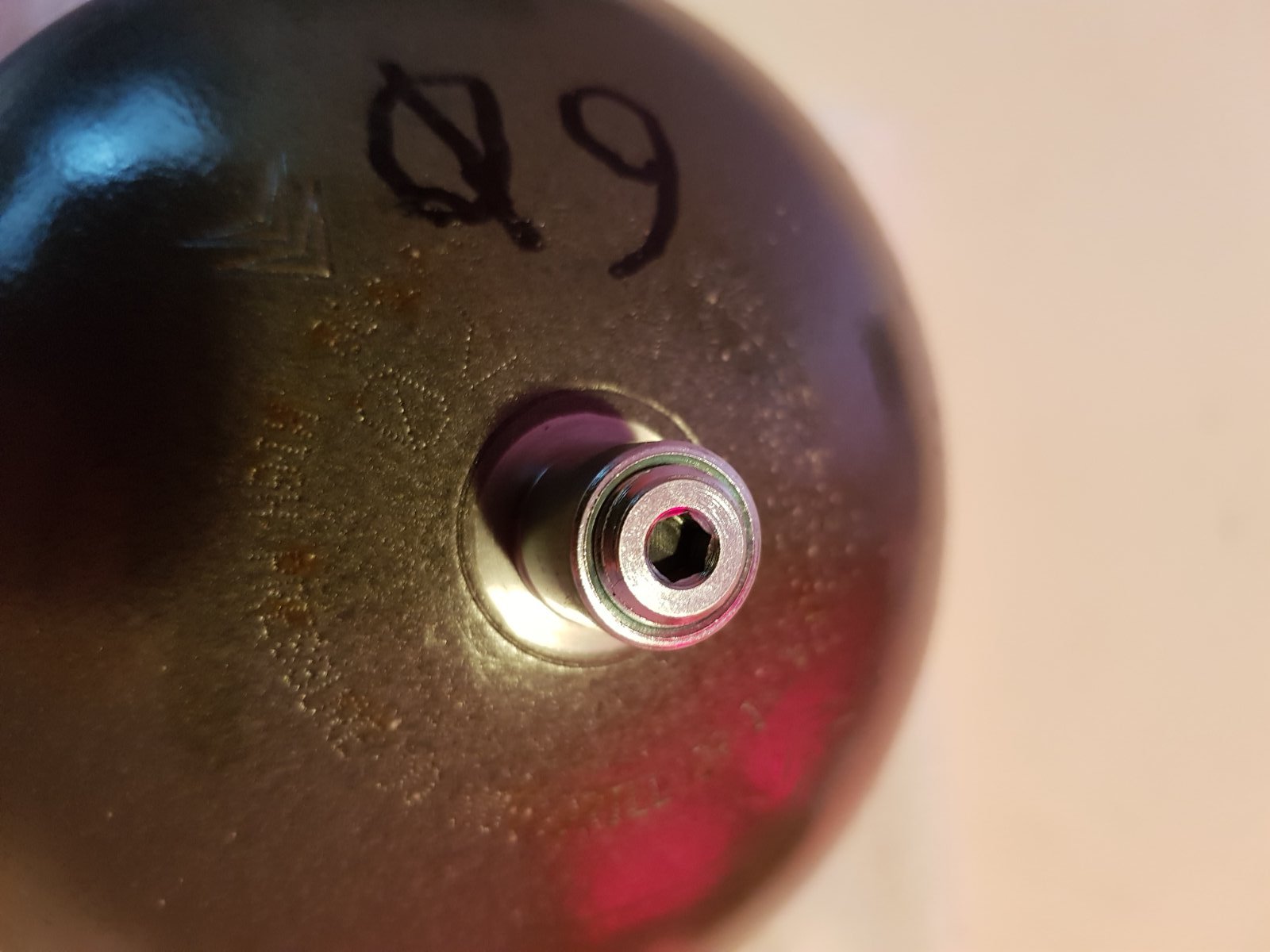

Hydractive 3 spheres are not serviceable in the same way old BX spheres were. BX spheres could have the filler plug removed and replaced with a filler valve, and refilled with a tool from Technosir, however, the grey spheres on the hydractive cars have those ports welded up, preventing checking of and recharging of the spheres. Consequently, the only real way to diagnose good or bad spheres is by reviewing the cars suspension behaviour. Stiff suspension would generally suggest spheres that have lost their charge and need replacing.

Technosir have also these plugs for C5 pheres, i uses them, and refill my C5 phere's

There is a tester to check the tare pressure of a spring ball.msionut28 wrote: 25 Jan 2024, 20:53 Sorry, how would you check the spheres pressure? I suspect mine needs changing, as the ride is quite stiff.
Every Citroen workshop has one and it works for both older LHM balls and newer LDS balls because the thread is identical. Many hobby mechanics have built such a device themselves.
To do this, the ball must be removed - screwed into the ball tester - and tested with oil pressure (regardless of whether LHM or LDS.
