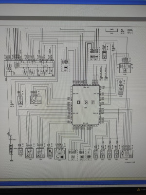

Greetings guys,
I have a problem with Xsara Picasso 1.6 16v (NFU/ TU5JP4 engine).
Engine cranks, but wont start most of the time. I have been struggling for almost a month now. First, the fuel pump was dead (got that from not hearing it when I switch on the ignition). Replaced it with a used one, and now the engine barely starts. I also have LPG installed which complicates things. Now, most of the time, when engine is cold, it will start after a lot of cranking. When it starts it works crappy. When it's hot, it won't start no matter what I did, except if I unplug the coolant temperature sensor. When the engine is off, and I unplug the coolant temperature sensor, it starts fine, mostly. The sensor is not a problem, since I firstly replaced one a year ago, and again yesterday thinking he's the problem. However, nothing changed. I read the fault codes with Lexia and I will post them here. There are codes caused by me driving with a coolant temperature sensor unpluged, but the ones that I I have my eye on are codes P0202, P0204, P0203 and P0201. I also have a picture of the diagram from the Sedre. If I've read right, wire from the injectors (parts 1331 to 1334) goes to PSF1 point 16. Is it a fuse, a relay, something else I have no idea, not an electrician. Any suggestions? Check replace a fuse/relay? Bridge something together (make a bypass)?
I have already been to a mechanic, he has no clue. I turned off the LPG by pulling out the fuse. Thanks in advance guys

Re: Xsara Picasso won't start
Unread post by wheeler »
First thing you need to do is see if there is a power supply at pin 16 of the 16 way black connector at the under bonnet fusebox when its cranking over but not starting.
Unread post by Vuk1987 »
Ok 12v on a 16-th pin on a 16 way black connector on under bonnet fusebox. Now I managed somehow to start the engine, but after a few minutes on running idle, the fan turned on, and warning about engine temperature and then it went off again and showed normal temperature. I guess the temp sensor is loosing contact. Any ideas now? I'm afraid it's multiple things
