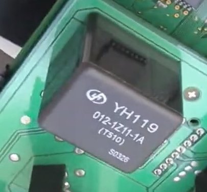

Perfect. I will get that done. No problem about the soldering. I have done it before. I just need to make sure I get the right relay.
Relay is a YH119
Does anyone know where you can buy this relay in the UK and not a copy.
I have checked on ebay / amazon. Imported from China.
Thank you all
Relay is a YH119
Thank you all

Re: Central Locking Problem [With VIDEO] - Could it be the relay?
The originals were shi...not good, so how could the Chinese ones be worse??
They (originals) should be available from RS and Element14.
