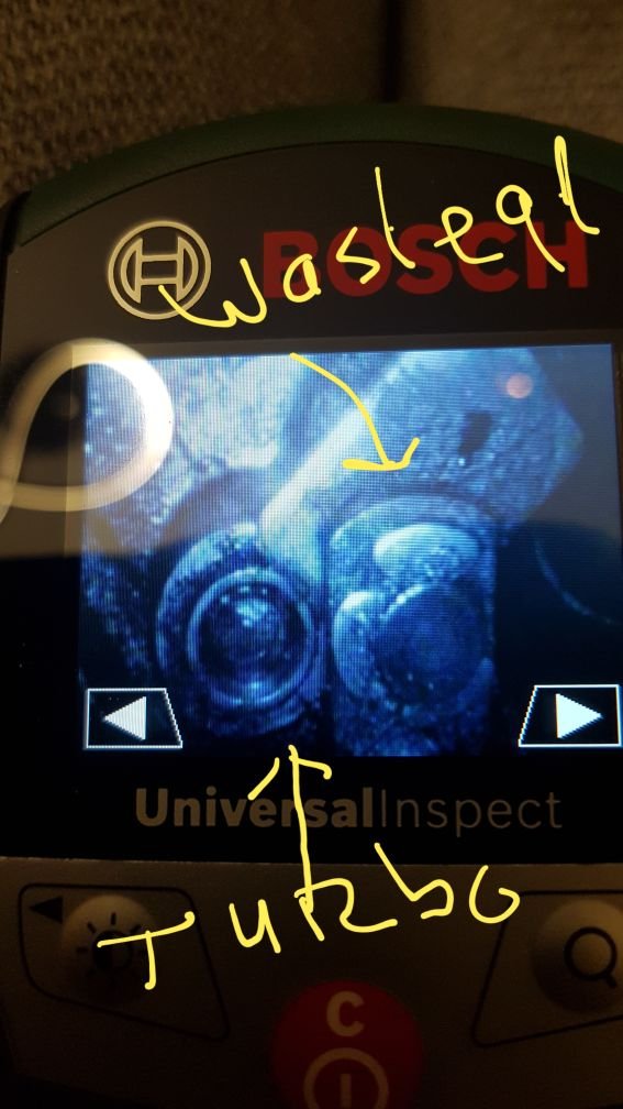

Good afternoon, after an error code P0299 I went to investigate.
I checked the vacuum system and checked the vacuum valves and everything else.
No probleem found.

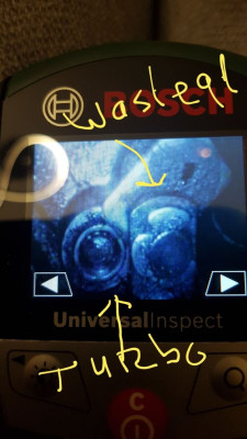

When I pulled the vacuum on the VC2 wastegate I heard a metal sound, kling kling....
I looked with a small inspection camera and fiddled with my hand and found the problem with P0299 code.

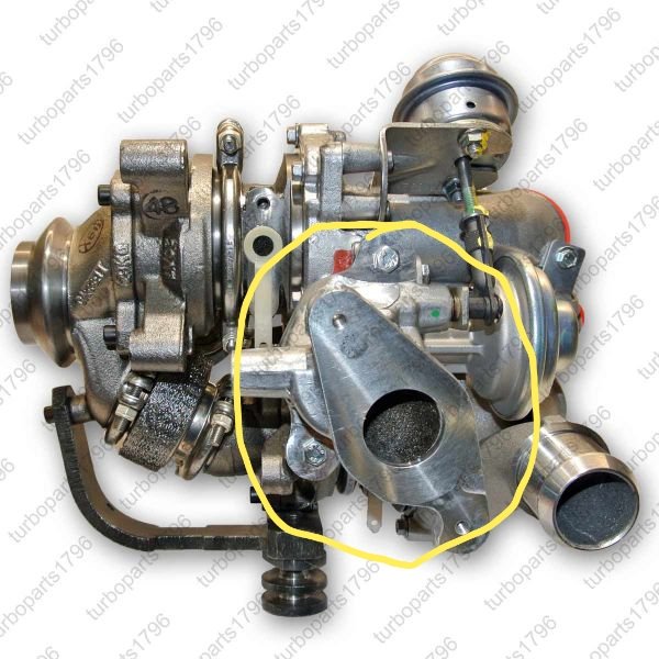

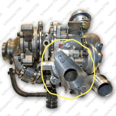

A small plate is broken off on the turbo, VC2.
small plate that is broken off on the turbo 🤔
Does anyone also have this experience with the 2.2 Twin Turbo 125 kW?
