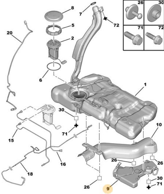

Citroen C5X7 2014 RHD Vin: VF7**************[VIN obfuscated, can be read by forum staff]. Can anyone advise me where the location of the EOLYS tank/reservoir may be located. How may litre capacity? Type of fluid required? Reset procedure? Refill procedure? Thank u.

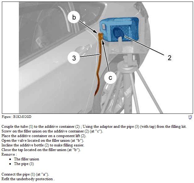

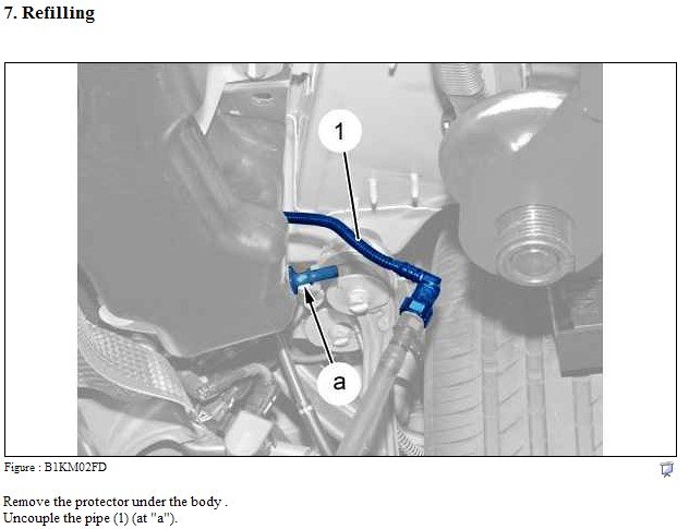

You need Eolys EXTEND for this vehicle, a 3 Litre kit should be plenty & comes with the filling kit.
You fill it with the kit by gravity feeding it into the tank.
What tool are you using to reset? If using Diagbox go into the pack repair section in the injection menu & find refilling additive, just follow the prompts.

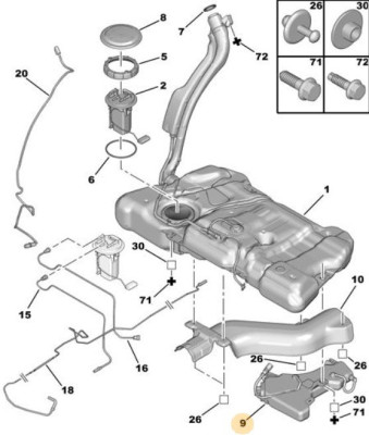

The tank is located next to the main fuel tank at the left side of the car (number 9 in the picture)
