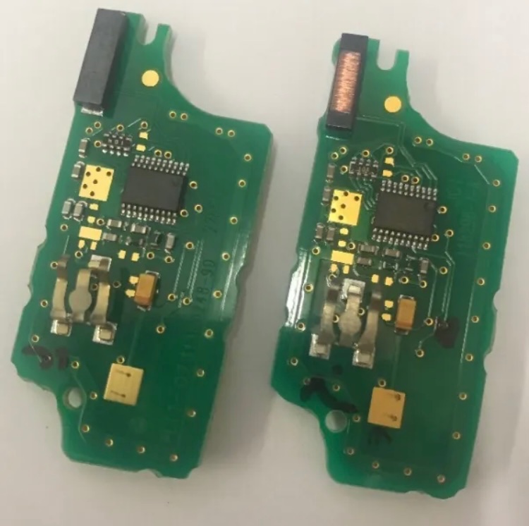

No, using "remote controls" from other Peugeots.Are you using blank virgin chips? not all ID46's are the same, they need to have the correct logic on them or they may not program.

Are the remote controls brand new & unused?

Used. So you are saying that the transponder code is not stored in the ECU, but rather that the code is stored in the transponder?

The transponder locks to the car when programmed, it will only ever re program back into the car it was originally programmed to.
They can be reflashed & virginised with the right equipment but apart from that you need to use new & unprogrammed remotes or chips.
Used remotes will be causing the error message.
