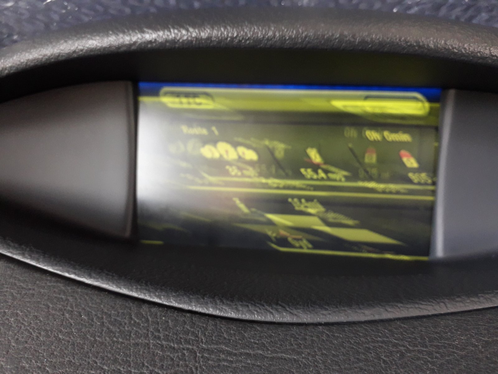

Here is a challenge for those knowledgeable on Citroen/Peugeot electrics! Good luck. Under what fault condition could the following occur, both intermittent and neither reproducible at will; both on battery power, NOT on alternator?
1. The front accessories socket (supplied by the battery), continued to show 3.6V even after removing its fuse. Replacing the fuse recovered the voltage back to battery voltage. Later, it measured battery (fully charged -12.5V) and alternator voltage (14.5V) correctly.
2. At a different time, when turning the key to position 1, the socket began at battery voltage for a few seconds, then began to climb to 14v, 15v, 16v, 18v over 3 to 5 seconds until the voltmeter (set at 20V range) gave up. I turned off the key rapidly. I reset the voltmeter to 200V range, and tried again. This time, it displayed battery voltage and stayed there.
This happened a second time, but this time when I was measuring the input voltage to the 22SY451 (the colour MFD screen / display ecu). On all other of many attempts the input was correct, both on battery and alternator.
It would appear the entire power supply is intermittently over-volting, WHEN ON BATTERY ! So, how can the car deliver 20volts plus (and climbing), when on a battery of 12.5V ?
I suspect this has caused a couple of 22SY451 ecus to fail, each one lasting several months / few thousand miles. After months of perfect operation, the symptoms started with an intermittent distorted screen picture. This often occurred on turning on ignition, before engine start. Indeed, on several occasions it could be cleared by several attempts of tuning the ignition off and on again. However, eventually the screen goes blank, terminally. It may be that the ecu can withstand several episodes of random over-volting before finally giving up. But then again, I am unaware of any other system having problems, even those using the same supply fuses and earth points. Perhaps the 22SY451’s over-voltage and transient voltage suppression (TVS) is not as good as other systems.
As a “sticky plaster” solution, I will fit a suppressor across the battery (eg Kemo M168). I will also fit a voltage limiter across the power supply pins to the 22SY451 itself eg varistor or TVS diode to clamp the its input. That may protect the 22SY451, but there is clearly a wider fault somewhere!! Any guidance would be most welcome. Pretty please
C5 Mk1 - over-volting - a challenging problem for electrical experts !!

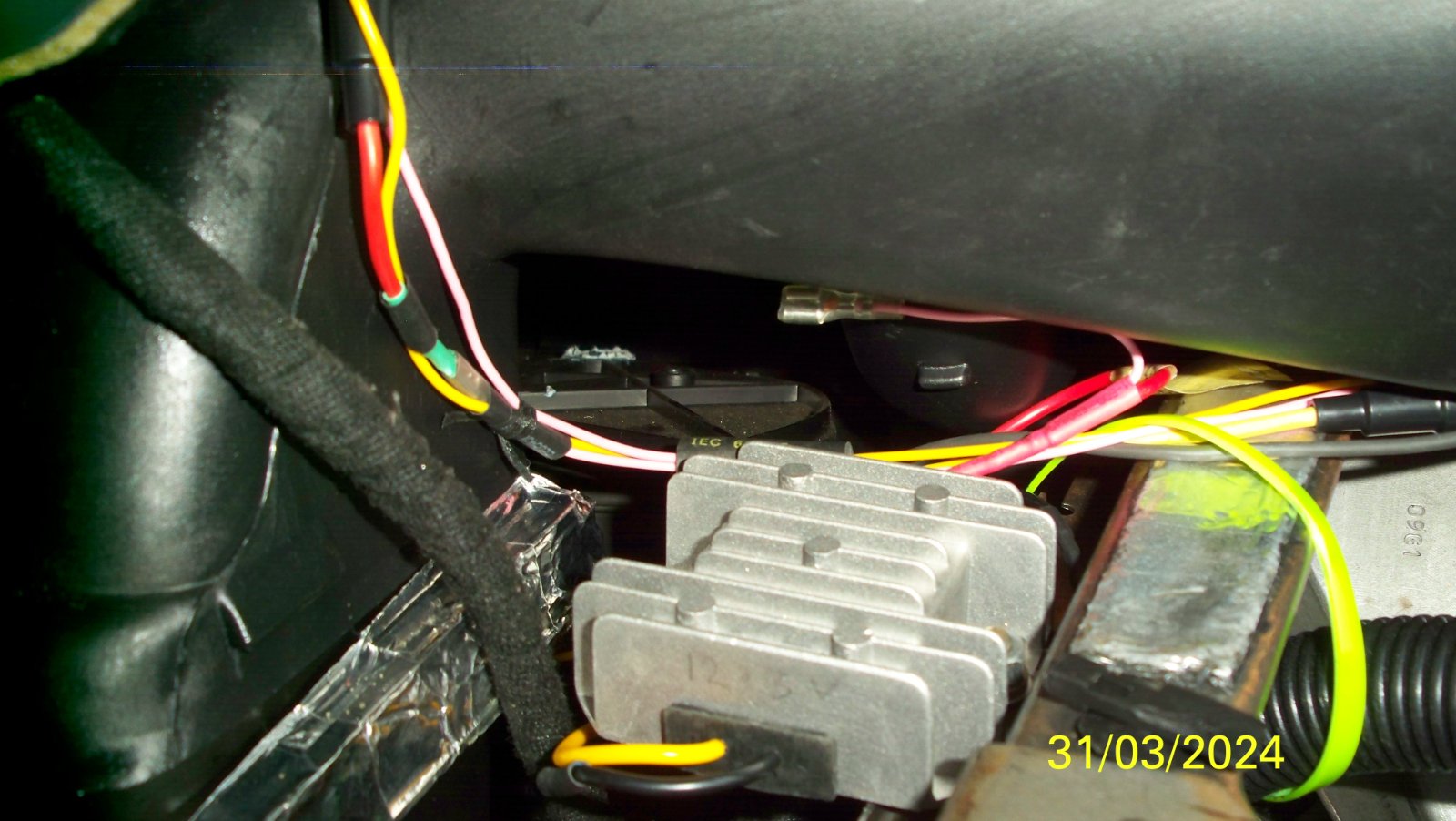

Update. Fixed…to a point
The primary prompt for this thread was to determine whether irregularities in the electrics was causing distortion of the MFD (Multi Function Display – 7in colour screen) picture and eventual failure. The fault lay in the driver ECU for the screen, the 22SY451 module. I went through 3 second hand ECUs. Each one worked fine for a few months, but eventually causing distortion, a yellow tint and ultimate failure.
I have now fixed that issue by inserting a regulated, fully protected, stabilised DC-DC converter (Fulree FW32D12A3) into the power supply for the 22SY451, with further protection by inline 3A and 5A fast-blow fuses, and an independent power button. Previously, on ignition, the screen would power up distorted at least 50% of the time, and if not, would distort after an hour or so. Now, I manually power the screen/ECU AFTER the engine has started, and the screen has been OK for months. There is intermittent yellow tinting, but much less. Notably, the 5A fuse has blown twice reinforcing my conclusion that voltage transients or other irregularities were affecting the 22SY451. On the other hand, it may be that the transient protection built into the 22SY451’s circuitry weakens with age, or a combination of both.
I will post more details shortly on a separate thread dedicated to the MFD and 22SY451 (also fitted to Peugeots, and C6?). I now wonder whether other electronics are vulnerable, due to age?
