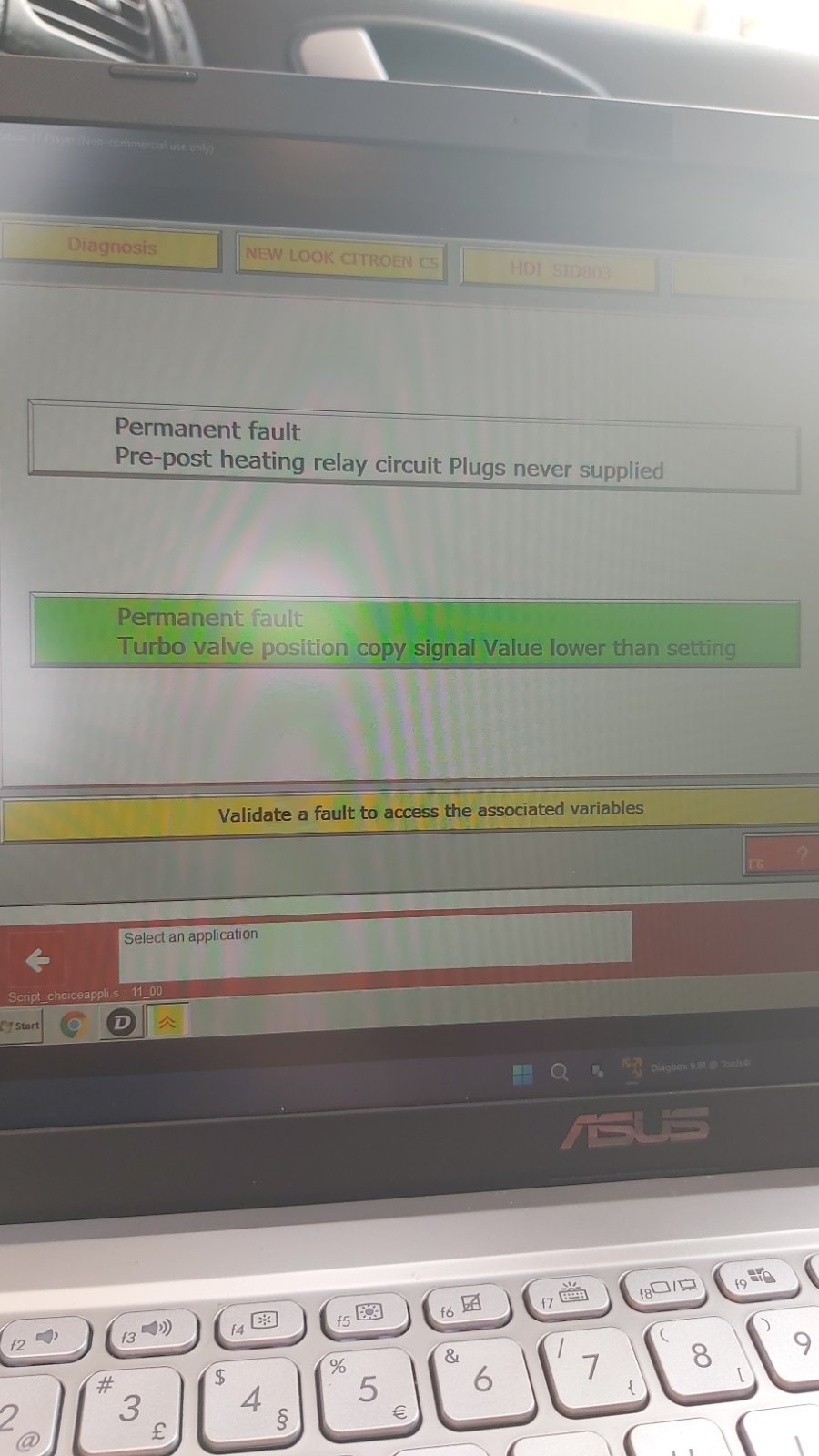

Hi experts, i read a couple of threads on this error, but did not come closer to the solution. Hdi 2.0 136hp.
I had something like this happen before, i replaced the valve that's in the "back" of the engine, that controls the vaccum to the turbo.
Car went fine for 3 months or so. Skipping to now, i lose turbo very quickly.
Connected lexia to check turbo pressure and there is a big difference between "required" and "achieved". Pic attached.

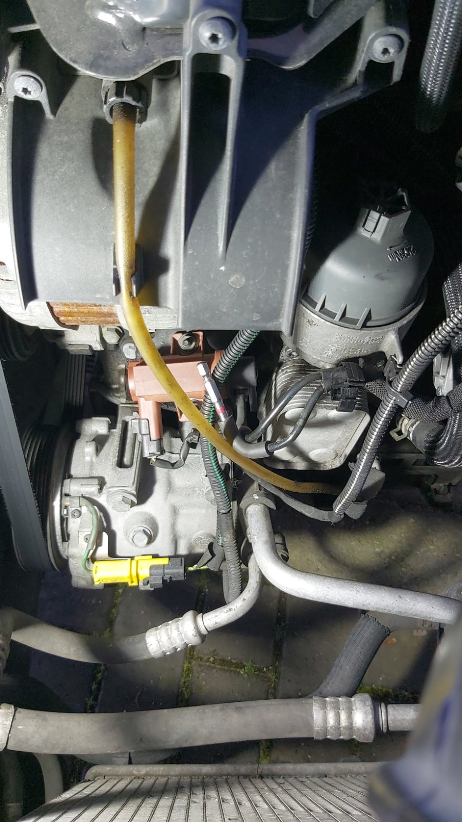

There is another valve, that's closer to the starter, under the diesel filter, seen someone say that one could be the culprit.
Opened the filter, and the sponge was totally broken, cleaned out, put a new one, no change, also the pipe was not blocked with any pieces of foam.
I did test the valve with a manual vaccum pump, and it leaks, isn't it supposed to hold the vaccum?
There's no change if i apply 12v, the other one i replaced also did this and leaked through the body, in the coil side of the valve..
P2562

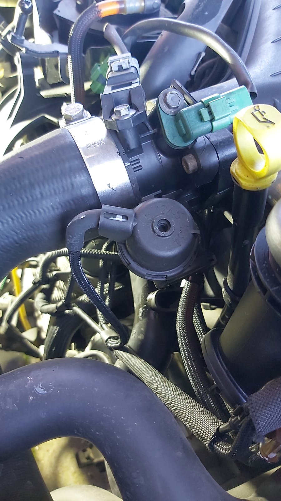

Oh my god! i got boost again! Now it all makes sense! So i basically plugged the vaccum line that goes into the solenoid that is under the fuel filter, this controls a butterfly valve in the intake, above the starter.
I have watched a video where the person explains about the intake of this motor, but there was a difference, in his car, this butterfly valve serves to bypass the intercooler, there was another pipe that goes direcly from the turbo into the intake, but in my car, that pipe doesn't exist, so i started to think maybe there is an obstruction, maybe this butterfly valve is closed.
Then i remember that when i applied vaccuum to the electrical solenoid, it would not hold the vaccum at all, then it clicked, if it doesn't hold vaccuum, the butterfly valve is closing, it's closed at all times, because the solenoid if allowing vaccum to go through, so i plugged it and now the butterfly is forced open which is it's normal state, and i have boost as normal!
A few questions remain, like, can i keep this plugged? Does it harm the motor? What purpose does the butterly valve serves, if there is no bypass anyway? Is it a left-over from a slightly different version of the motor?
It doesnt make sense that they would leave this in without a purpose..

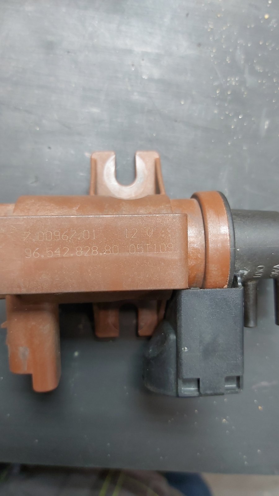

The pictures show the valve i replaced, to make it clear, i bought a new one, going off of those numbers that the old one has.
One picture is from the youtube video, so you can clearly see the pipe there, whereas on miine there is none.

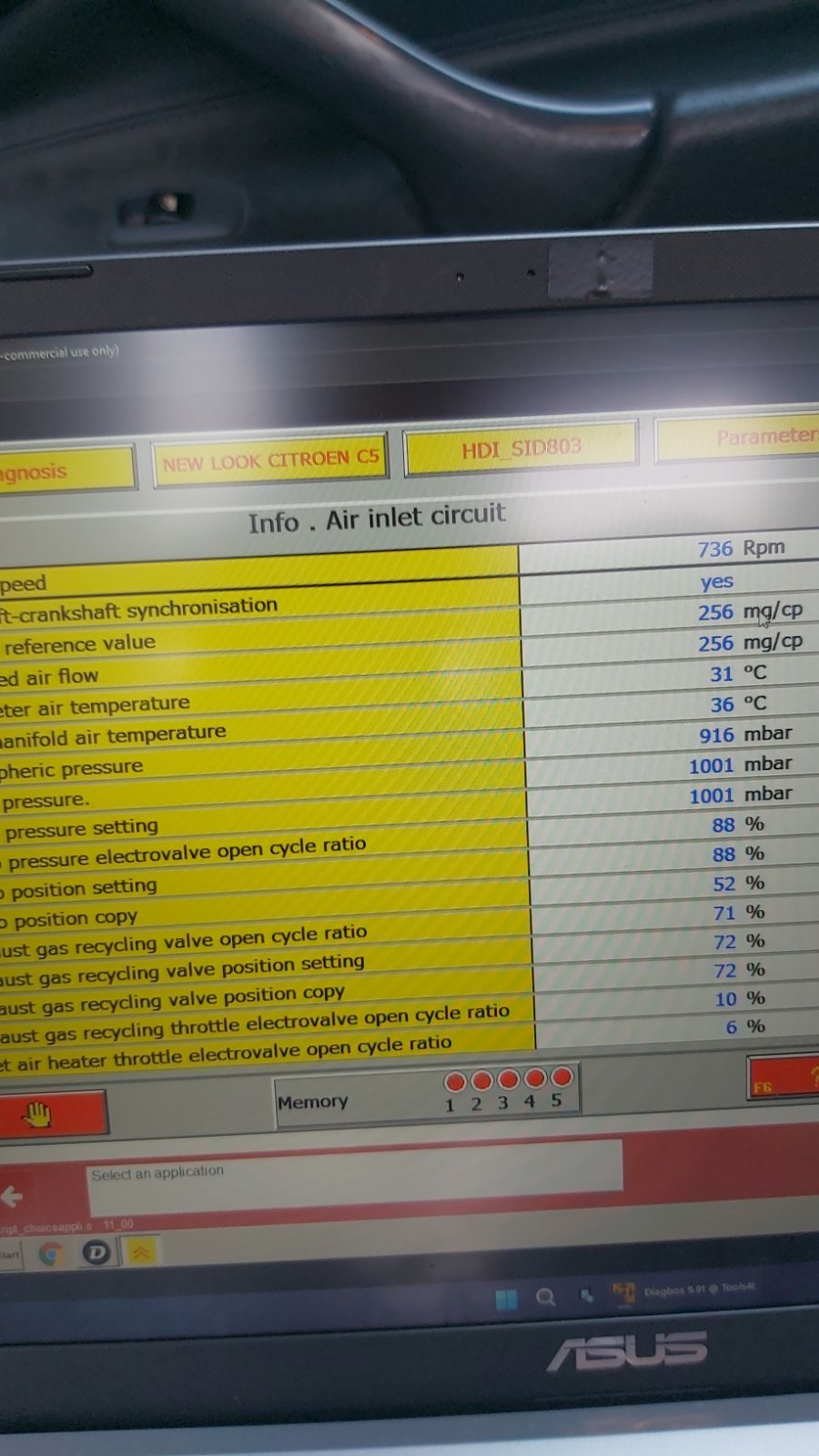

Hi there! unfortunately the car is at it again, with the same error, just needed a bit more driving to set it off i guess.
Going by what @GiveMeABreak posted about the error being set off by a 30% difference between the two, "turbo position copy" and "turbo position setting",

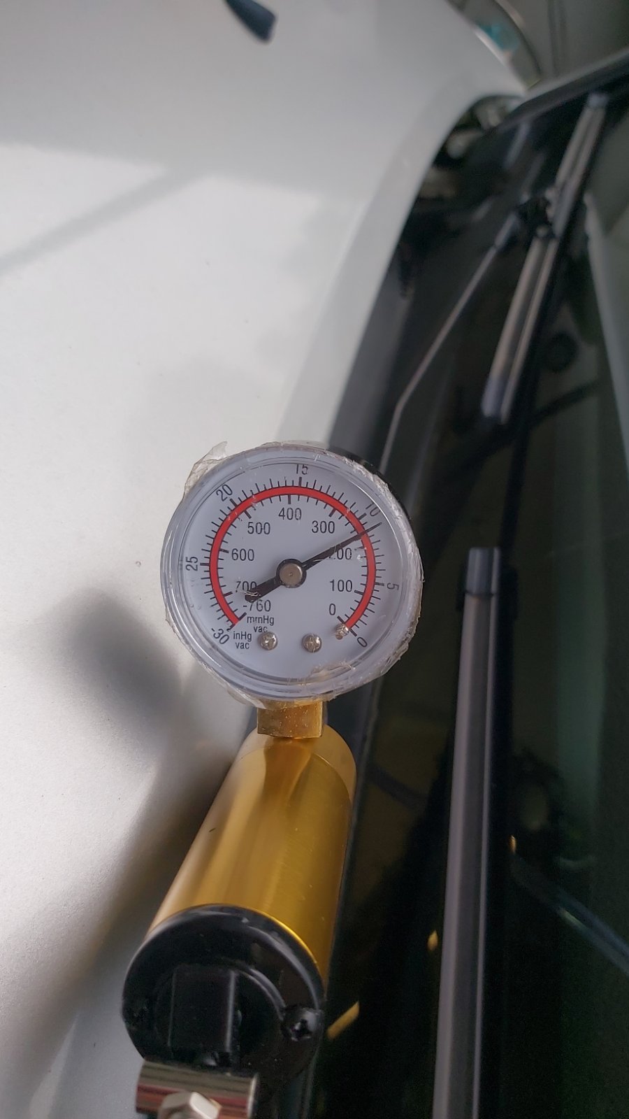

i did some more tests, i placed a vaccuum pump with gauge on a T connected in the vaccuum line that goes between the solenoid exit and the turbo, to check for how much vaccuum is going there, which is what it shows in the picture at idle. Around -0.3 bar.
The turbo solenoid is a new valve, has maybe 2 months, and it holds vaccuum very well on the bench while closed.
I'm at a lost as for what i can do next, it seems it's the ecu that is doing this and opens the valve too much,
cutting off the vaccuum that would increase the turbo position, ergo, pressure.
My question is this: Should the "turbo position copy" and "turbo position setting" values be similar at all times?
Or does it only matter above a certain rpm or demand?
The picture is at ok/idle, when in limp mode the "setting" value goes to zero and the copy goes to 10%.
