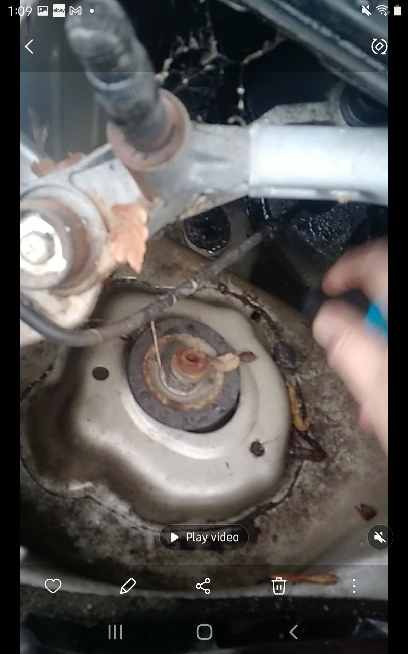

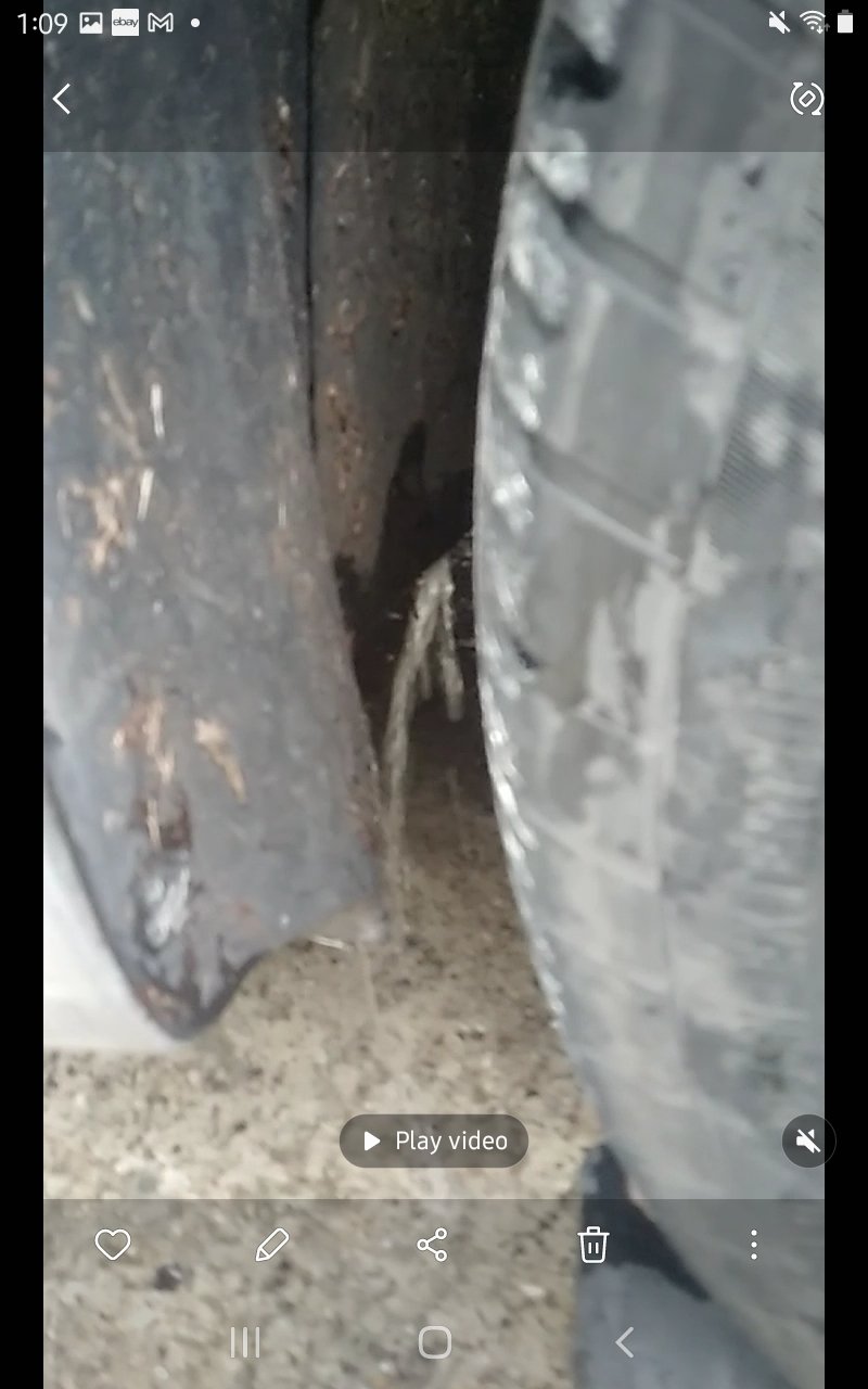

The knock , clunk, rattle was a lose top nut on the front suspension ! Which in turn was making the large washer vibrate against the body the rubber sleeve was off the washer so i undid the top nut took the washer off popped the rubber sleeve back on and pounded up the top nut with the weight of the car . This is when i also found a duck pond due to the drain holes being blocked .
Husky.

Re: Citroen c3 picasso
The water was almost touching the highest point of the suspension, notice the top washer and the gap this now looks different as i undid the top nut , sorted the missing rubber that fits on the washer did the nut back up , lowered the car so it was sitting on its own weight then tighten the nut to its spec
Drain hole unblocking .
Remove wipers note there sitting positions i took a photo with my tablet. Remove rubber strip that pushes into the scuttle panel lift panel upwards it un clips from the bottom of the window screen jiggle the rubber parts on either end to be able to lift the panel completely out of the way then your have a very clear view of any duck pond ,there's one bung on the passenger side and 2 on the driver side my pollen filter was wet very dirty so I've got one on order , my water level wasn't far from the air in take part ! My wiper nuts were 17mm
