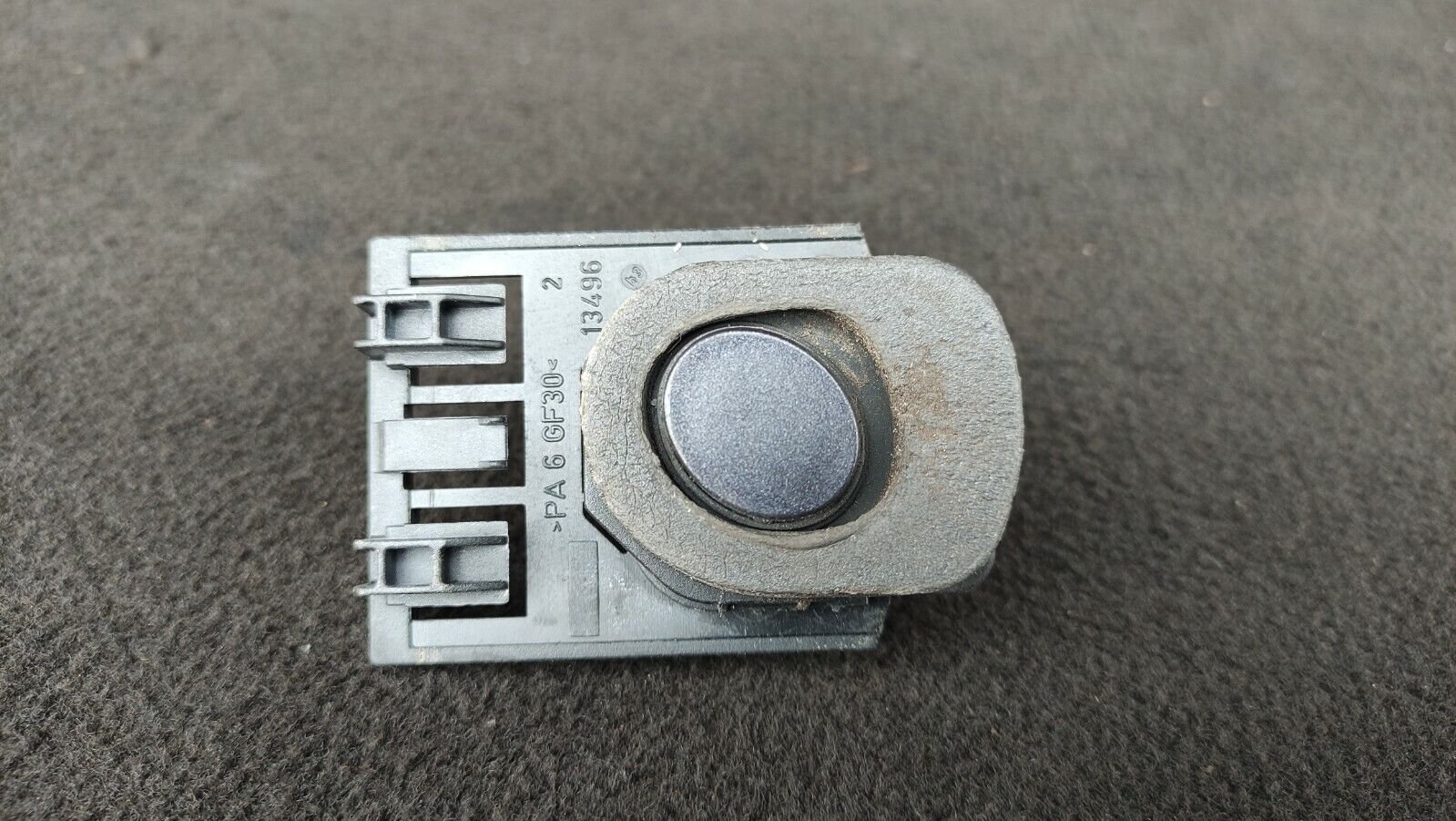

I recently bought a 2004 Peugeot 407 2.0 HDi (4-door sedan).
I've noticed that the button to open the boot/trunk does not work.
Remote works ok, locks, unlocks and opens the boot. I've already removed the button and checked it with a multimeter, when I press, there is continuity between the two wires on the button, but when I press it, nothing happens. I've also tried jumping the contacts of the wires, but nothing happens either way.
I've noticed that the wires are connected to a control module (two wires to the button and three wires to the trunk lock). I've tested all these 5 wires, they all have perfect continuity, but the button on the key fob works and the button on the lid does not.
Is there any configuration in the car computer that disables the opening from that button? Could there be something I can try?

The wires connect to this box.
All the wires have continuity from the tailgate to the body (all of them connect to this ECU on the left side).
