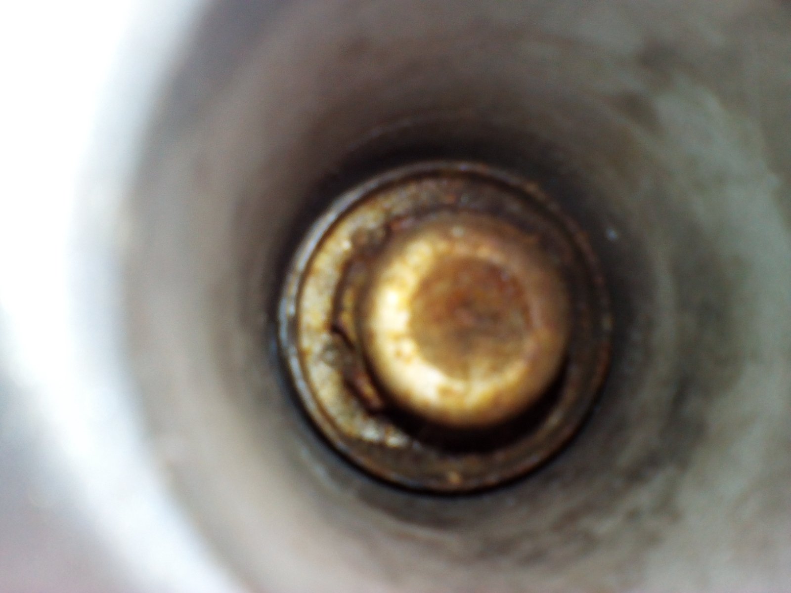

Rp0thejester wrote: 16 Dec 2023, 06:21 I can't believe people still use locking nuts, what a faff they are! I had mine round off so got a friend to weld a bolt onto them, worked like a charm.
That's why i don't use or want them there off mine now thank god. For me the design is just to weak plus the mechanic with his rattle gun don't help either as by my photo these bolts should be labeled unfit for purpose
