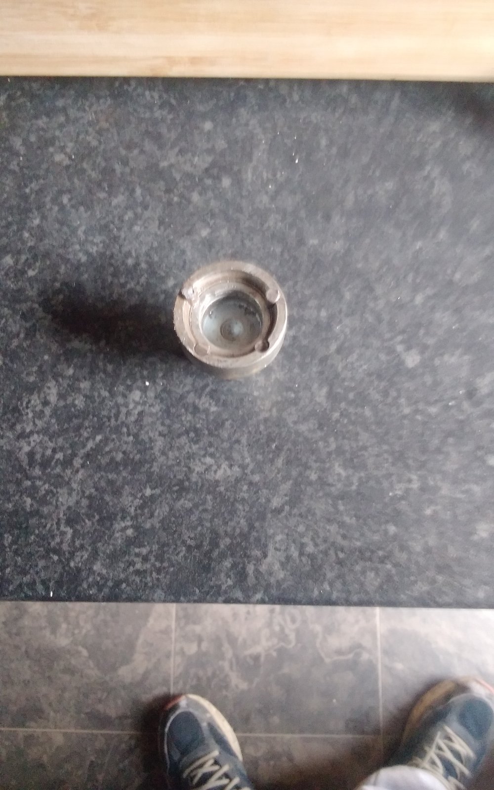

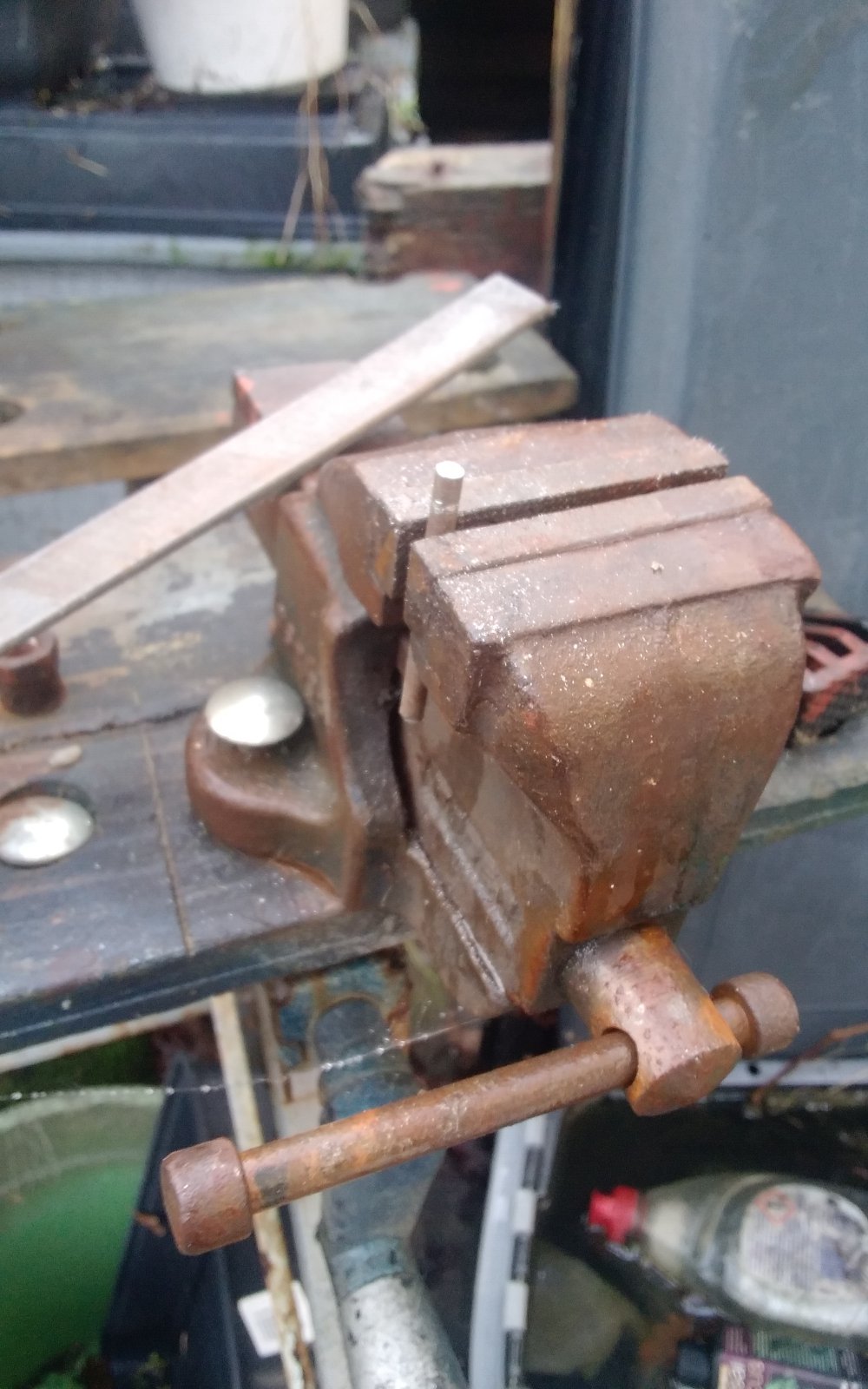

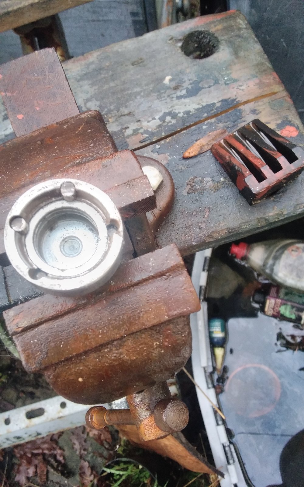

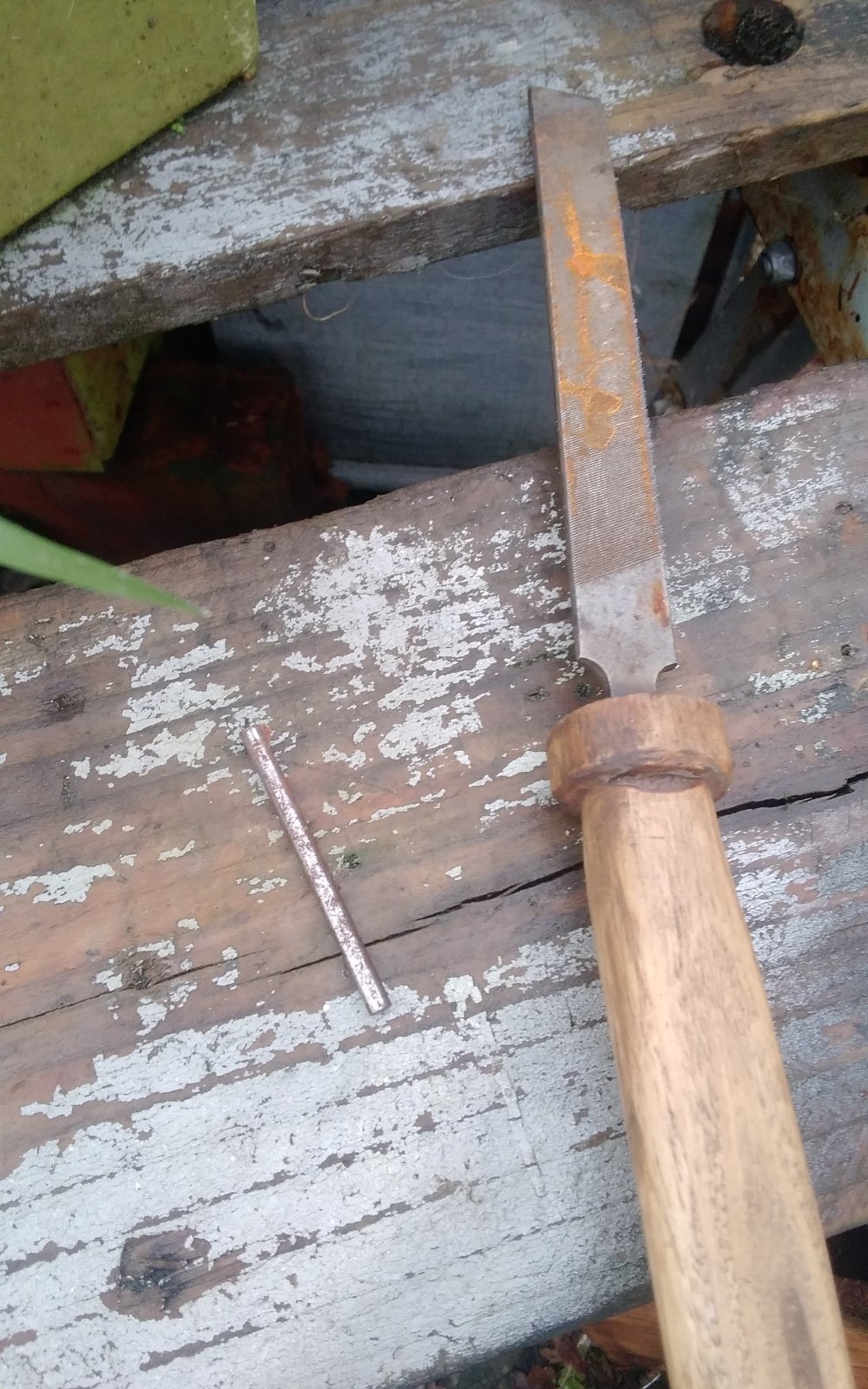

Need to get my rear wheels off for 2 new tyres .. Guess what .. yes the locking key is ruined . Read the history of the car it was advised by the same garage that used to service the car but the idiots didn't bother to renew it ! So i made new pins
Did it work ... no

Thanks Jim , Today has been odd finding out my locknut key was duff was alarming . Finding the cost of a mobile chap to remove them was EYE watering 400 quid ! No i didn't go that route, i went to Citroen spoke to a lovely mature gent whom works in the parts dept. Told him my predicament he then informed me it could take 10 days to get one in to which i sunk low & went ok i can wait. He then went into the back of the shop & returned holding something which turned out to be a key someone ordered but never picked up same code too,so he gave me a discount and charged me over 100 quid !! .. heres the intresting bit he then started winking saying if it don't do what it should your very welcome to come back today for a full refund ,, wink wink wink.
So off i went got back home , it fitted but slipped my bolts were worn so with a bit of frustration i used my rattle gun like i was firing bullets out of a gun ... the bolt came lose ! Only 3 more to go i did 2 the same gun fire way ,it worked then great findings the last one was replaced with a normal road bolt
I then went back to Citroën to check prices of road wheel bolts before i could say any thing the same chap dealt with me again saying oh well mate at least your tried , i will issue a refund and he winked again , he whispered did it do the trick i said just about he then winked again did the refund and bid me a good day !
