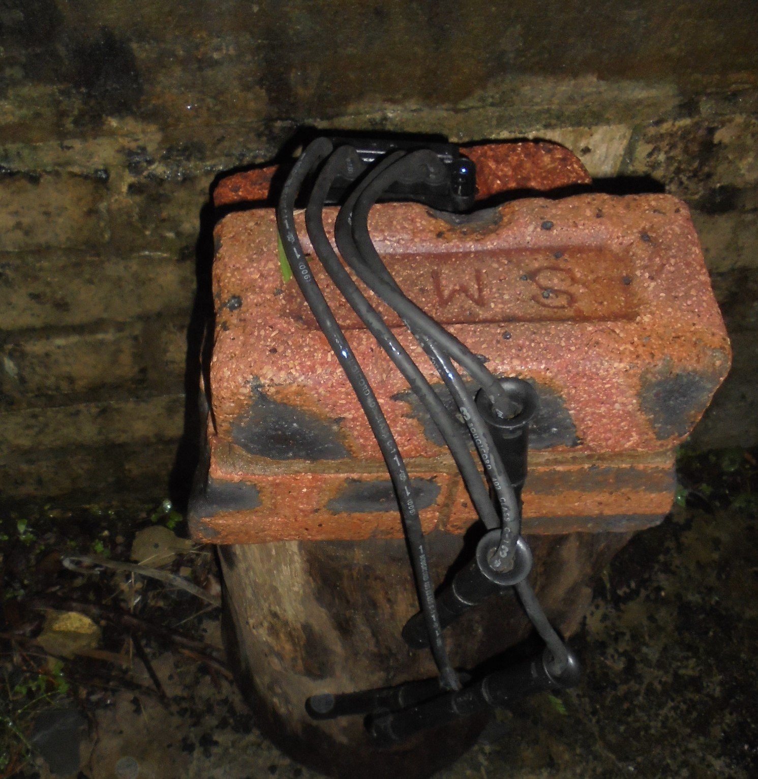

Never got round to engineering a summer MOT for the original 6 bottles of wine Clio so its end of February, always a decent bet for inclement weather.
Bit of prep work needed before it goes in for a test, including an inopportune throwing up of misfiring and the emissions warning light just the other day. Of all the threads on all the car forums, those which have "misfire" in the title are the ones which more often than not, turn into sagas without the problem being "solved".
Well, after a bit of amateur investigation this 20 year old part was replaced with a brand new one and for now at least the previous misfiring problem showed no signs of recurring on a decent 10 miles of dual carriageway at speeds up to 70mph and round town stop start driving.
The Clio is a very decent car, with fairly well known little foibles particularly on the electrics side. Would be nice to keep it going. Been in the Falcon fleet since December 2017 ( page 1 post 1 of the thread... viewtopic.php?p=559131#p559131 )

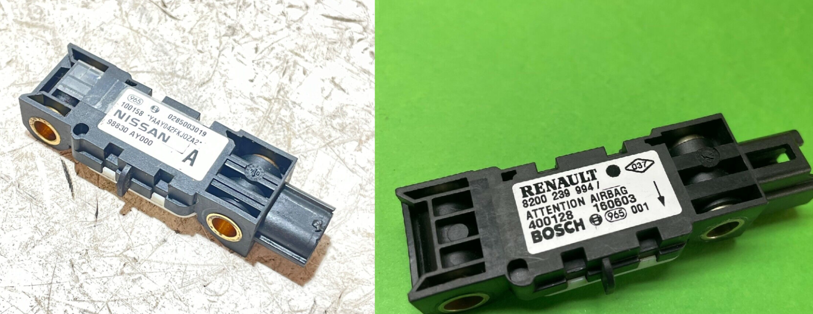

Paddling around on you tube, and taking its wisdom with a pinch of salt, one vid showed testing a two pin impact sensor across the pins for resistance, the "bad" sensor was off the scale, while the "good" sensor had a resistance of 500 ish Ohms. May be absolute rubbish of course.
The precise sensor is a BOSCH 007632 120503 (Renault Part Number 8200 239 994) Can't find any horses mouth details of resistance values of the sensor. I'm guessing this is what the ECU self-test will be measuring every time the ignition is switched on.
- Posts: 26421
- x 7164
Re: Bargain Basement Motoring
These look remarkably similar, and may be more commonplace now, and maybe some use in testing. Indeed I have them in the Micra.
I expect the same sort of side-impact sensor was used across many vehicles within the Renault stable, and also across other manufacturers.
Absolute paucity of information and cross referencing though.
I think a scrapyard expedition may be on the cards.
