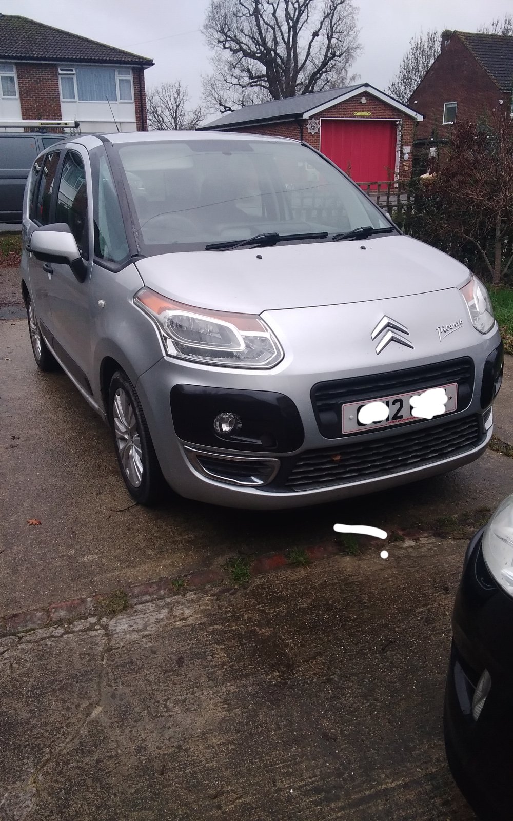

Citroen c3 picasso.
Why did i do it. Well needed abit more room but not massive ammounts so this was my choice
2012 1.6hdi. New clutch last Jan 2022. Plenty of service history and under 90,000 miles .
Bad points.
Back fog light cracked car park marks
Warning on dash after 90 mile drive
Engine oil pressure high stop engine
This then came on every time i slowed down
Then cleared on accleration, no smoke no engine knock ticks over perfect. This morning i popped an engine flush into a warm engine ran it for longer then directed i wanted it to really push some gunk around, then drained it. It looked like there was way to much oil in it unscrewing the sump nut by now you know when it will stop its flow of blackness , this just kept flowing ! My oil drain pan is 16L this got to about half way full !
I also did an old fashioned flush petrol mixed with oil about half a litre injected into the oil filter lifter turn with a syringe to clean the mesh at the end of it and some into the oil filler cap hole this will be left to soak for a few hours over night to clear any crud cant wait till the morning to see how bad the last drop of mix is when it gets drained again. The oil filter looked like it had be rolled through a sand pit too.
