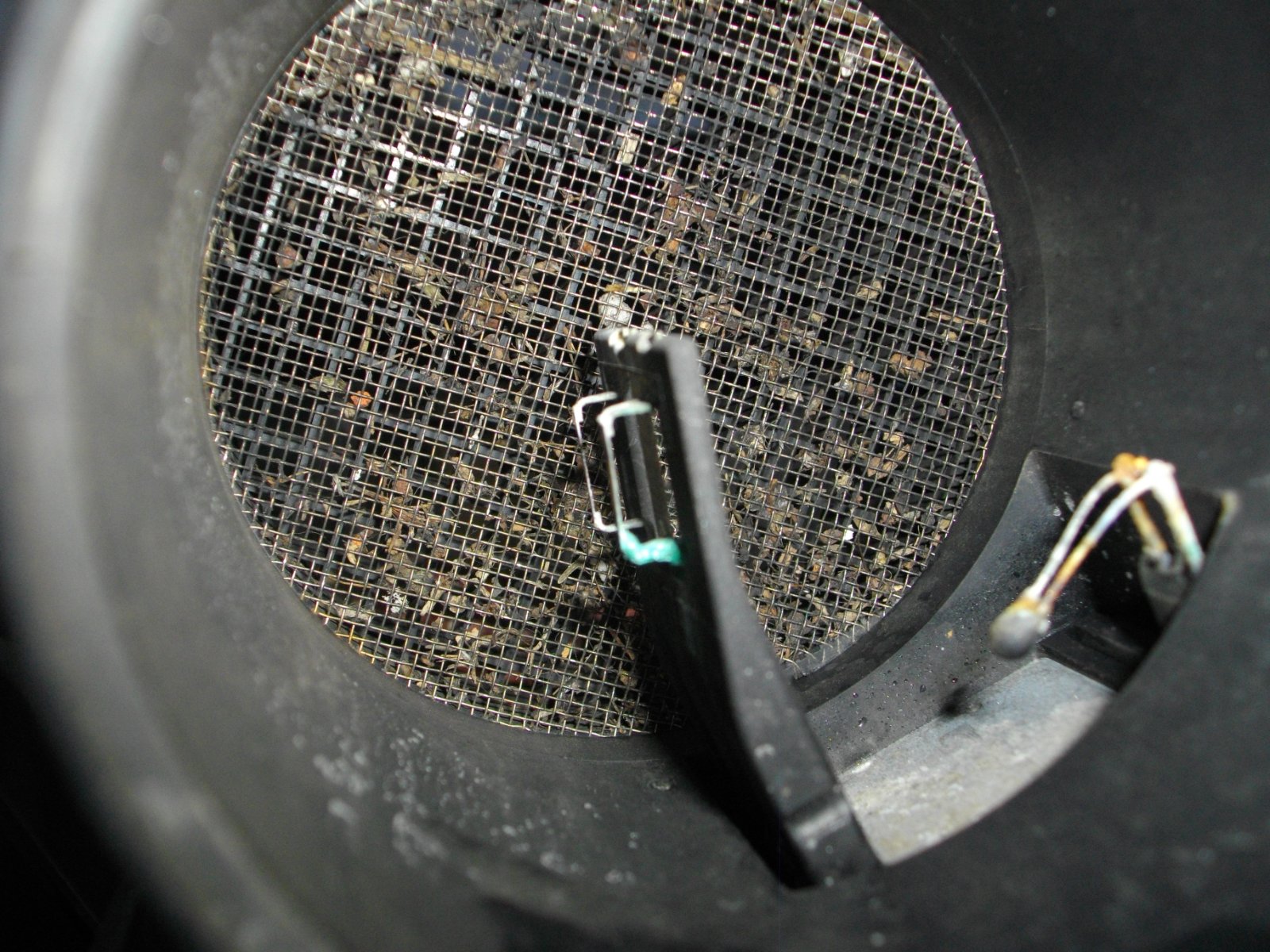

I had this on my C5 Mk 1 when the wheel arch liner exploded and the induction hose that is normally behind it sucked in lots of water and grit, ruined the MAF and the air filter, the horn on the filter box was full of muck and water.
You might rescue the MAF with a carb cleaner spray. Be very careful with it as they are very delicate, drop it or touch the fine wires with anything and it is wrecked.

Re: C5 Mk 1 drove into a flood resulting in immediate fault messages
If waters got on the MAF sensors then that's toast, can't touch them let alone get them wet. When I unplugged mine it also removed the DPF blocked warning and gave me power back. I'm assuming the lack of input from the sensor made the DPF think there wasn't enough air flowing through so it must be blocked.

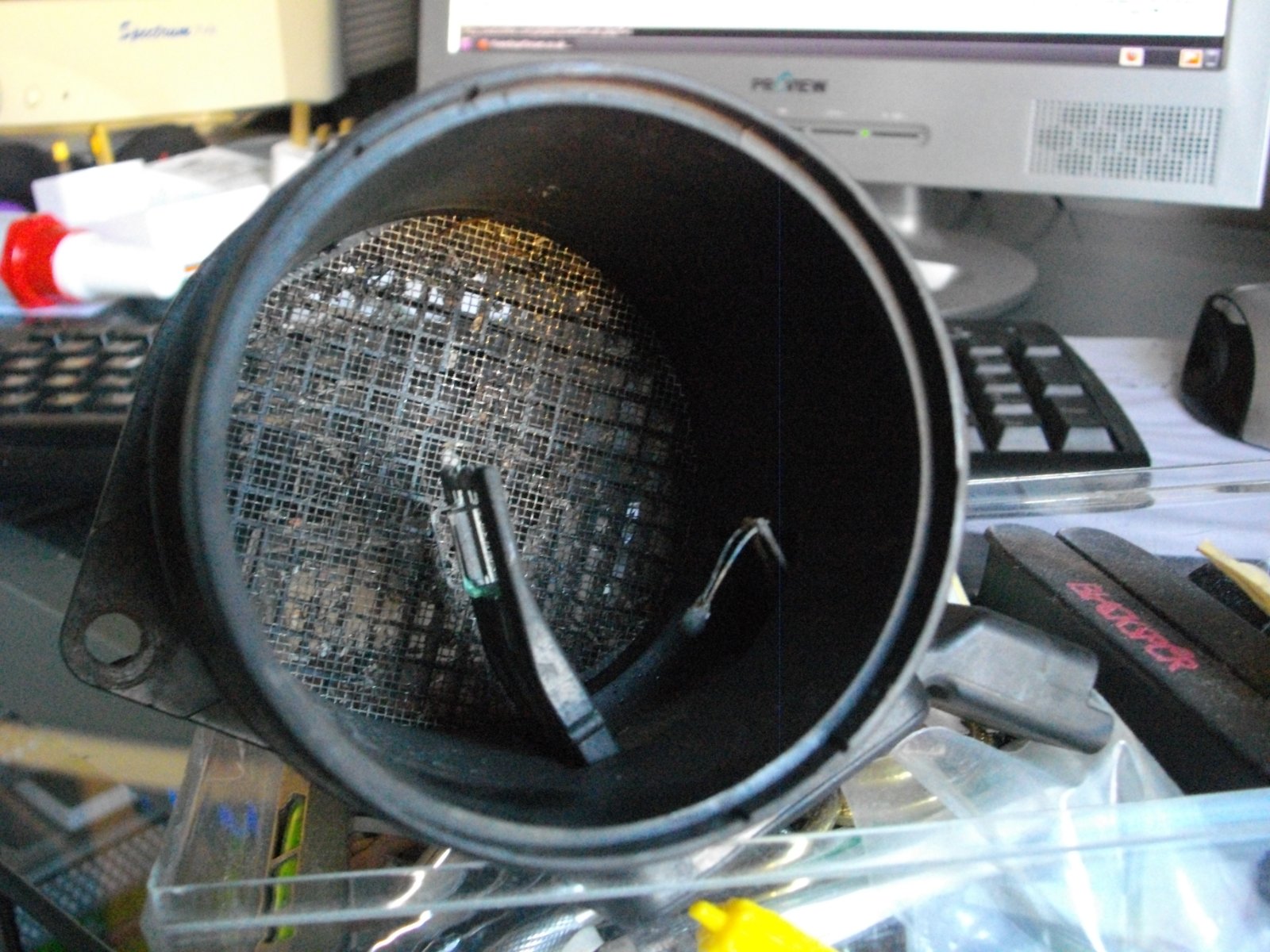

- Posts: 28639
- x 5652
This was mine after being drowned.
(I wondered what the thing with the red writing on it was. A Blackspur multitool that had been my dads. It is still on my desk
