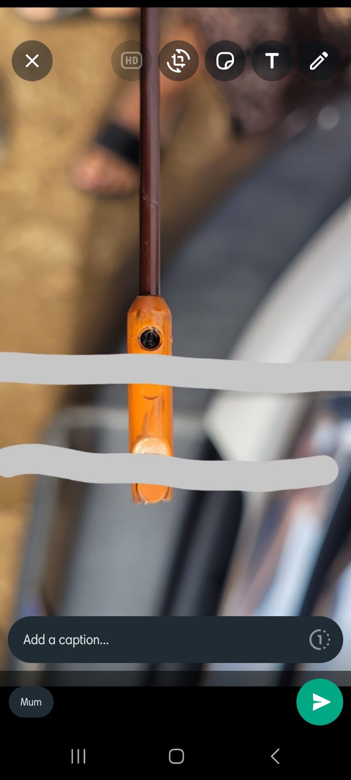

My follow up then would be how to check if the oil on the dipstick is sufficient. As I have zero knowledge of that and so don't even have a baseline.
The manual has the upper gray as the max and lower gray as the minimum.
I have taken the dipstick out. Wiped it. Inserted it. And this is the result.
Should the dipstick be covered in oil up to the maximum. Therefore I don't see any orange at all? Or is this an okay reading for the amount of oil I have?
Sorry to ask such basic questions. But yeah. I don't really have anyone or anywhere else to ask for help.
Thanks again so much.

I should add. There is no message. Just Oil -- and it blinks.

The oil level should be between the MIN and MAX, but never exceed the MAX. If the oil counter continues to read OIL flashing with dashes, then you need to have it looked at by your dealer.

Okay. I shall check again when I start the engine. The smear I have on the dipstick, would you assume that isn't enough oil then?
This smear reaches the max level. But it is just a smear. I am not sure if it should be more than a smear or covered completely to the max?

I can't see from the photo. Make sure the vehicle is on level ground before taking a reading and check 10-15 minutes after you have shut the engine off or before starting.
As long as it is between the levels it will be fine for driving until you get the issue checked out.

I posted on the Citroën reddit and someone said the dipstick itself is broken????

If the dipstick was broken you would of lost the lower part in the tube - so can't possibly be that as you have the yellow part with the measurement on.
Keep away from those places!

That dipstick does look broken.
Not sure if only Citroen offer this as a negative "extra" but I have had the same.
As you know it is plastic and I do not believe that the broken plastic tip will cause any damage as there should be a mesh arrangement to prevent it from being picked up in the oil.
Hopefully the next oil change should see it come out with the old oil.
Replacement dipsticks are readily available on sites such as eBay.
Just search with your vehicle type etc., I found a Bilstein to replace mine.
Problem is you don't know your true oil level until you get a replacement, so keep the journey distances down, only use the vehicle if you really, really have to.

I found a local citroen workshop and they confirmed that the dipstick was broken and I got a new dipstick later that day. The oil level was ironically(?) slightly above the maximum. I spoke with a mechanic and he said that the amount for being over the maximum level would not cause any damage.
I asked about the oil-- and they said it might be a broken sensor. Or it might be that the level is slightly above the maximum hence why it cannot give an 'Oil ok' message.

I stand corrected in that case - but it was hard to be 100% certain as to the type of dipstick fitted and when I had a check on parts there are multiple versions of these in different shapes and length, but seeing as the yellow bit was intact, it may be that you have a different type. You didn't mention the year and engine / model etc. and I don't have your VIN, so couldn't do ore than a cursory check.
Glad you have had it confirmed properly at a garage though.
