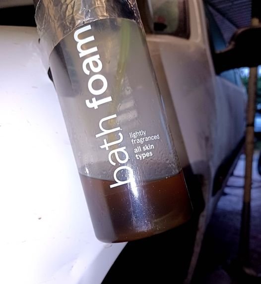

One man Brake bleeding....
Clear bottle with the tube in via the cap to the bottom (we all know this "trick"), .........BUT....with a magnet taped to the bottle to keep it High (attached to the wing) and prevent spillage.....
(The fluid was only 2 years old !!)

I tried that on my Reliant Rialto but the bottle kept falling down!Stickyfinger wrote: 09 Dec 2023, 15:41 One man Brake bleeding....

Scary how quickly that looks to have deteriorated
mickthemaverick wrote: 09 Dec 2023, 15:44 I tried that on my Reliant Rialto but the bottle kept falling down!![]()
Also, for the initial bleed/flush I have a vacuum bleeder. Trouble with it is that it draws air in via the nipple threads so after pulling a load of fluid through you then need to finish off in the traditional way.

Bit of PTFE tape on the nipple threads?CitroJim wrote: 09 Dec 2023, 16:39Scary how quickly that looks to have deterioratedI know it was only just over two years old as I was the person who did the full fluid change. It was a full one too.
Mine's a one-way valve into an old peanut butter jar

I always put PTFE on the nipple threads, It stops air being pulled in and also helps to stop nipple seizing in

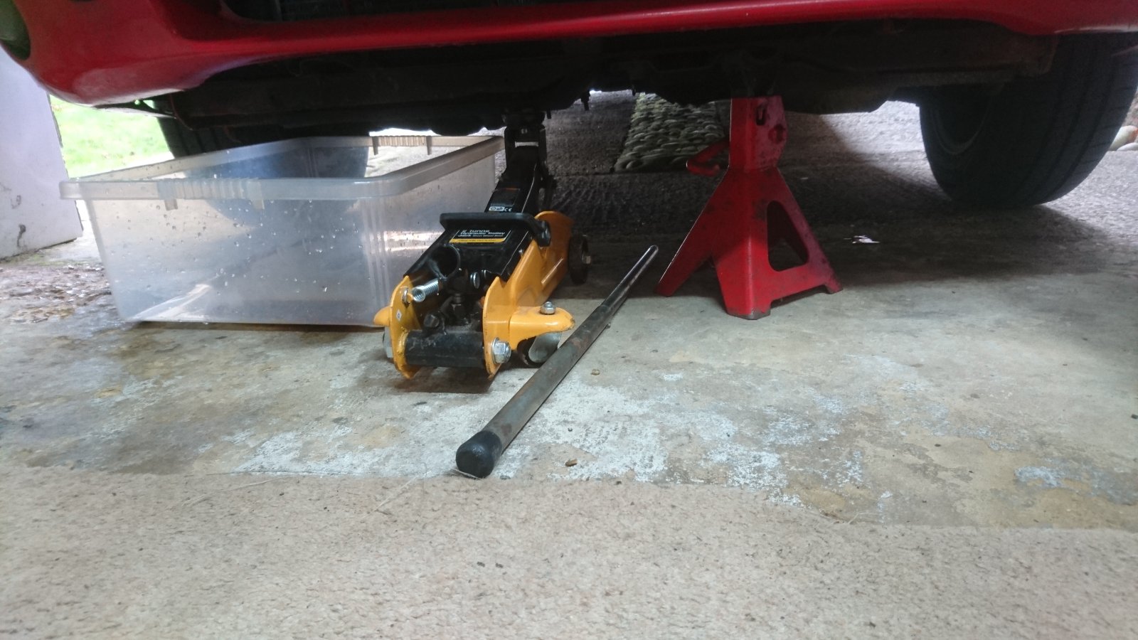

So having sorted my bedroom radiator, as reported here, I set about doing the MX3 radiator flush and refill.
I was going to put the car on the ramps but having found a new drainage container I only needed to raise the car an inch so I settled for the trolley jack under the front crossmember and then an axle stand:
With the wheels still on the ground and no need to go under the car I am happy working like that.

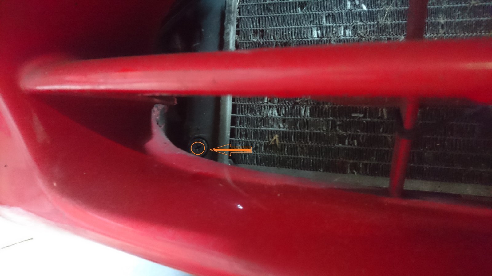

Once in position I was able to undo the drain plug which is very conveniently located on the front of the rad through the grill
The liquid that came out was exceptionally thick with gooey rusty crud which I believe was generated when I had the leak in the old radiator and was the main reason for doing this flush.

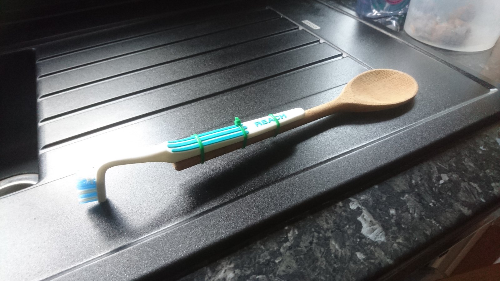

The overflow reservoir was dark brown and horrible so it was removed thoroughly cleaned, involving the adaptation of some domestic items:
which allowed me to get right into the crevices and clean it properly. As I had it out to clean I took the opportunity to mark the full and low lines with a permanent marker which makes it much easier to read and then refitted it.

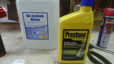

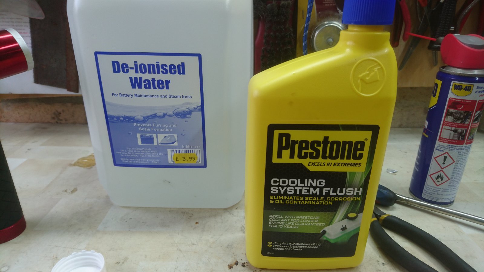

Having prepped it I flushed the system with tap water and then filled it with de-ionised water and the cleaner I have used with success in the past:
The car is now sitting on the drive with the engine running, very smoothly I must say, while the cleaner does its work. It has been going for an hour and I will leave it another half hour before draining it and refilling with my new coolant. Already the heater is performing much better with positively hot air blasting into the cabin which will have the secondary effect of drying out the recent bad weather seepage, every ones a winner!!

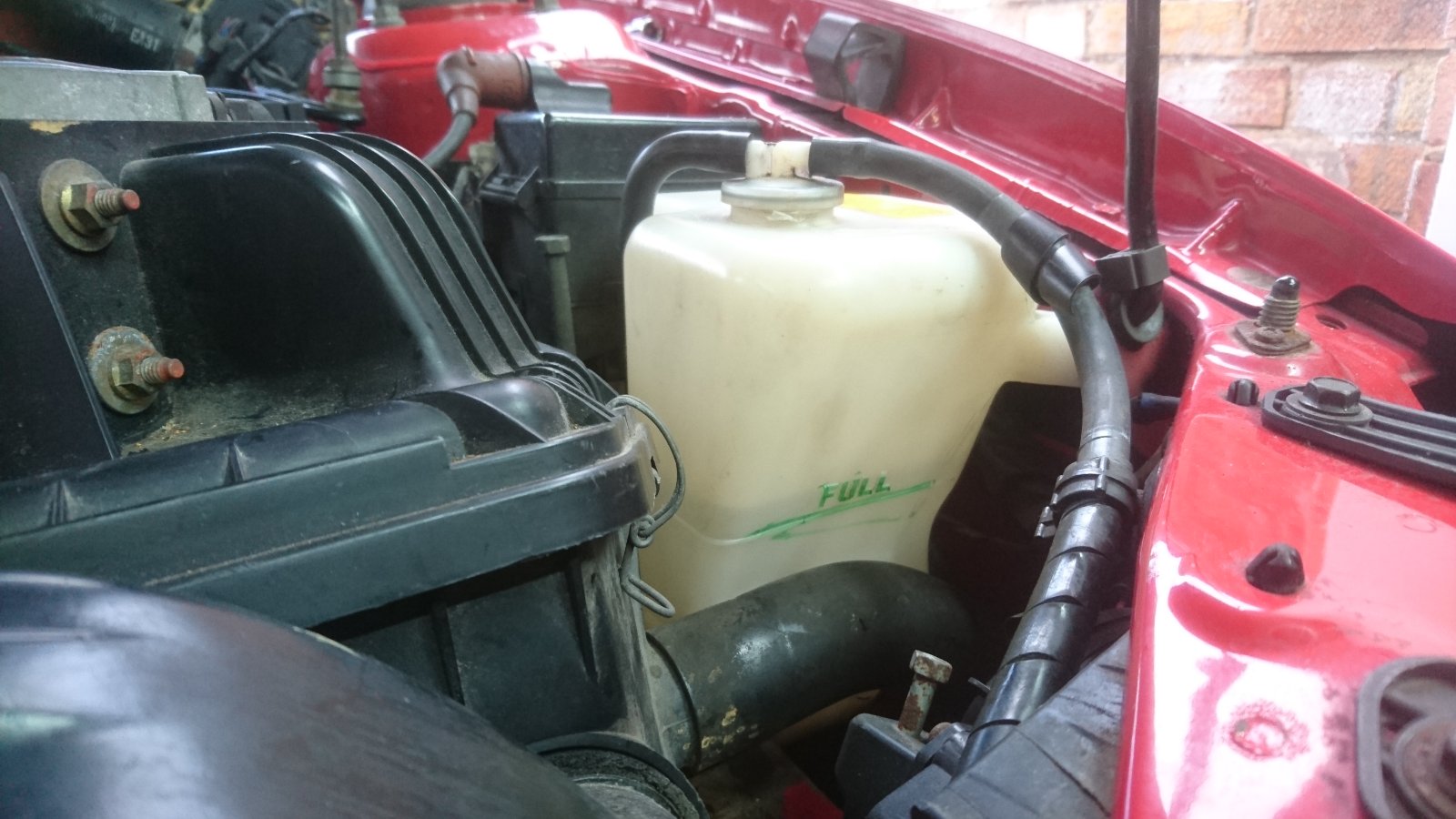

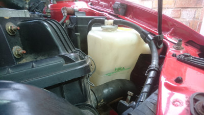

Much better!

Is that a toothbrush that has been heated and bent 90degrees and attached to a wooden spoon? Or am I seeing things
Champion of Where's CitroJim
- Posts: 21209
- x 8124
Re: DIY Car Maintenance with function over finesse!!
No you are not Ryan, That's exactly what it is!! Works very well too
