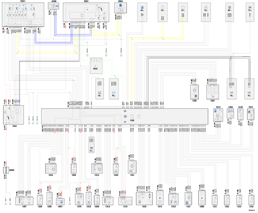

  • The Schematic or Principle Diagram.

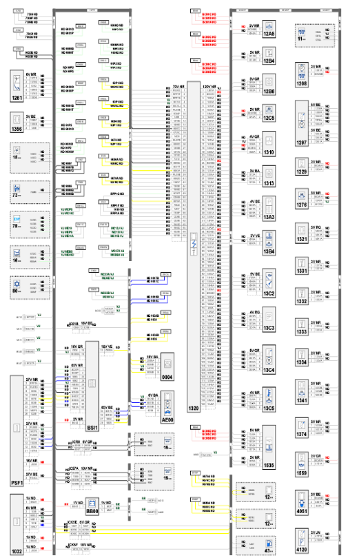

  • The Wiring Diagram

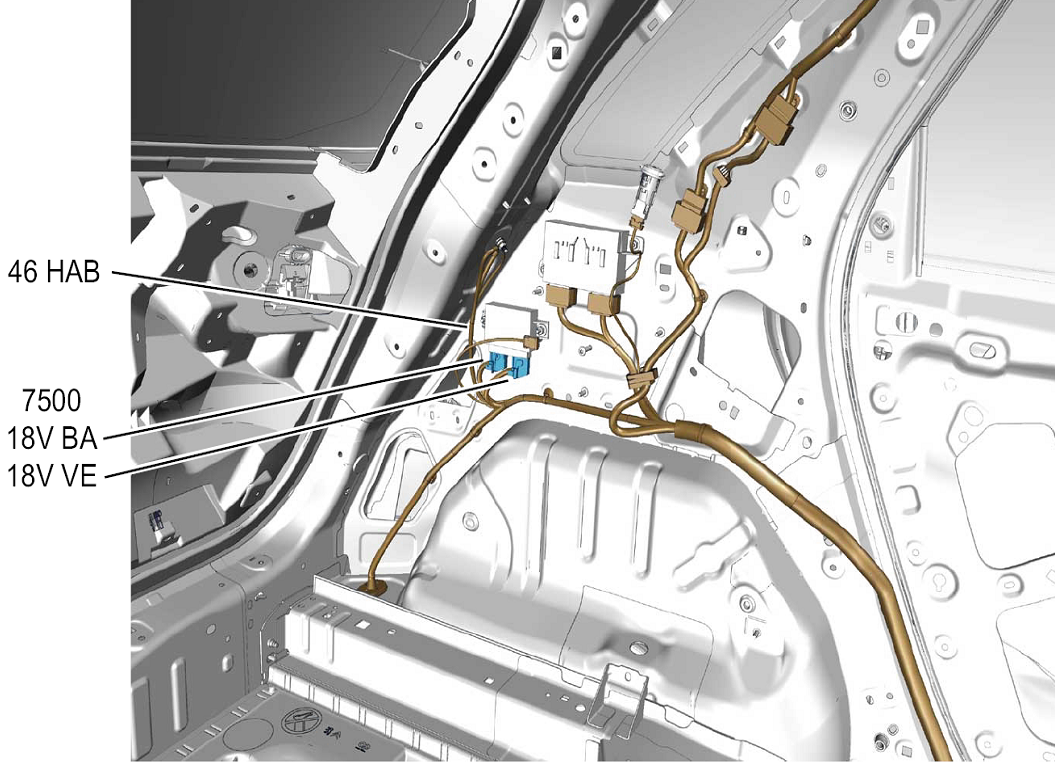

  • The Installation Diagram
  • Supplies ( + and -)
  • Components (with references, function symbols and internal electro-*#*mechanical details, except for electronics)
  • Connector sockets on components
  • Earth points
  • Wire lines (with reference)
Wiring Diagram
  • Supplies (+ and -)
  • Components (with references, function symbols, without internal electro-mechanical details)
  • Interconnections (connectors with references)
  • Earth points (with reference)
  • Splices (with reference)
  • Harnesses (with reference)
  • Wire references
  • Total or partial ghosted view of the vehicle (in perspective)
  • Components (position, reference)
  • Interconnections (position, reference)
  • Splices (position, reference)
  • Earth points (position, reference)
  • Harness (reference, run)
  • Partition passages
