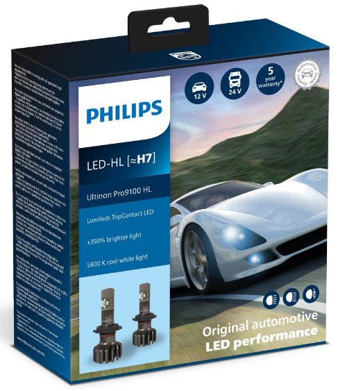

So my question is, has someone tried putting LEDs in this car's headlamps? The bulbs that I have in mind are road-legal Philips Ultinon which by every review seem to be a sizeable ugrade from even the brighest halogens with a very good cut-off line. My only issue that is stopping me from ordering them right away is that I do not know if LEDs even fit in this type of light, taking in consideration the not-so-common type of connector for the low beams (maybe the high beams too, luckily I still haven't had the need to change them). I do not really want to experiment with these expensive LED bulbs to buy a set only to find out that they are not compatible with my lights.
Has anyone had any luck with putting LEDs in their halogen illuminating C5 X7s?

This is my exact worry. I have seen some random pictures and videos of this headlamp with LED bulbs, but none of them explain how they’ve managed to install them. The compatibility list of Phillips doesn’t mention this car if it is compatible or not, nor the Peugeot 508 (although idk if it’s the same headlight). They do sell a lot of adapters for all kinds of headlight, but how can I know which adapter is right for me - spend 100 euro on a bunch of plastic that only (hopefully) only 10 euro worth of it is going to be used.Paul-R wrote: 06 Dec 2023, 09:42 On a purely practical note, I have been struggling to see how I could fit and retain an LED bulb (an Ultinon 9000 H7) in a halogen headlamp shell. The standard halogen H7 bulb is held in place by a plastic plug which combines being both a electrical plug and the retainer for the bulb. There is physically no space for the Ultinon 9000 in this plug unless you're prepared to modify it radically which I am not. I have tried many different retainers for an H7 bulb but not fit securely in the headlamp shell.
My hope was someone that has installed LED aftermarket bulbs in their halogen C5 to shed some light how have they managed to do so with this type of uncommon connector which is also the retaining clip.

Thank you for your response, but I disagree to some extent as, these are approved as I saw in their website as well as a document that they have deep in their site which has the approval for one of their series (I forgot which one right now) https://www.philips.com/c-e/au/road-leg ... d.amp.html . As well as especially in Bulgaria, where I am from, they have the approval and I can post the document but it’s in Bulgarian, so not much point haha. I’ve also asked my insurance company and they said they’re OK.
But that still leaves the issue with installation which currently I don’t see how it will work without some modification of the clip.

Here's some more info on those Philips Ultinon:Around 66% of motorists say they often struggle to tell whether the beam is on full or dipped.
Others said they’ve been forced to change the way they drive with 21% now relying on their wing mirrors more to avoid being dazzled.
Mr Williams added: “While regulations specify that all types of dipped headlights must fall between a maximum and minimum luminosity the night-time driving experience of motorists of all ages is very different with many saying dipped beams of some modern vehicles are too bright.”
The UK government, through its work at the United Nations, has secured support for a review into headlight requirements.
Preliminary proposals were put forward in 2017, with more progress expected for this year.
Why are aftermarket LED bulbs still on sale?
Because drivers are unclear on their legality and still willing to buy them, based on promises of superior illumination of the road.
One example that recently came to our attention concerned the new Philips Ultinon Pro9100 aftermarket LED bulb, which promises 350% greater illumination than the legal requirement for halogen bulbs.
The product packaging showing the bulb being used in a road car, and the bumf saying things like, “Their optimal light spectrum makes road signs more visible,” and “The perfect positioning of the LED chips in Philips Ultinon Pro9100 bulbs delivers light exactly where drivers need it, on the road without dazzling oncoming vehicles.”
However, buried down at the bottom of the press release from the bulb retailer it says:
“The Philips Ultinon Pro9100 LED retrofit bulbs are non-ECE homologated for public roads and should be used off-road only. Drivers must comply with applicable local legal requirements.”
Regardless of the fact that aftermarket LED headlight bulbs are not legal for use on the road in the UK, motorists are still using them, companies are still supplying them and drivers without them are still suffering as a result of the dangerous levels of glare they can often produce.

I am wondering if their "compatibility" is whether their bulbs with the bigger heat sinks fit inside the headlight housing? In another discussion about Headlights, someone has given me the nudge towards Auxbeam Q30 LED "bulbs" which are packaged to fit as normal, but pack a hell of a punch. https://auxbeam.com/collections/q30-ser ... 7-gd002076

They're a fair bit bluer than the Ultinons, 6500K against 5800K. I find the 5800K to be perfect.
