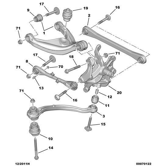

maybe this helps you visualise the rear suspension.... YES, bad/split bushes will have a horrible effect on the suspension.
He could be talking about part 2 or 8....or both...

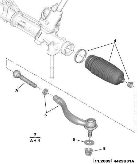

Steering....I assume Part 5

Thanks, this is useful. I have ordered a set of front drop links from a local specialist parts importer in Australia which seem simple enough to replace myself.
I know these are a common issue and figure that is likely to be what is causing the slight play in steering rack ends rather than the tie rod ends themselves. It could also be the lower front suspension ball joint (FRIP)?
I couldn't quite work out whether the term "rear radius rod" used refers to the rear suspension link (part 8 above) or the rear suspension arm (part 2). I figured it was more likely to be the rear suspension link. I haven't yet been able to find replacement a set of these in Australia but am still looking.
I am going to call up another allegedly reputable mechanic (recommended to me) to discuss getting the rear suspension links replaced as well as a thorough check of other commonly worn out bushes and the tie rod ends. I don't trust myself to do that job as it looks a little more complicated, particularly with the suspension auto adjustment bolts.

Yes, cannot be sure but 8 was my suspicion.....get a long bar in there and lever on them a bit, that should make it obvious.
