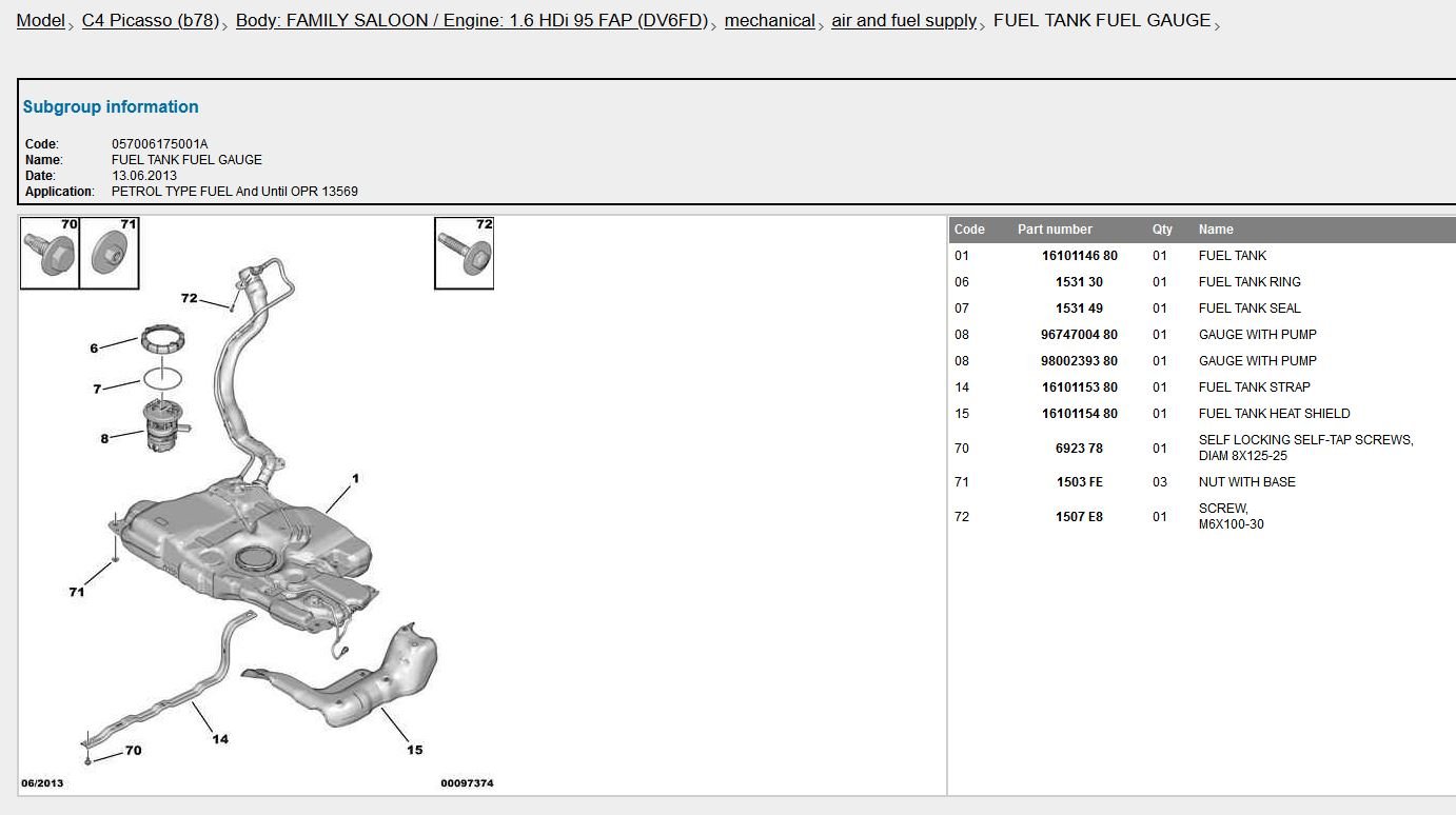

Some do have a pump and some just have a gauge, so really better to provide your VIN so we know what model, year engine, and whether you do or don't have an in tank pump to save providing irrelevant advice.richarda wrote: 28 Nov 2023, 14:04 Many thanks for all the comments and ideas.
I think this car, 2011 c4 GP, doesnt have access to the fuel tank under the rear seats... So can't go that way. I also think there is no in tank pump, we haven't started it, so think anything forward of fuel tank should still be diesel. Might try a small gauge siphon tube down the refill pipe. Otherwise maybe a pump connected to the pipe that feeds the fuel filter. I have a lawn mower to use the petrol in after...

even with just a sender the hole in the tank is the same is it not ?.....and all HDI's will have a lift pump in the tank I think
as in this
as in this
