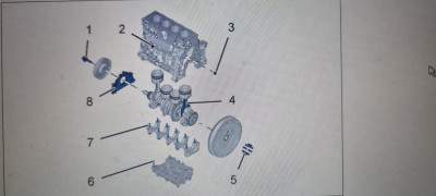

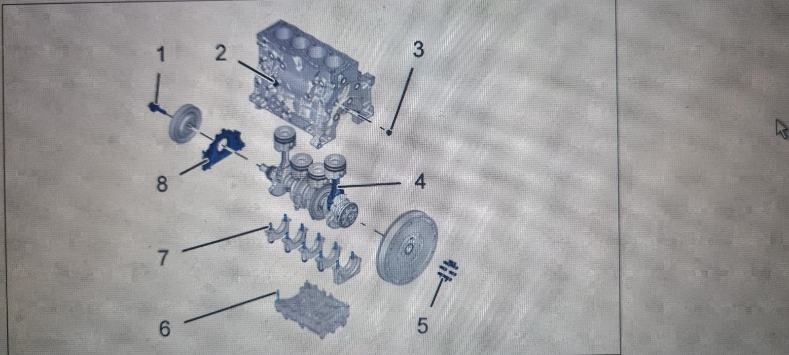

Re: Peugeot 508 2.0 2017 timing belt torque specs
Unread post by trollkarlen »
For the crank drive pulley(1) and for same engine(DW10FC) but older model of 508 I saw that it should be replaced if the slackening torq exceedes 20 m.daN.
Tightening torq
Pre-tighten to 7 daNm
Angular tighten to 100°
