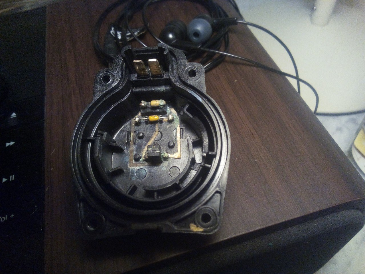

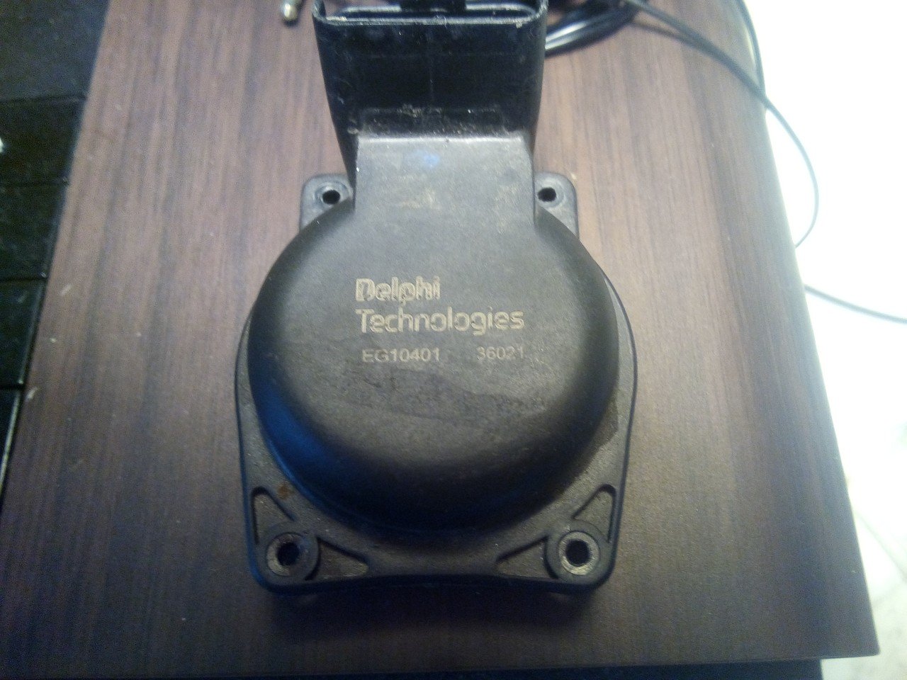

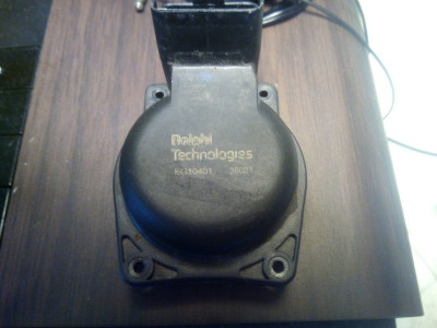

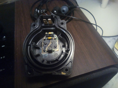

Got down to the possibility of a corrosion short circuit in the EGR valve cap - as attached - doesn't look that bad. I'll replace it, but this a branded replacement EGR only fitted last year which doesn't inspire much confidence ................

Does look like it's seen better days!
What brand was it as a matter if interest?
ianmcc
- Posts: 21
- Joined: 27 Sep 2021, 16:38
- x 1
Re: 308SW fault P1586 ?
From a NAPA Motor Factor - Delphi it says - £150, or so .........GiveMeABreak wrote: 08 Nov 2023, 10:35 Does look like it's seen better days!
