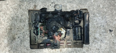

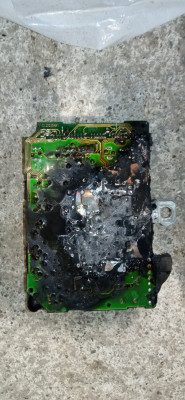

my fathers citroen c2 1.4 kfv 2005 recently had a BSM that shorted out causing it to melt itself and damage some parts of the wires and connectors.
After fitting new cables connectors and BSM the car has a crank no start. I am wondering could it have damaged the ECU or the BSI too? I took apart the BSI and it does not look burned anywhere.

WOW! That BSM is toast! Any idea what happened? My guess is the battery connection at the BSM was loose and generated enough heat to set the PCB's on fire.
Ok, so it looks like a MK1 BSM. Can you poll the engine ECU? My guess is no power or incomplete power to the engine ECU. The BSM is only controlling power to the engine ECU. The engine ECU grounds are external to the BSM.
