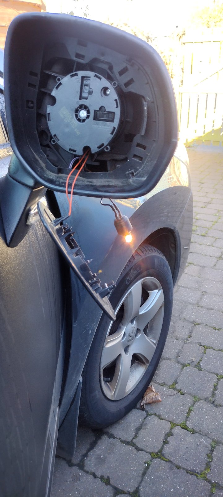

Just pop the mirror out, and then the heater connectors are exposed and you can just connect to them as required. TBH I wouldn't bother, the PSA system with Eolys is so effective that it rarely gives trouble until higher mileages - and it will flag a warning if the regen has been stopped too many times.
Pic of the mirror on my 3008 partially dismantled. Mine had been fiddled with, and the light in the mirror was effectively being the warning lamp. Not that I could see it...
