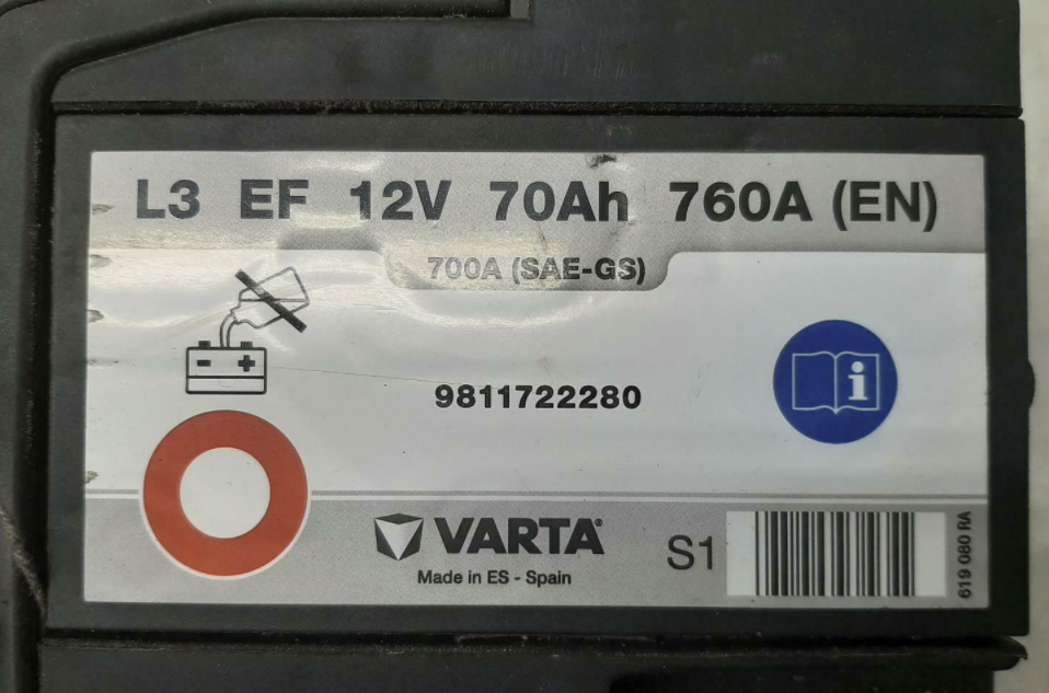

This is an EFB Battery (or to be more precise this is what it should be fitted with) L3 760A/70AH, but certainly an EFB battery type. If you're looking to replace it a YUASA battery are generally well regarded here.

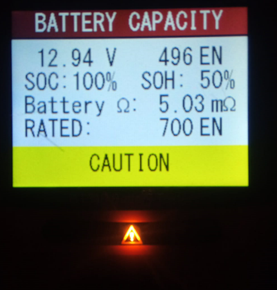

I ran battery tests on it and got the following results
using the following battery tester
https://www.amazon.co.uk/Car-Battery-Te ... B0BLNF9GVC
The video of the tests I have done is here I filmed them
https://www.kapwing.com/videos/65468f50dade36dc79f3536d
Have I run them correctly?
1) Is a LSI battery the same as a EFB I can't get an answer via searching online
2) Does the battery have a reasonable state of health for a new battery?
3) Should its state of health be close to 100%?
4) Does it need further slow charging?
5) I have this charger
https://www.amazon.co.uk/DSGKUU-Automat ... 09B6ND8PP/
6) I had the battery fitted yesterday afternoon and the stop-start was not working after it was fitted so have left it overnight
does the car need a good run or (4) above?
7) Have i got the wrong battery tester and should I return it a get this instead?
https://www.amazon.co.uk/gp/product/B08H8DT2MF/

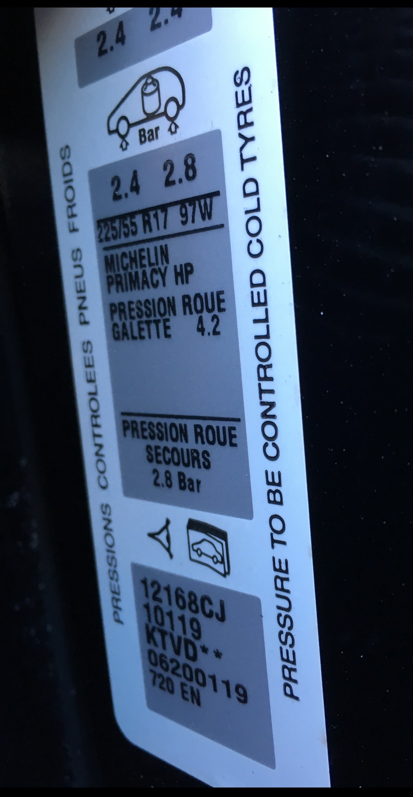

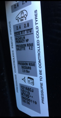

As a side note, depending on the age some PSA labels with the tyre pressures & RP number etc.
The one below is off my old C5 the bottom row shows the cranking amps of the original battery.
If it is AGM or EF this is printed next to the cranking amps. This one was just a regular flooded battery so it doesn’t say.
This one was a 720 CCA (EN)

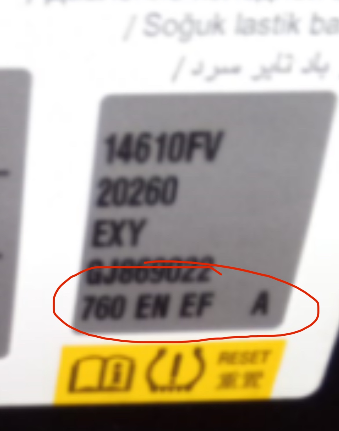

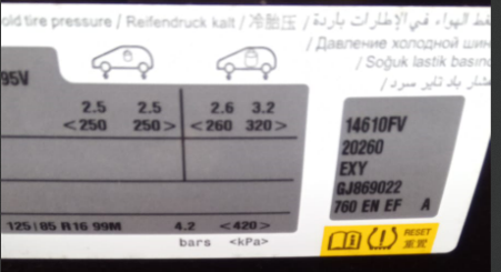

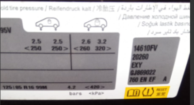

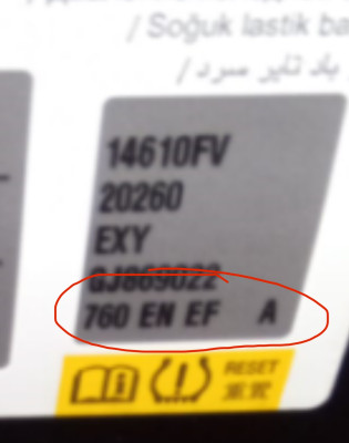

I have the following label
and got the following test data on this video here
Thank you
wheeler
Posts: 7926
Joined: 21 Sep 2002, 19:07
x 1056
Re: Battery replacement for Citroen C4 Grand Picasso 1.6 BlueHDI 120 Diesel (series 2015-2018)
Unread post by wheeler »
So according to the label your battery CCA is 760A (EN) and its Enhanced Flooded.

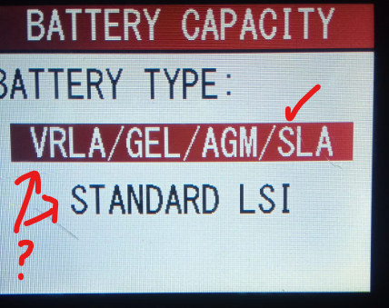

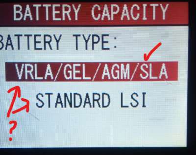

It does not give me the option of an EFB in the menu and I was wondering if one of the other options
match the EFB?
eg
my worry being
as per the video above
I'm not sure I am choosing the right menu maybe it should be LSI?
Or whether the battery tester can even test for EFB batteries as per the video?
and whether I should just get a different battery tester eg Toptom tester and use that as it gives EFB as a menu choice for testing?
The Yuasa battery I've had installed
has this spec
CCA (EN) 700 A
which I inputted into the test parameters in the video above

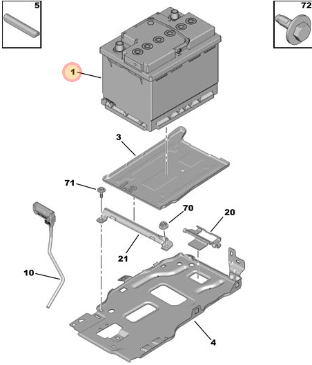

mmatin wrote: 05 Nov 2023, 16:32
GiveMeABreak wrote: 01 Nov 2023, 13:57 If you pop your VIN up I can see what you are supposed to have. Please post your VIN in full without spaces - it will be automatically masked from public view after submitting your post & will only be visible to staff.
Hi Marc,
Can you check for VIN VF7**************[VIN obfuscated, can be read by forum staff] what battery is installed.
Thanks!
Mario
Hi Mario
Battery type is AGM
(1) 12V Battery
Original, (L3-70AH-760A-AGM) part: 9678006180, £303.91
Cheaper Alternative, part: 1620012780, £215.15
