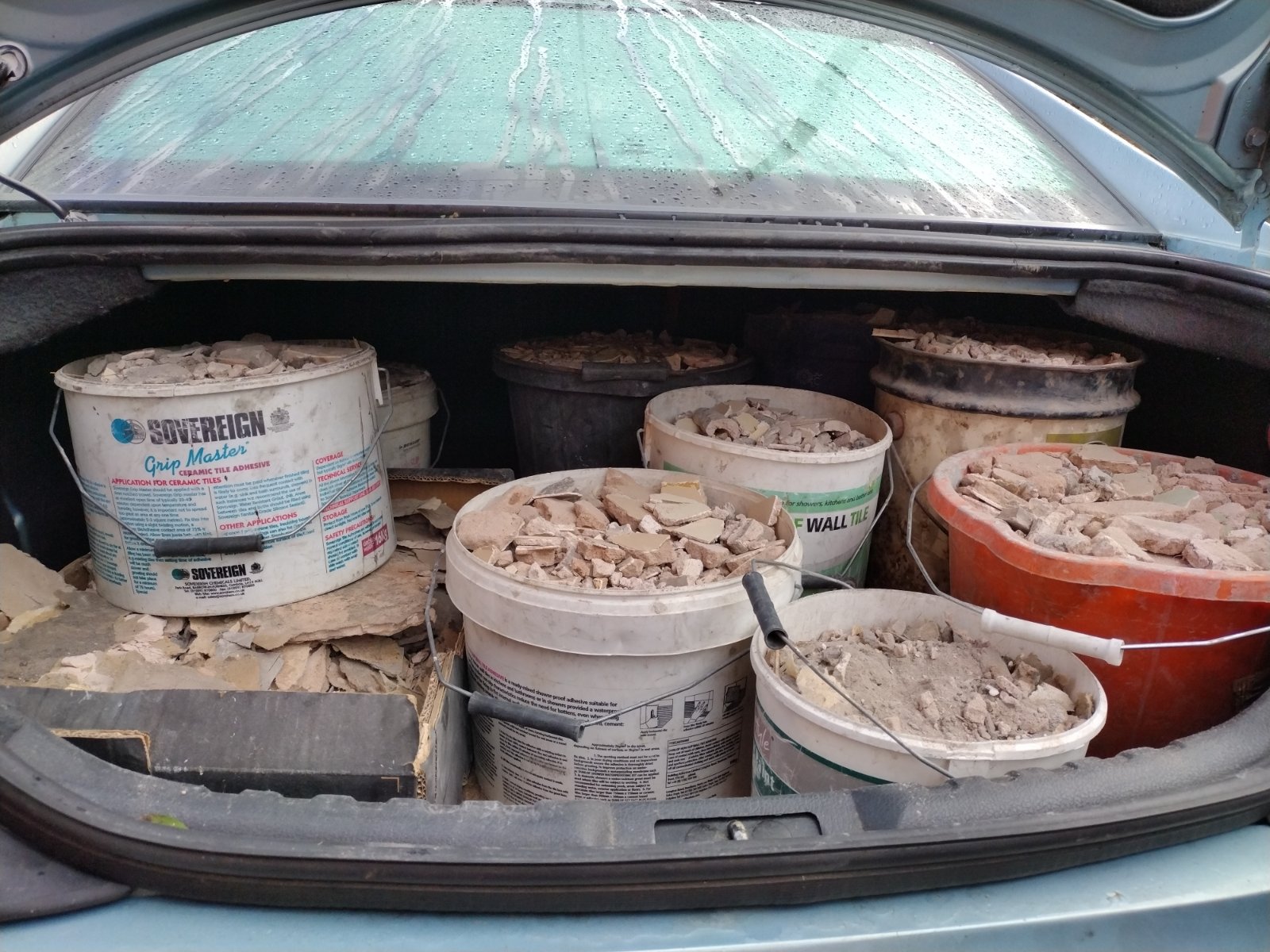

The Coupe's Tardis-like boot put to good use this morning, tip as usual!
Amazing all these buckets fit in the boot
With the green washing up bowl being the only thing stacked on something else

When I take a payload to the tip Matt, I always think just how much I'm saving on skip hire... You must have saved a fortune!

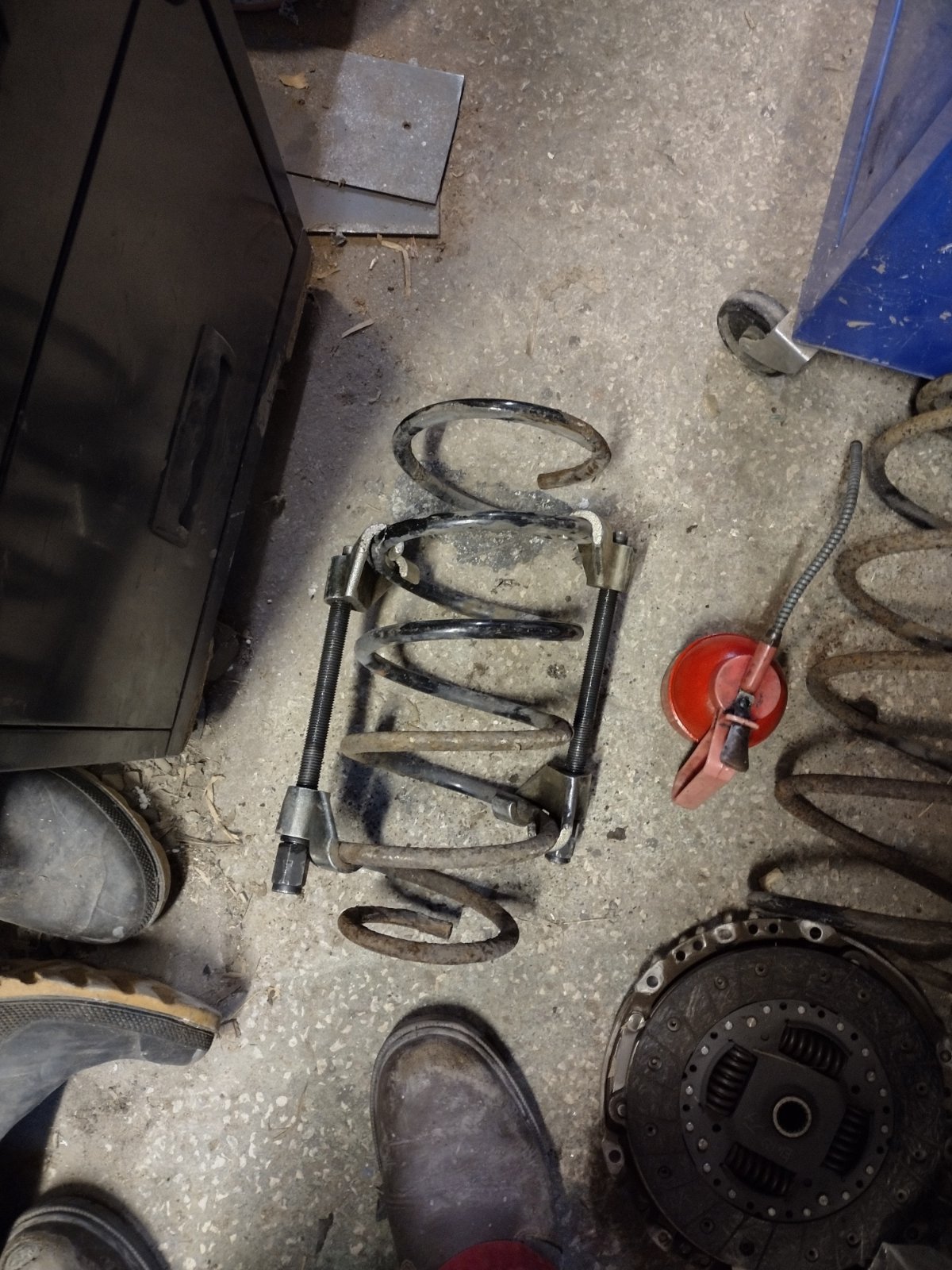

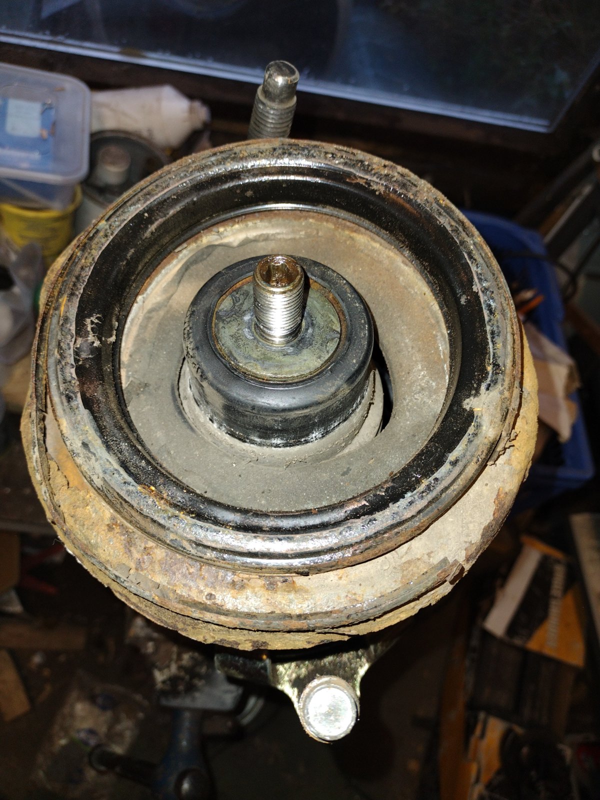

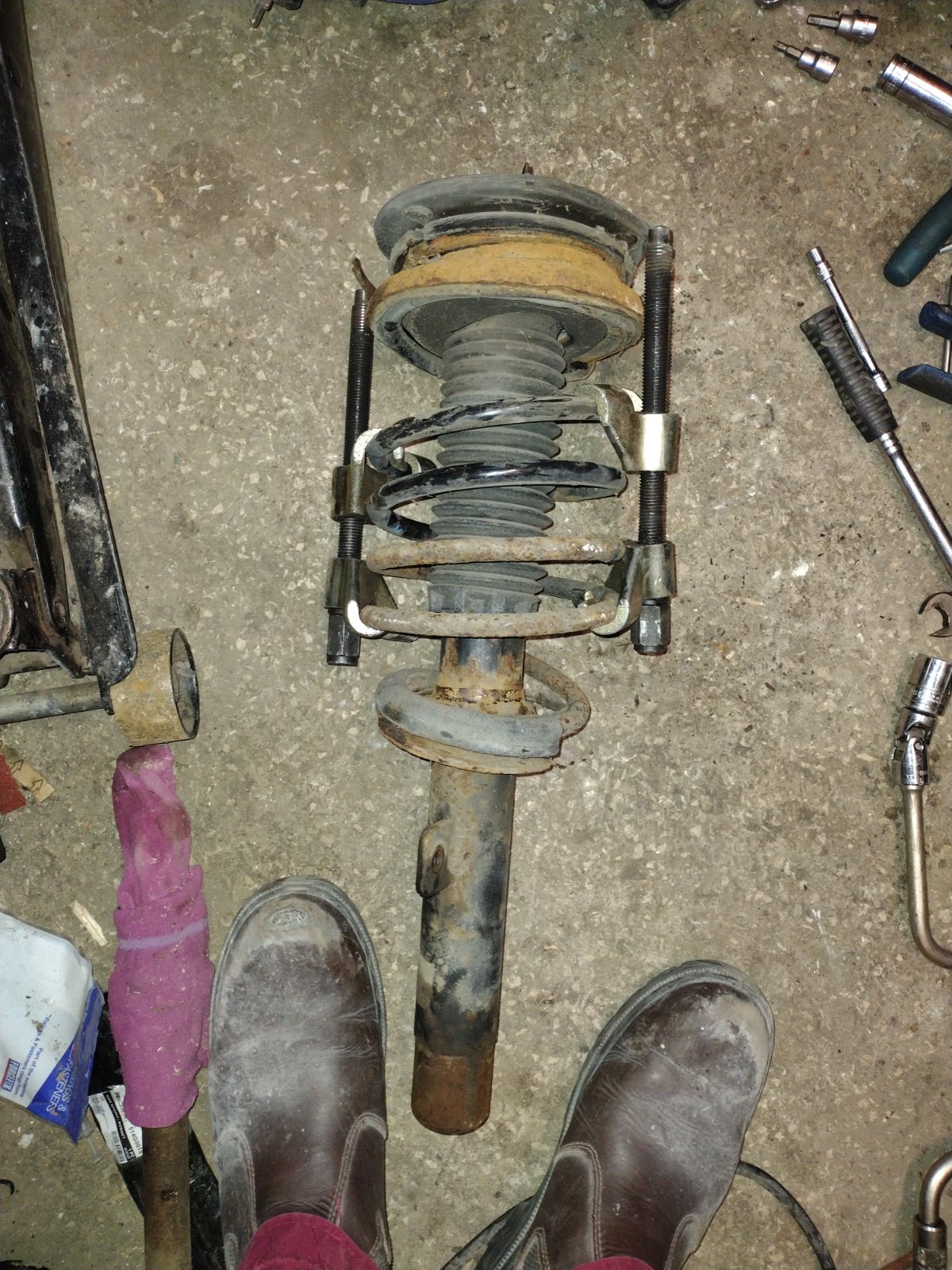

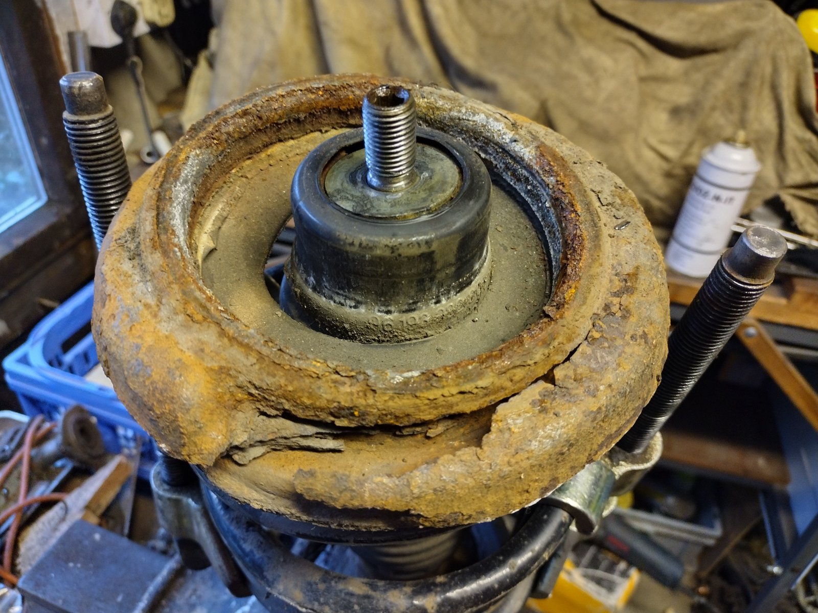

MattBLancs wrote: 31 Oct 2023, 21:32 Set of impact Allen bits bought:
The "US Pro" Allen bits put to use, the damper nut came undone without incident, thankfully. Very tight though, much tighter than other side.
Coupe (front left) compressed
Strut coming apart
Strut coming apart
Strut top bearing, external corrosion but internal fine and smooth running (have new anyway)
Fair to say that's had it!

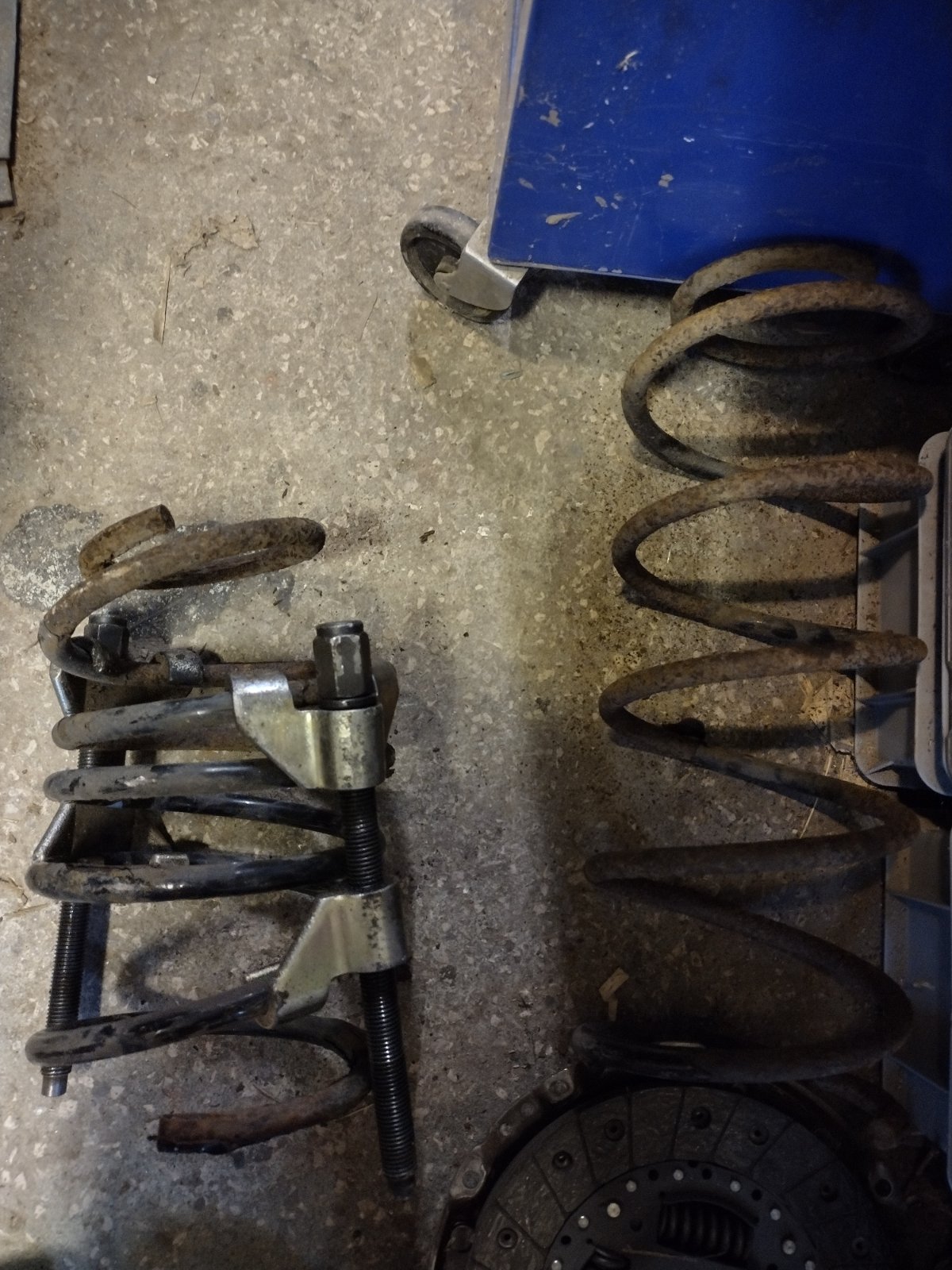

Quite how much compression required to remove from strut Vs the uncompressed length!
Which leaves me with a conundrum:
Spring compressors fully extended - but spring not yet relaxed!
I think there's another set of compressors in the garage somewhere, will add a bit of tension then hopefully release the current set!
