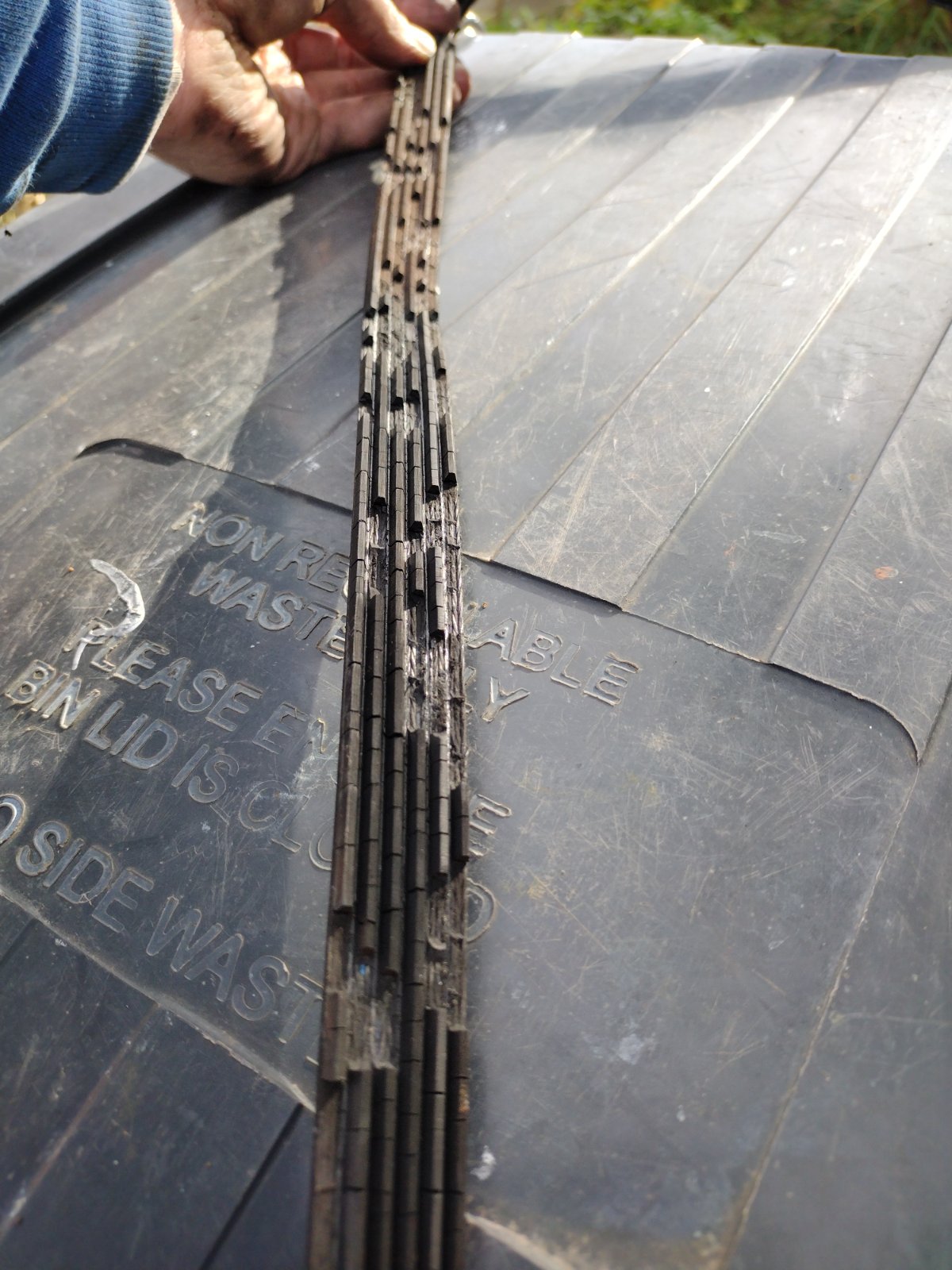

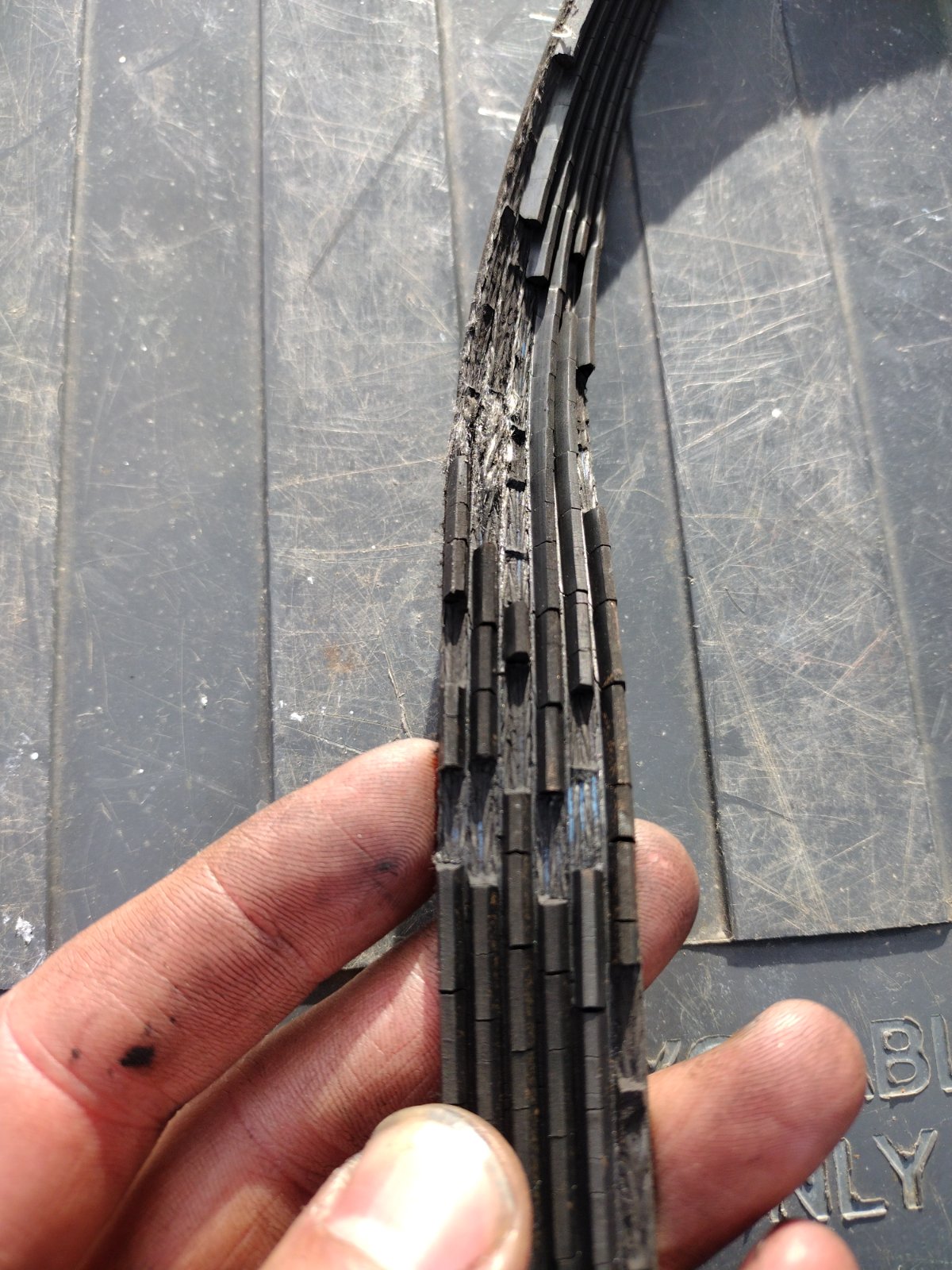

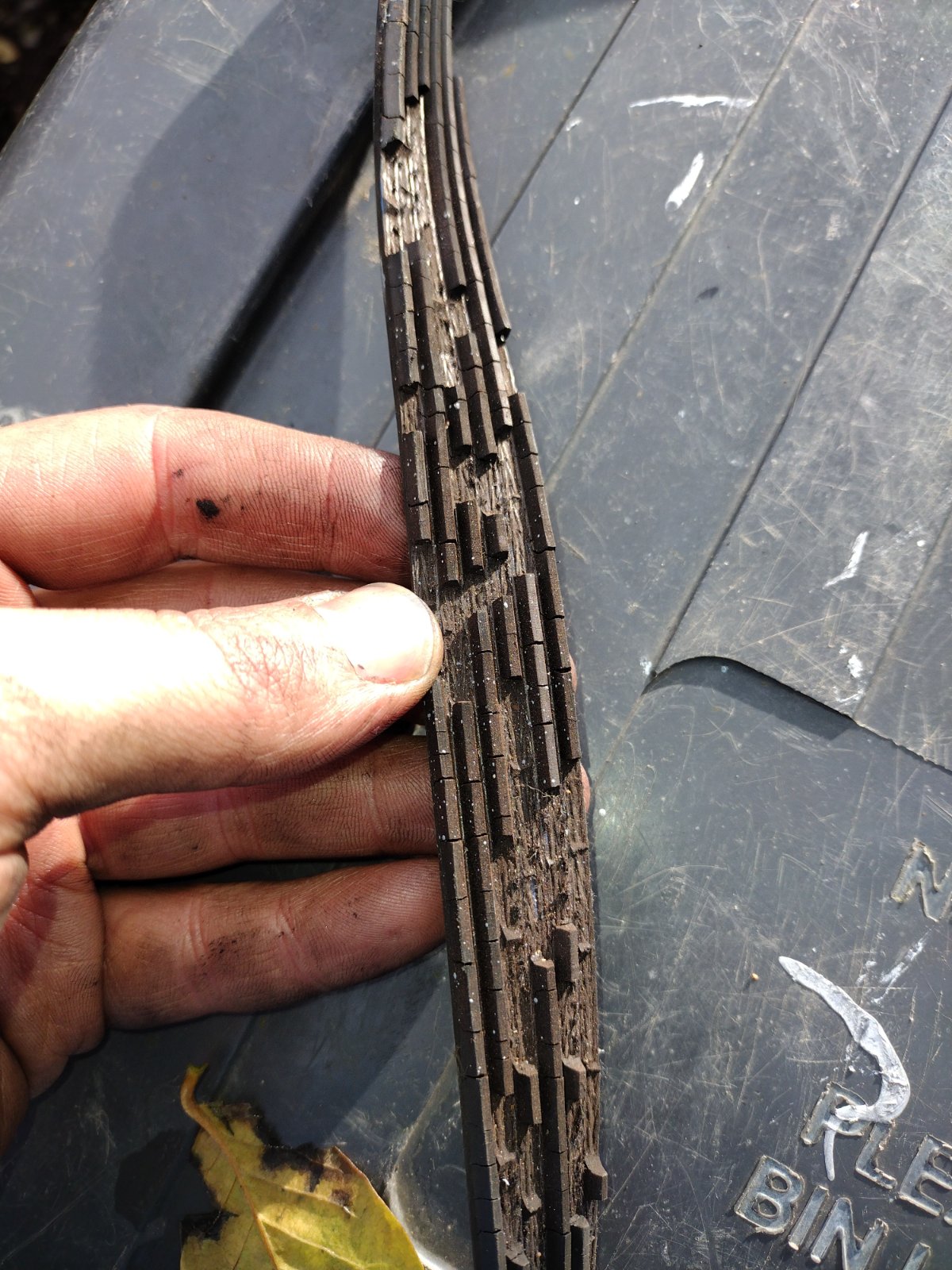

MattBLancs wrote: 25 Oct 2023, 11:30 the HDi Coupe's auxiliary belt is A LOT more tired than it appears from above!
6pk 1738 says the parts Asia site. For info: micro Vee belt, 6pk = 6 grooves on the pulleys
Amazed how expensive the belts seem to be now! I'm sure I've paid say £5 - £7 or so previously, Eurocarparts is asking £23 for example!?!?
Kept digging! 6pk1738 belt, bought £7.75 including delivery - that's more like it 😁

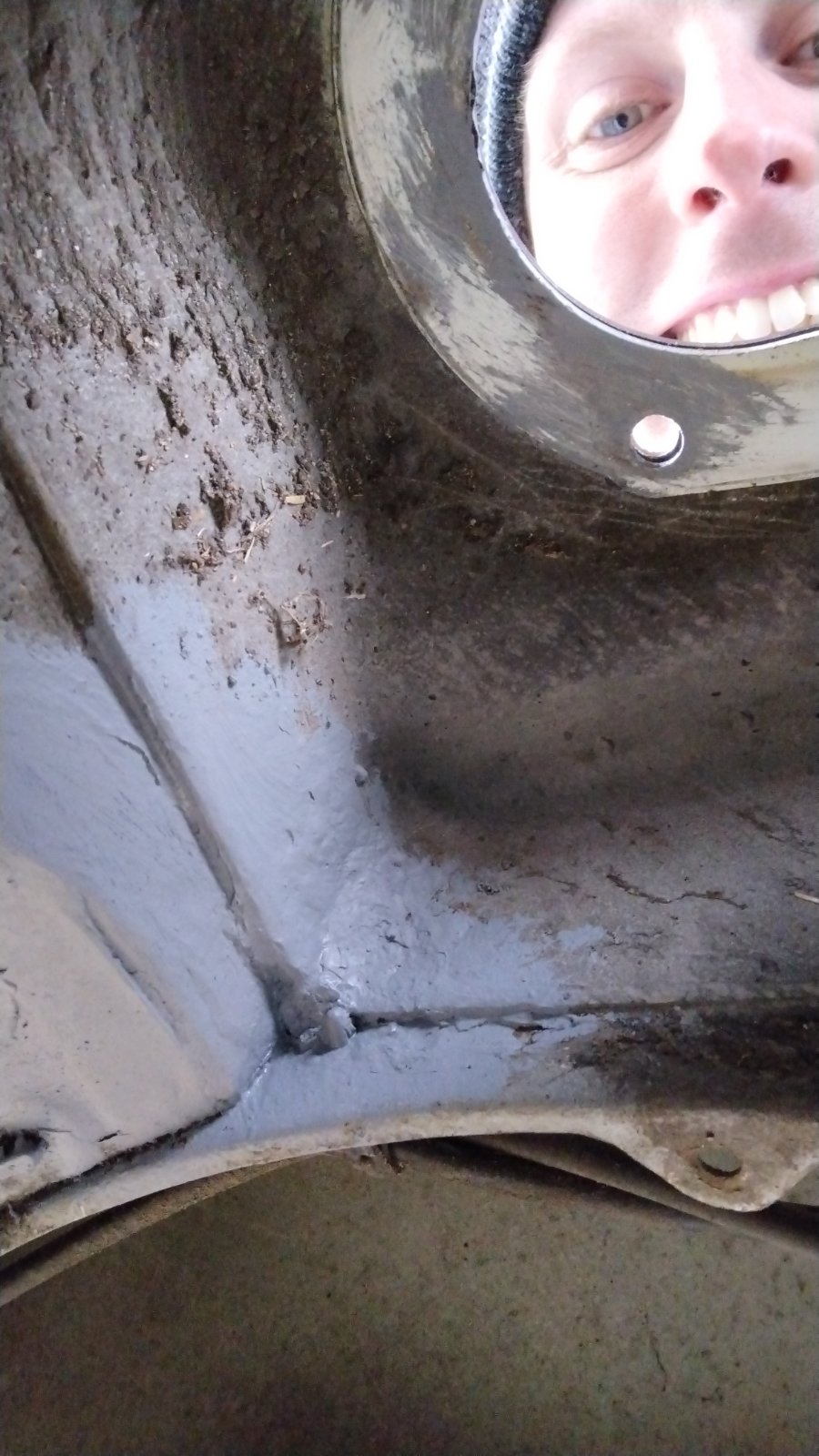

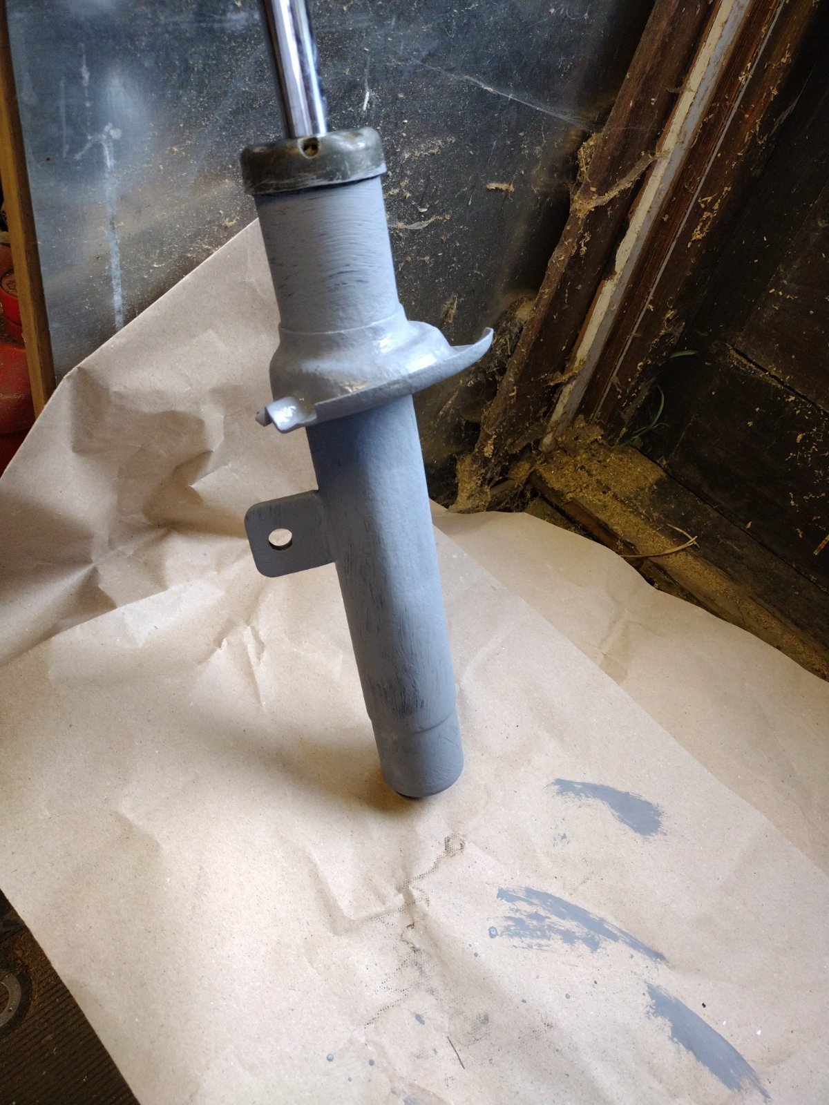

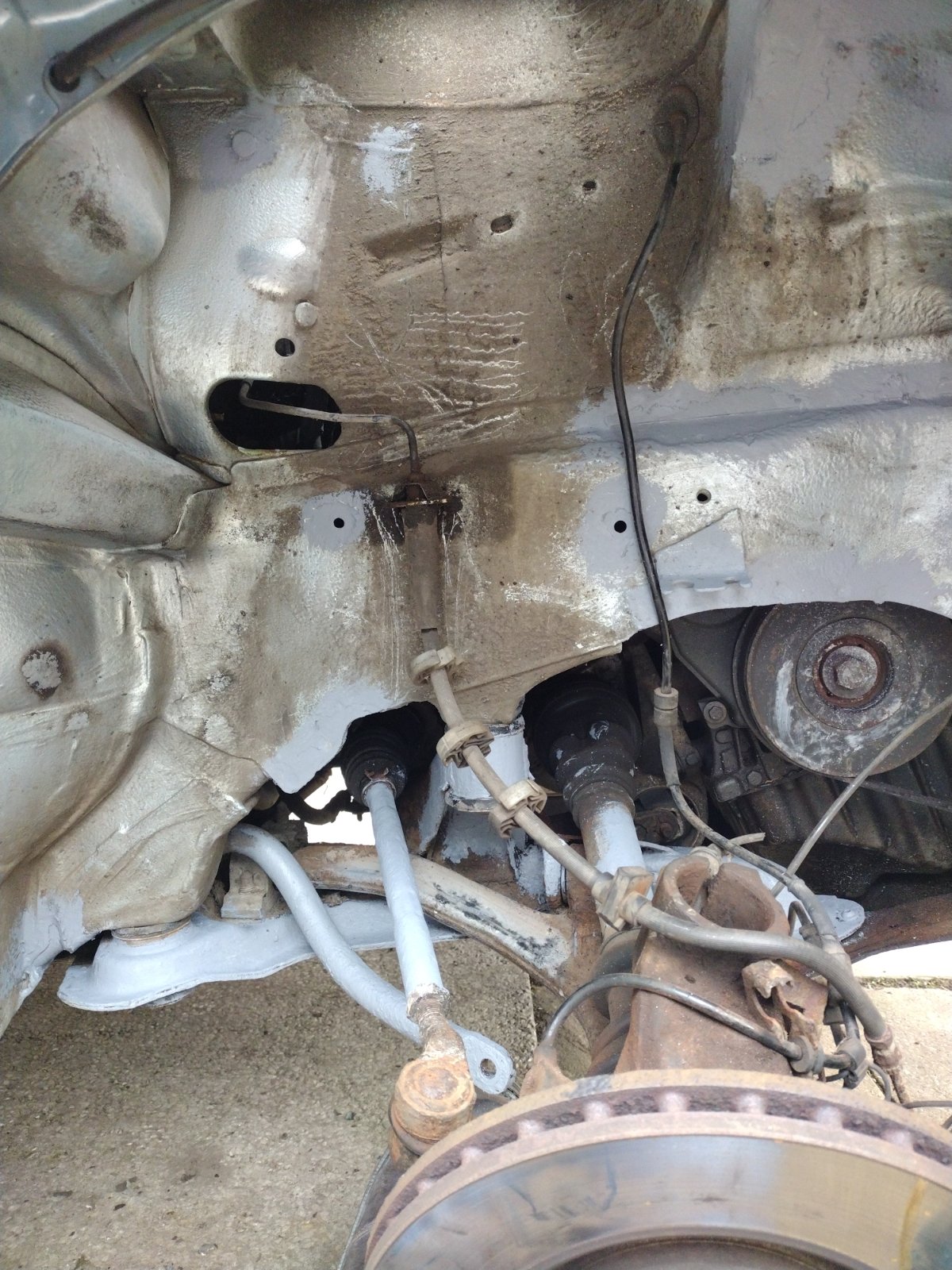

Damper primed.
Rather chilly (10°C) but hopefully will dry ok for a quick brush on black top coat later. Various bits on the underside of the wheel arch also treated too
This is worst spot, thankfully cleaned up ok. Now also repainted:

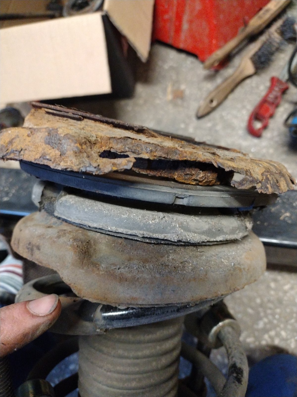

Comparison:

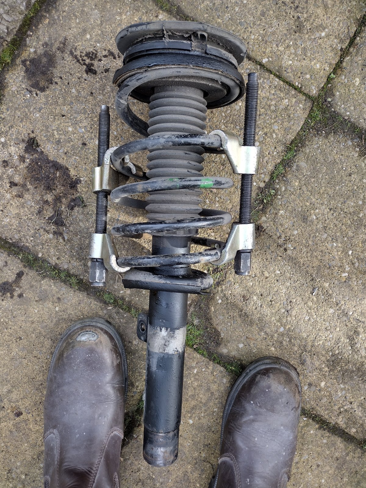

Top, rusty disintegrated upper spring carrier from 2002 HDi Coupe. About 158,000 miles
Lower, as found spring carrier from 2000 2.0 Coupe. About 169,000 miles.
Rusty top (balanced in top of complete strut from 2000 Coupe)
Am going to put the (originally AL4 equipped but all alloy engine EW10J4) strut complete onto the HDi Coupe in the short term. Will rebuild / repaint the HDi struts and new springs. Different part numbers but hopefully spring rates not that far apart (will see soon enough!)

Gosh Matt, those upper spring carriers were approaching dangerous with all that corrosion... The worry is they escape MoT scrutiny as they cannot be readily seen...
A bit like Xantia/XM strut tops... They can get very bad before the MoT man might notice...

CitroJim wrote: 28 Oct 2023, 19:08 Gosh Matt, those upper spring carriers were approaching dangerous with all that corrosion... The worry is they escape MoT scrutiny as they cannot be readily seen...
Yes very much hidden when on the car, you can imagine quite how much my heart sunk when I pulled the strut down our the arch and saw that!!
Springs have had an advisory for corrosion for a couple of years, that's why I'm changing them, but the upper seat being so far gone was a big shock.
Agree not far off catastrophic collapse I'd guess.

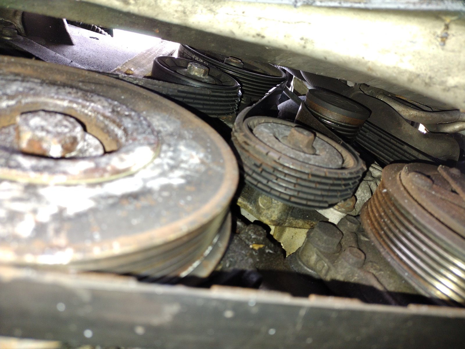

Knackered auxiliary belt off. A ten millimetre longer belt (1750 Vs 1740, actually Vs supposed correct length of 1738!) Seems very tight to get on.
Belt routing (memory jogger!)

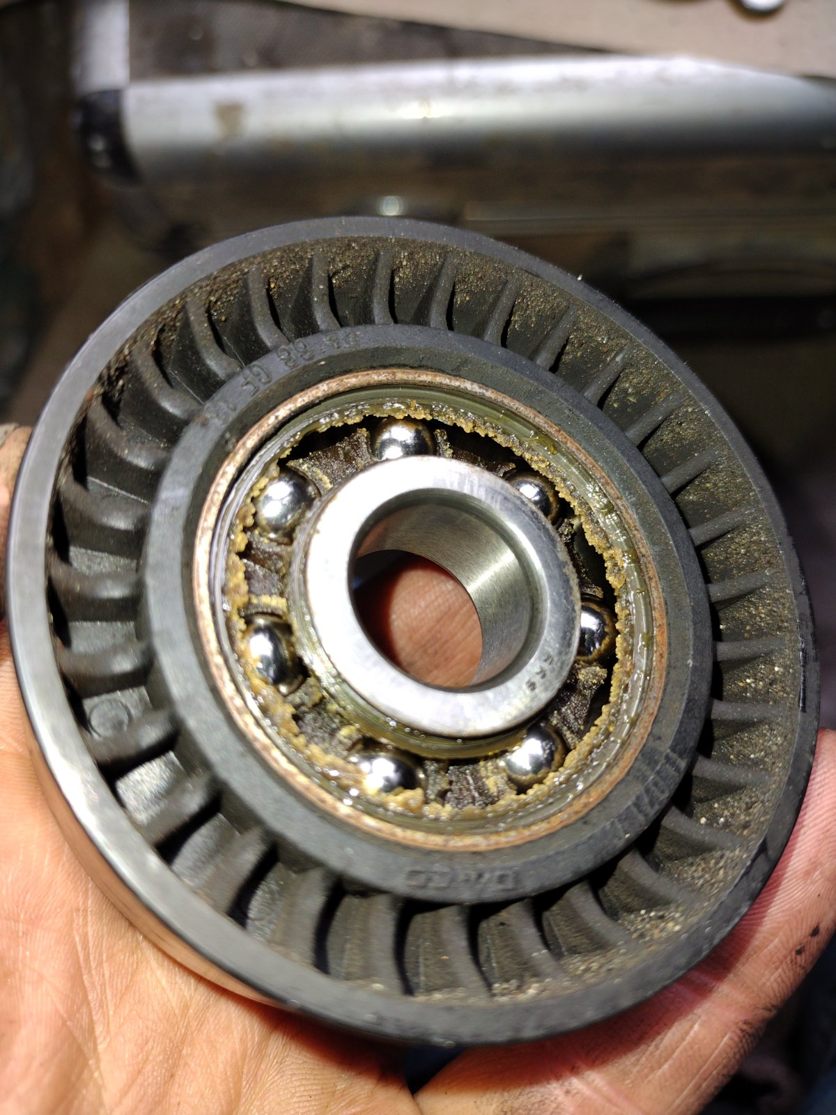

Have taken idler pulley off (as can be easier to install new belt with the pulley) and though no play or roughness have popped the dust seals off and will replace the "cheese" that once was grease!
Old grease
Old grease
2.0 coupe strut given quick wire brush and slap some paint on
